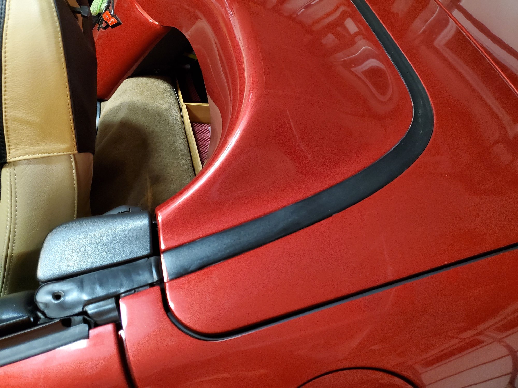

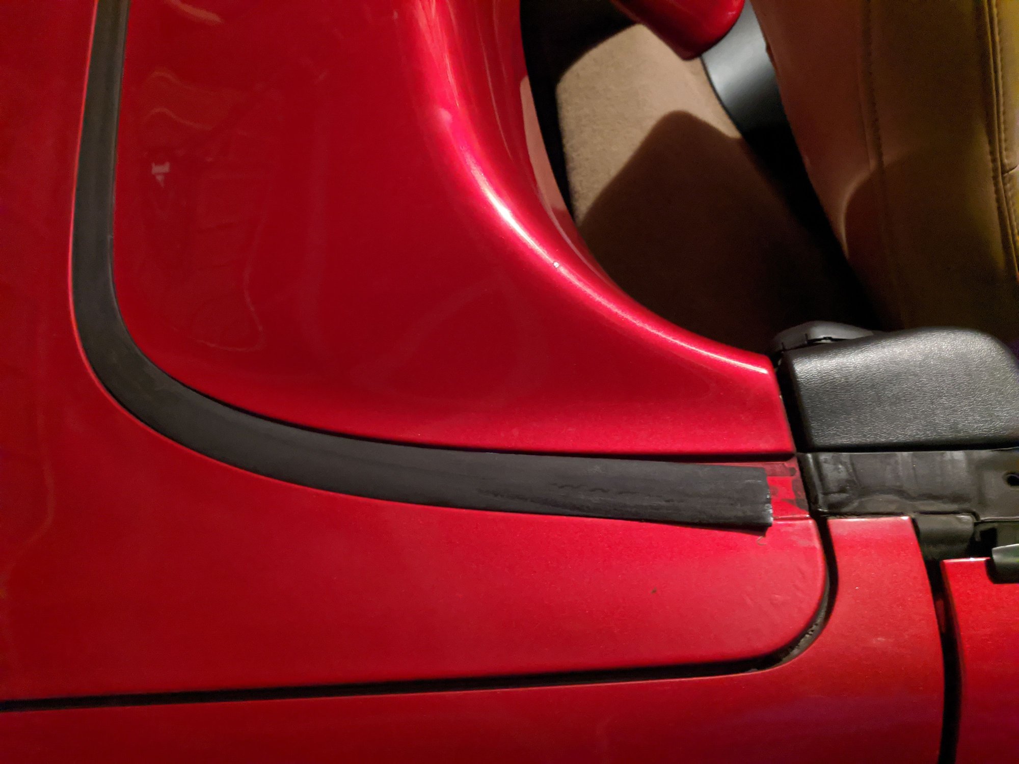

Originally Posted by gnt
This shows the piece I'm looking for as well as the issue. As you can see, in addition to not being well attached the strip no longer goes all the way to the edge of the panel.
Thanks for pics. I have a vert too and I’m always looking to learn.
Do you think it’s short because it was stretched upon initial installation?
I'll find out for sure when I get the new one. However. it has the same issue on both sides. I noticed that it had "shrunk" long before it came completely unattached. The strip itself is pretty dried out, so I think that may be the reason I'll have more pics once I've installed the new one.
