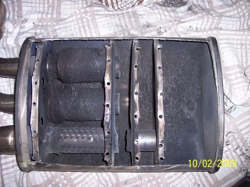

Thanks for the ideas. I'm pretty positive it's not a baffle, I can hit the bottom of the muffler and hear it bounce around freely. I already tried blowing backwards thru the tailpipes with the exhaust disconnected from the x pipe without any luck. After that I searched "inside of C5 Z06 muffler" and was shocked to see that someone had actually dissected one before lol. It's nice being able to find almost any info on the cars.
Anyways, my next idea is to connect some 1 ¼ inch sump pump hose flex hose I have to my vacuum and feed it into the flange end of the muffler and hope I can get it all the way into the the empty end of the muffler which is where I can hear the piece bouncing around at. The 2.5" inlet seems to shrink down considerably inside the muffler and that's why I think the 1 ¼ hose will be the best option.

Originally Posted by tabbruzz
I would remove the catback from the car and shake the hell out of it...You may get lucky
If you look at the picture in my last comment, you'll see it would be pretty much impossible to shake it out

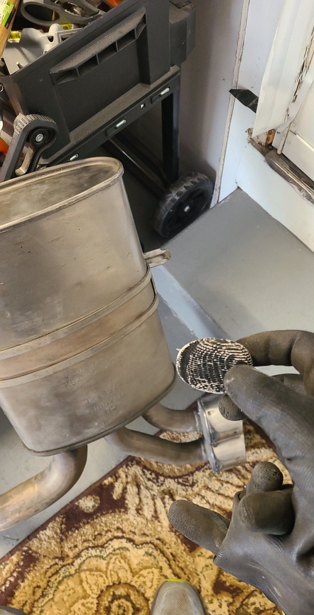

Old Apr 17, 2021 | 03:29 PM
Zac Ritz's Avatar
Zac Ritz
Joined: Mar 2020
Posts: 75
Likes: 5
Finally attempted to get this piece out of my muffler. Removed the muffler and shook the muffler for about 10 minutes and the piece came out. No more rattle
