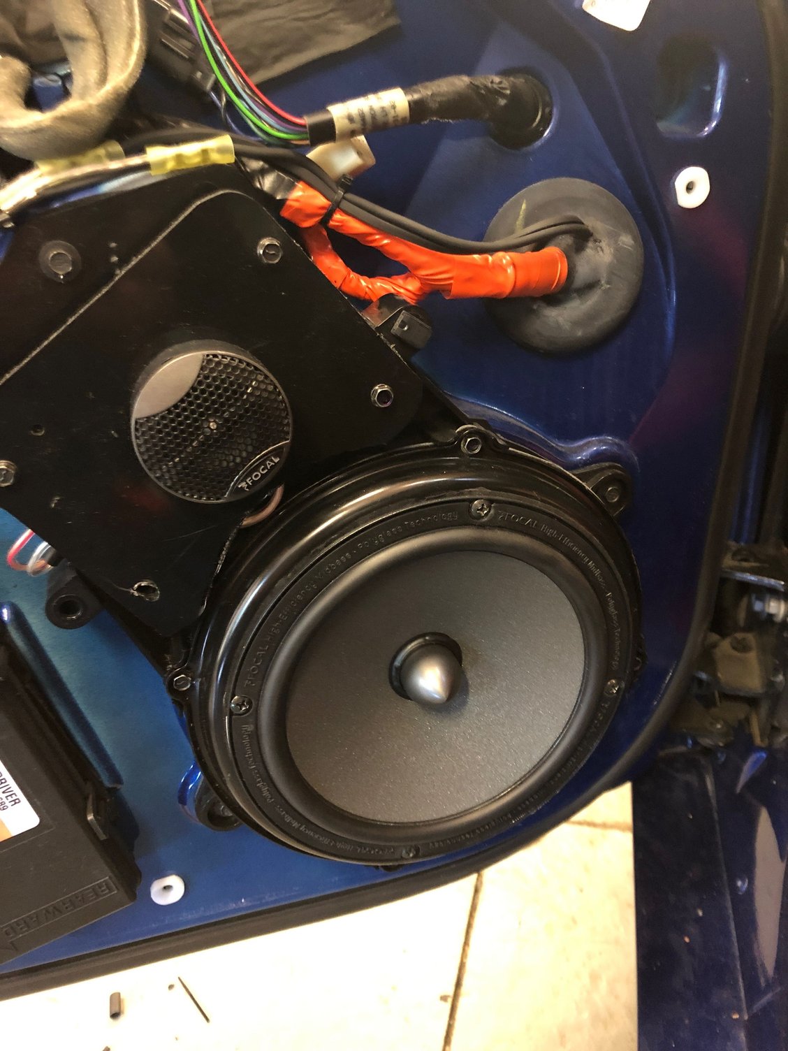

I put six inch Focal speakers in my doors. I use the Bose speakers as a mount. We cut the **** of them with a grinder, but it worked!
Then we made a box for a 10" JL Audio sub.

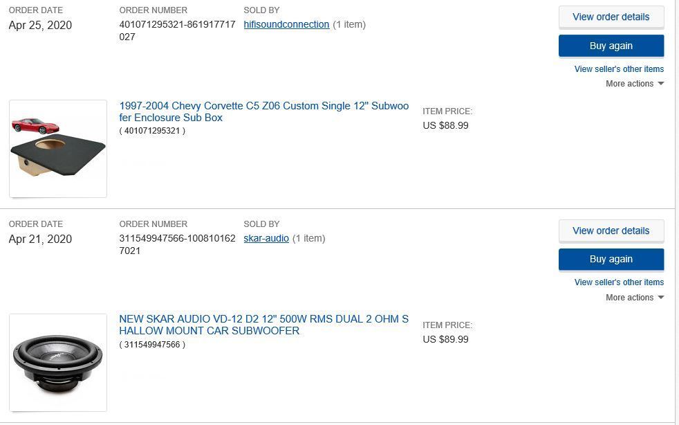

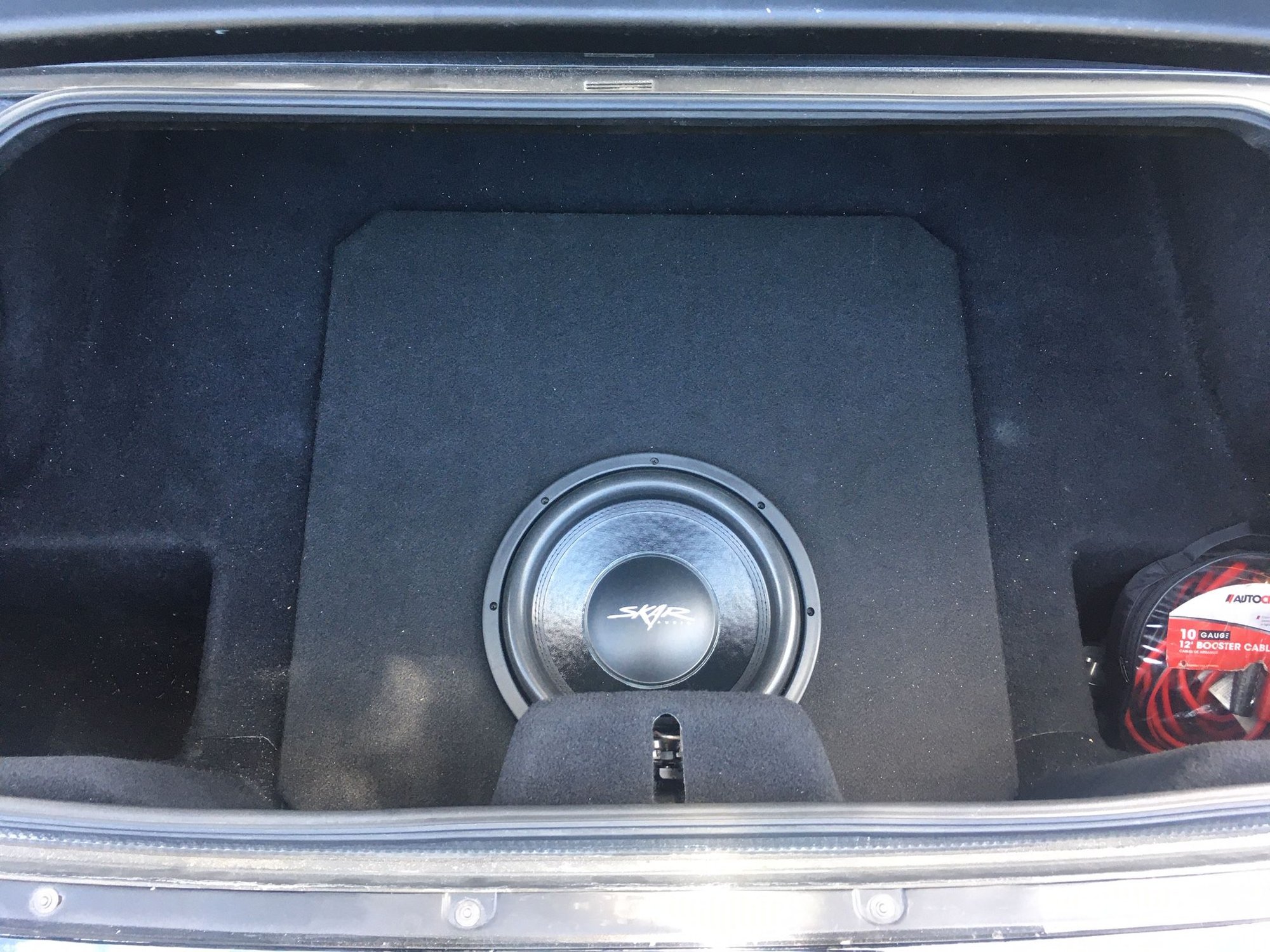

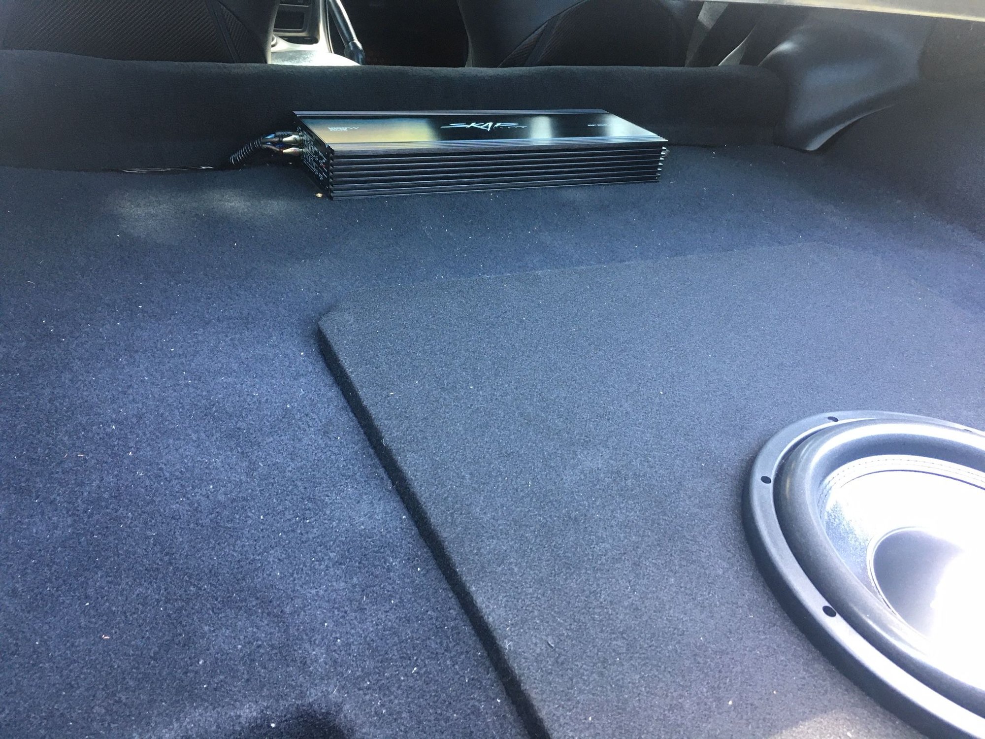

Just another data point for you. This is what I got for my setup and I'm very happy with it; plenty loud, excellent bass, and balanced for my taste. I didn't replace the rear speakers though, so currently the rears are not used at all for me, but I don't miss them since it's a small cabin anyway. So a traditional stereo (2.1) is what my setup is now.
where'd you get that subwoofer enclsoure? that's pretty clean looking, and probably the least expensive one I've seen.

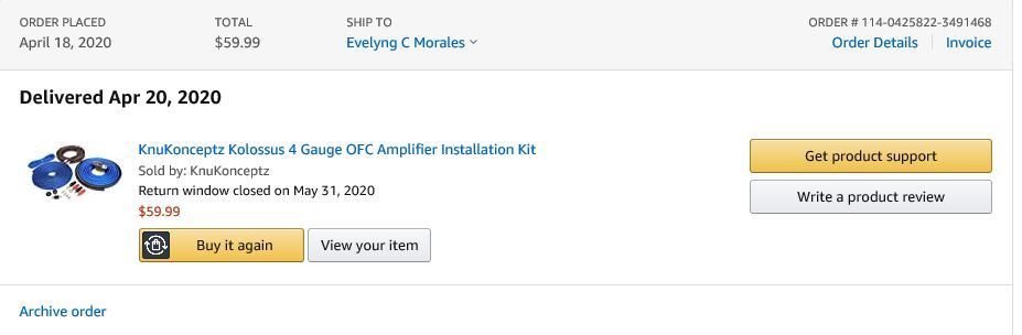

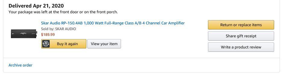

Enclosure, sub and speakers I got on eBay. They were better priced there at the time. Amp and wiring on Amazon. I posted the item description pictures.
By the way, the 6.5" speakers I mentioned cleared perfectly, as well as the 12" sub, but they were both "shallow designs". The one amp I got powers everything; 2 channels for the 6.5" speakers and 2 bridged channels for the sub. Everything was thought out regarding Wattage, Ohms, size, etc. Like I said, PLENTY loud if I crank it up before reaching distortion levels. Loud enough that I don't even hear the engine and I'm cammed with headers and free flowing exhaust.
