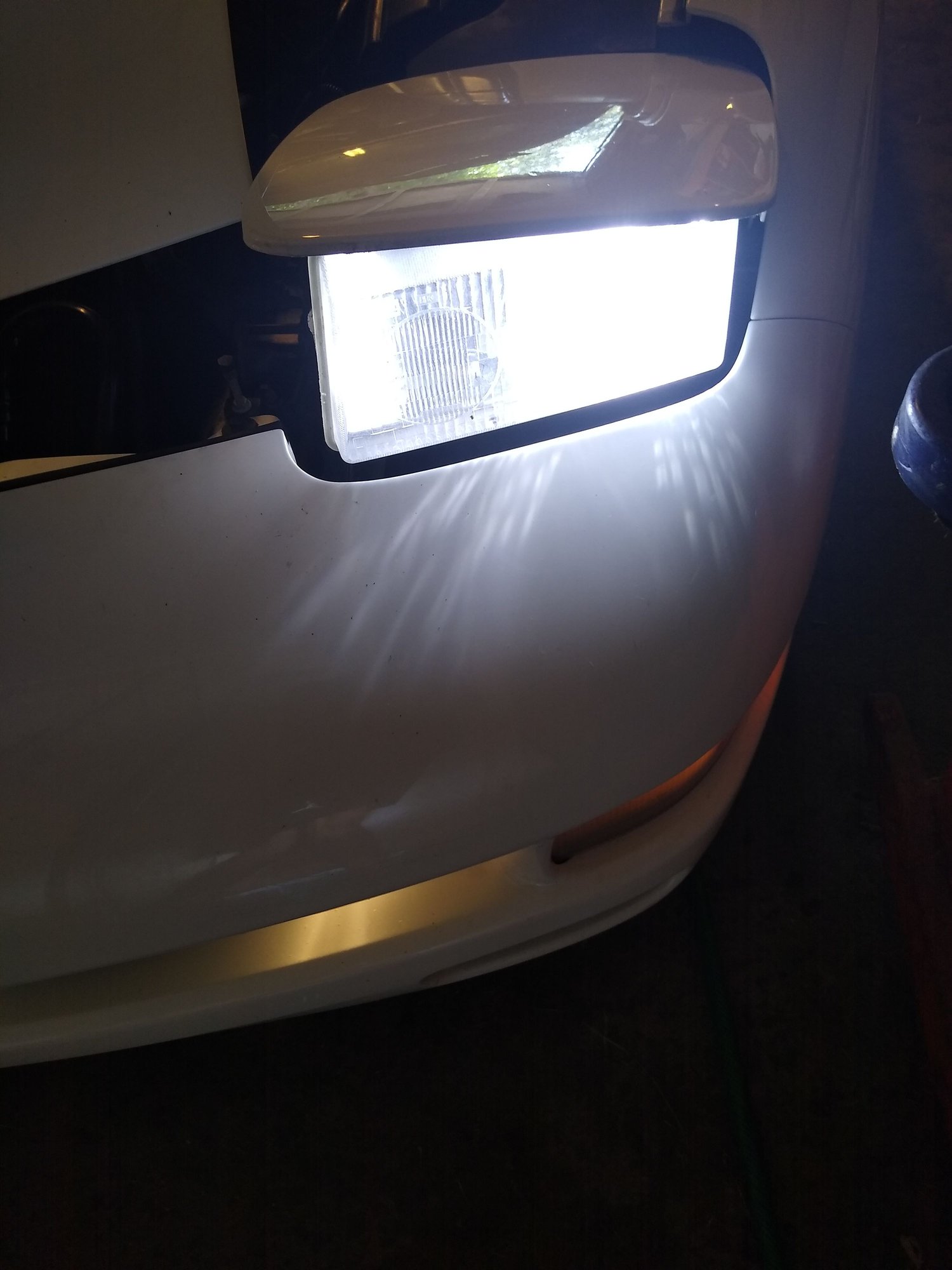

LEDs look great plus I found out for myself that once you have the light up and the black light bezel off, it's super easy to reach the turn signal light. To me that's the fastest way. I literally just reached my whole arm down and changed the bulb. Alot easier than scraping my arm going through the brake duct. Try it!!

Which led did you put in the headlights?

Some off brand. I threw away the box. I got all high beams and low beans for 40 bucks total

are those new entire housing, or you just replaced the bulbs?

Just the bulbs

Nice and bright - which is a great thing.

Yeah I love it

I ran LED for about a year and a half. They're way better than stock (much brighter). However, I didn't like the way the light was scattered when used with the stock housing and reflector. The LEDs are a really great cheap option that offer an improvement over stock. However, the ACA style headlights offer a much better beam pattern. They're a bit pricy though. Just something to keep in mind for later.
