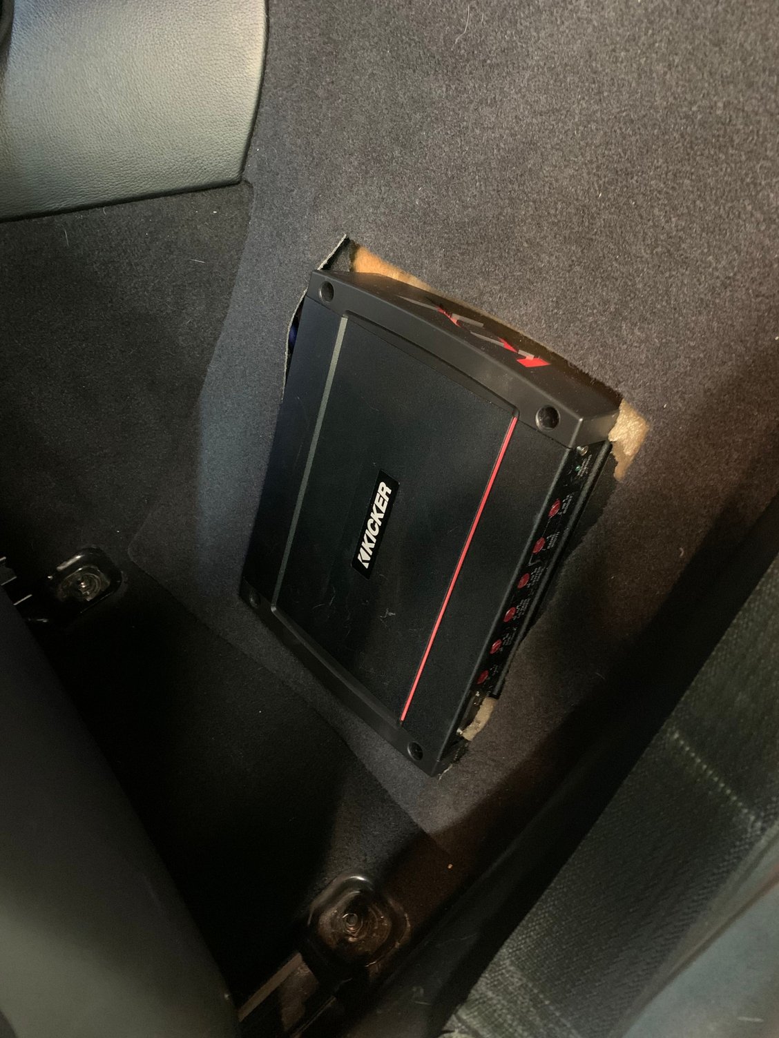

I removed the carpeting and epoxy'ed a hardboard to the bulkhead and then screwed the amp into the hardboard. I cut a hole for the amp put the carpeting around it so the carpeting somewhat helps secure the board in place (secondary to the expoxy)

I put a 1" board behind the rear carpet wall of my coupe and screwed the amps to them
