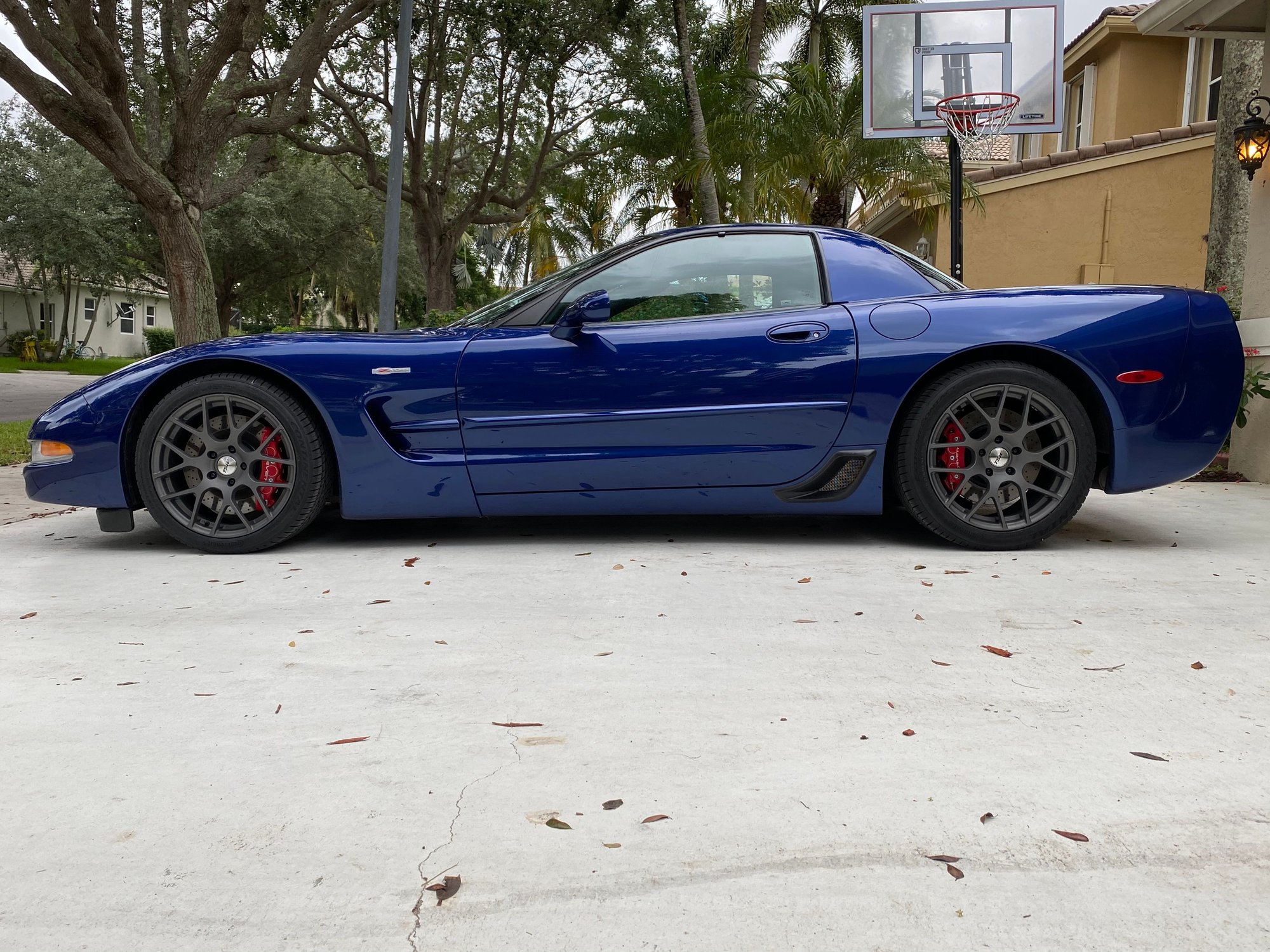

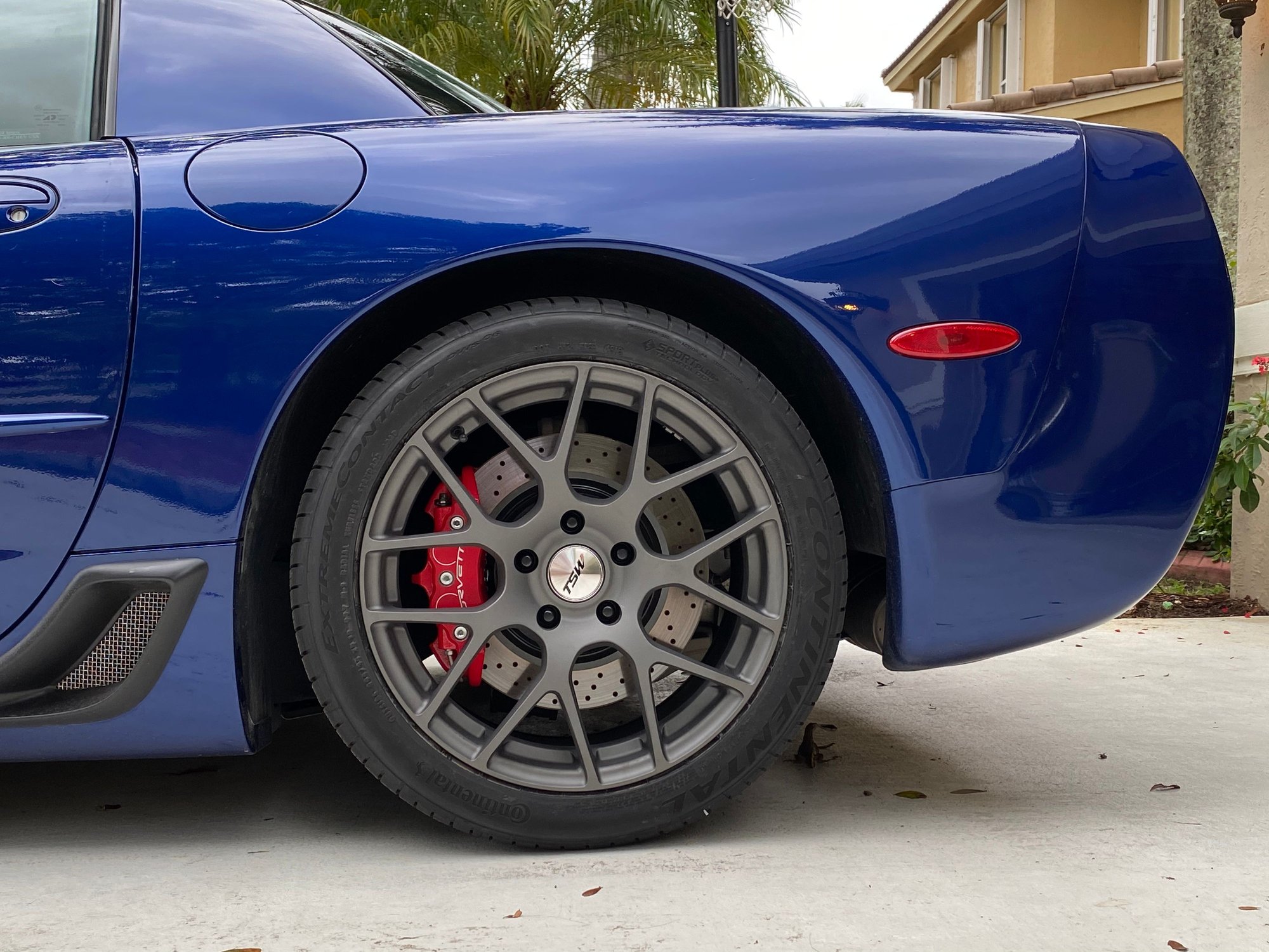

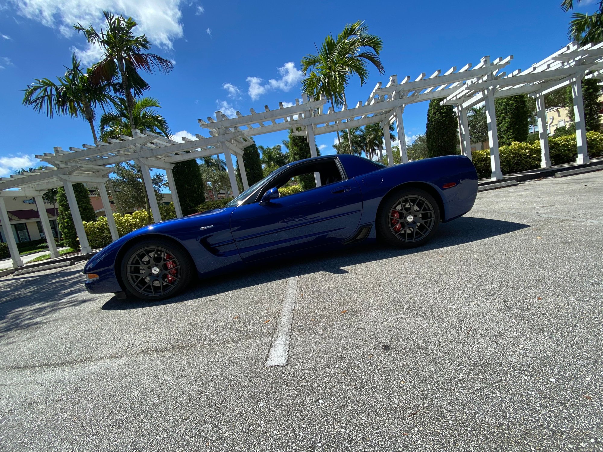

Try lowering it on stock bolts and see how you like it. Two finger gap looks great, not practical on most roads or drive ways though.
Here is my Z with three tight finger gap- and I think it’s perfect. 18” front and rear tires.

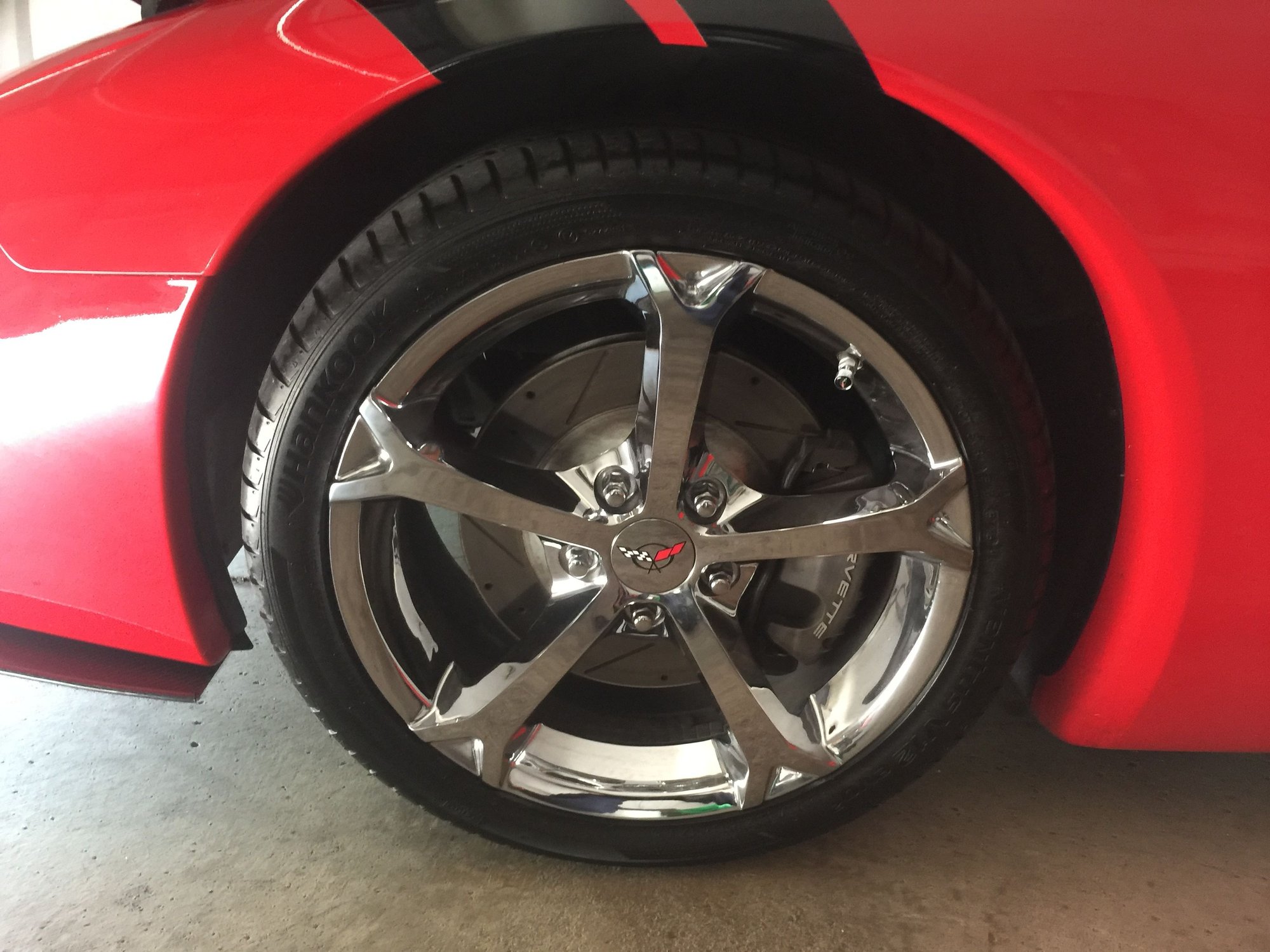

Mine is lowered via stock bolts and appears to be lower than yours.

KNEWBLEWKORVETTE, That's one beautiful car! That is the exact lowered look I want.

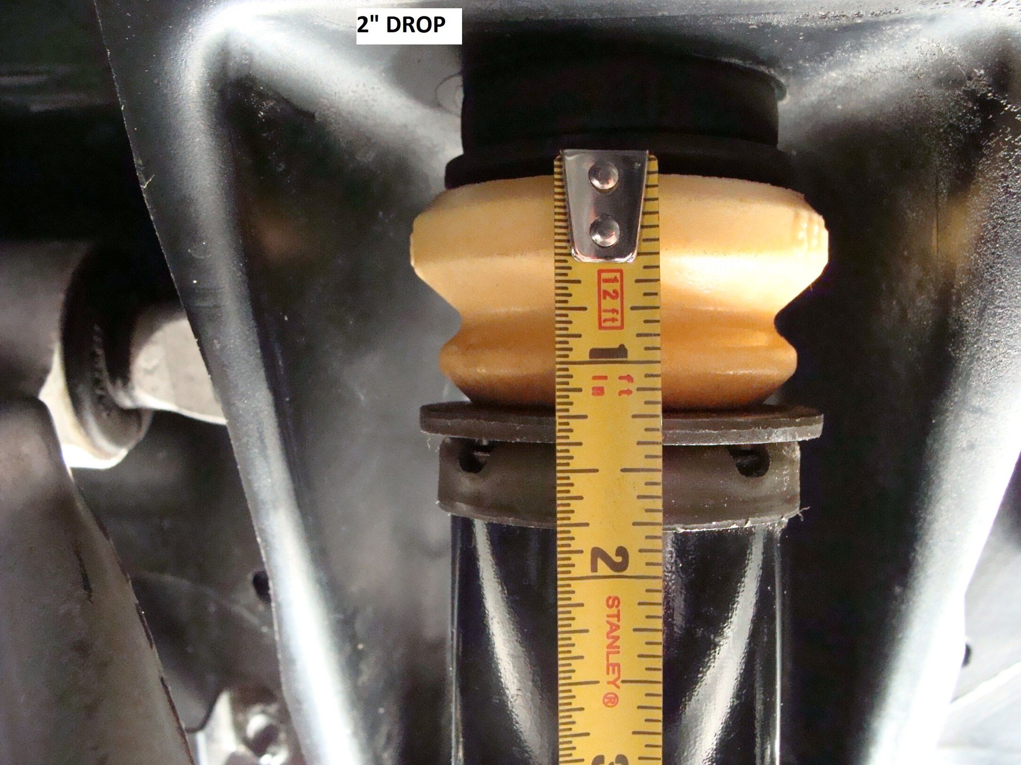

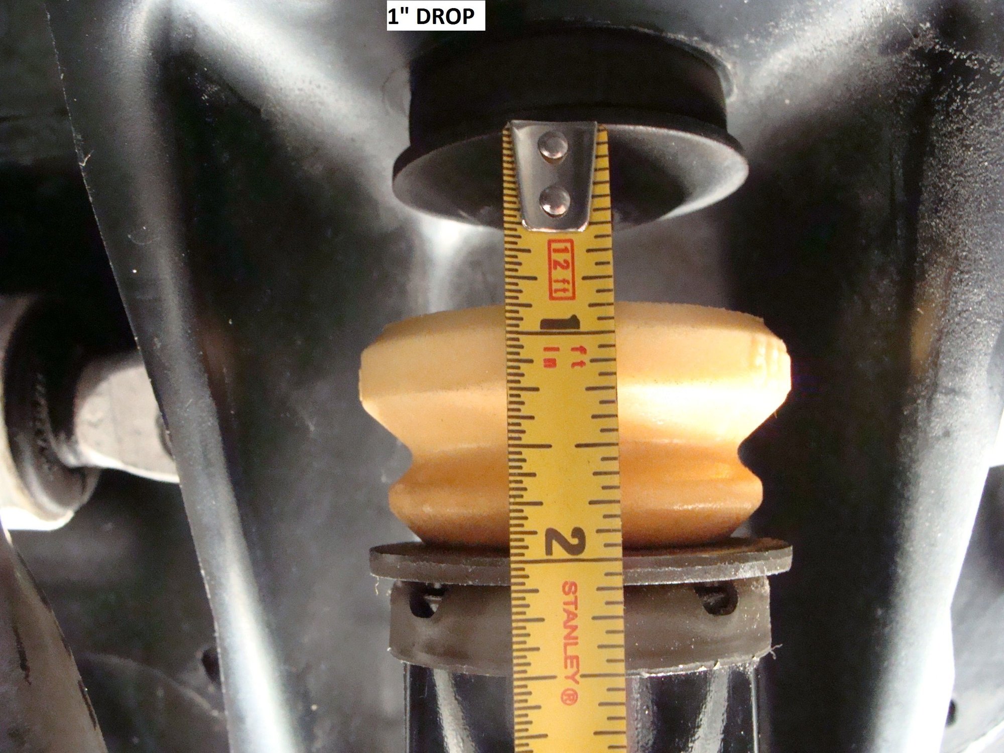

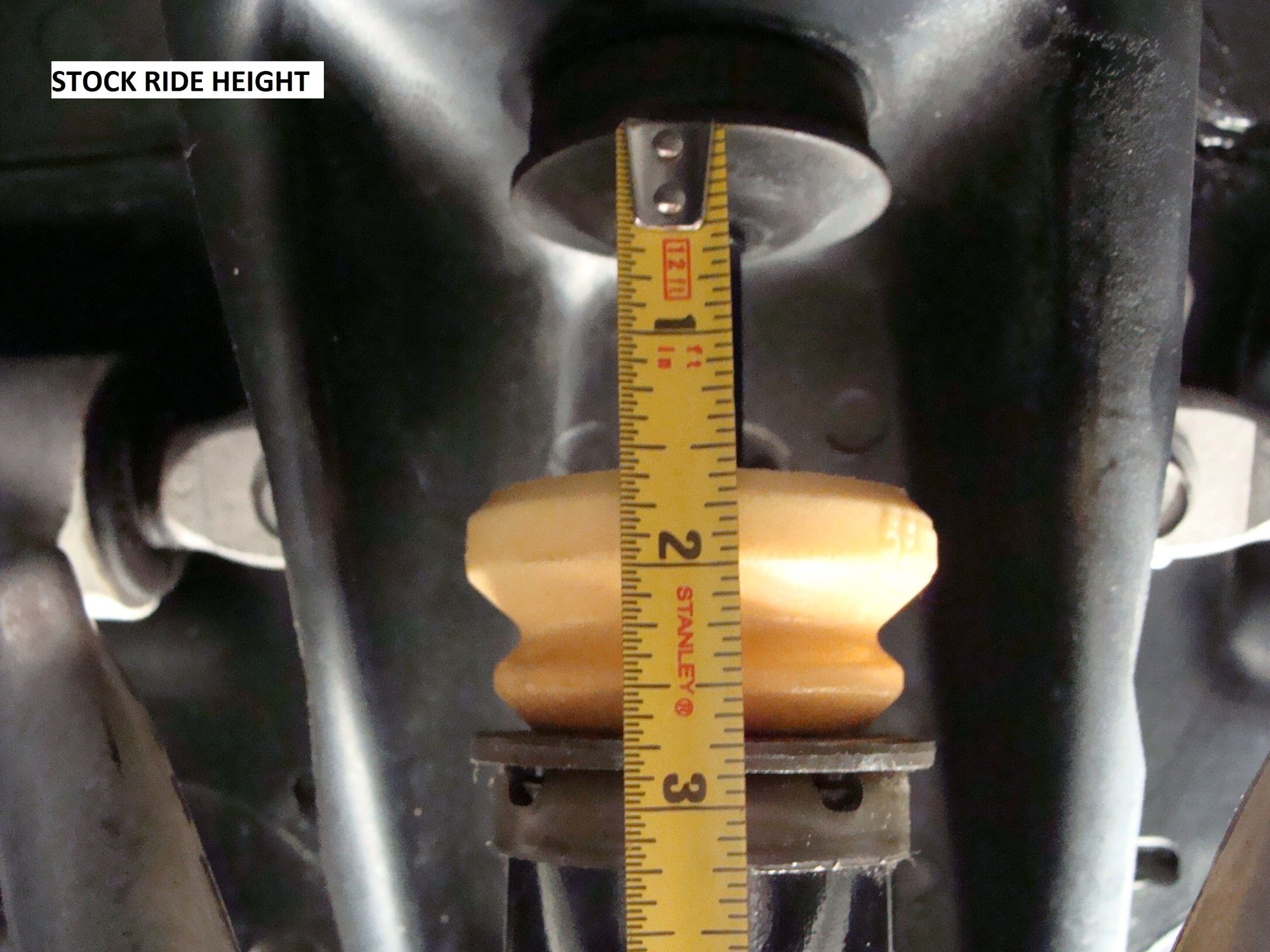

Ride quality also has to do with shock stroke, the lower you go you have less shock stroke, front only showing stock ride height, 1" drop & 2" drop.
