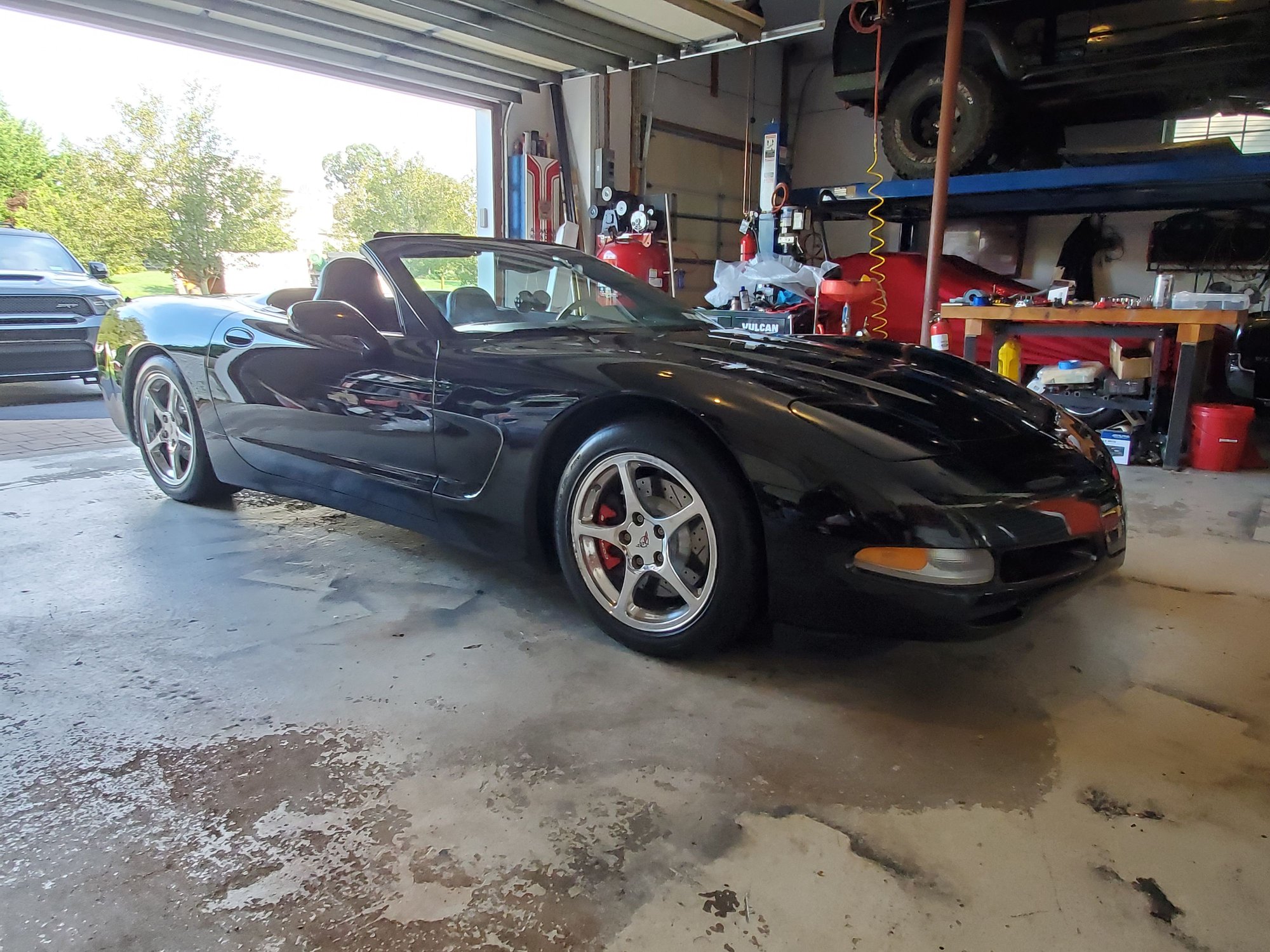

finally got the hu/speakers/door panels/other interior bits all packed back together, ready to drop it off for new rims/tires and supercharger/cam install … my wife gets my parking spot for the next few weeks :-)
Here's the "before" pic... shame I can't find the dyno printout from when I did the exhaust/tune..
