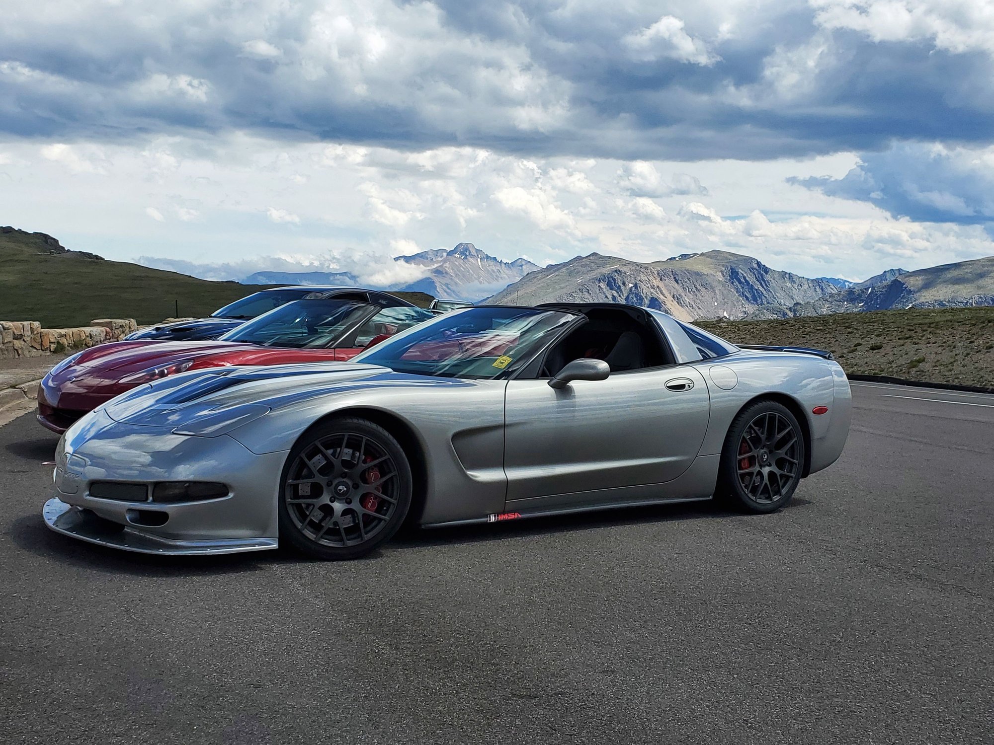

I don't remember what my exact offsets are but any reputable wheels shop should be able to get em right for you. I did 18/19 with 265/35/18 front and 305/30/19 rear.

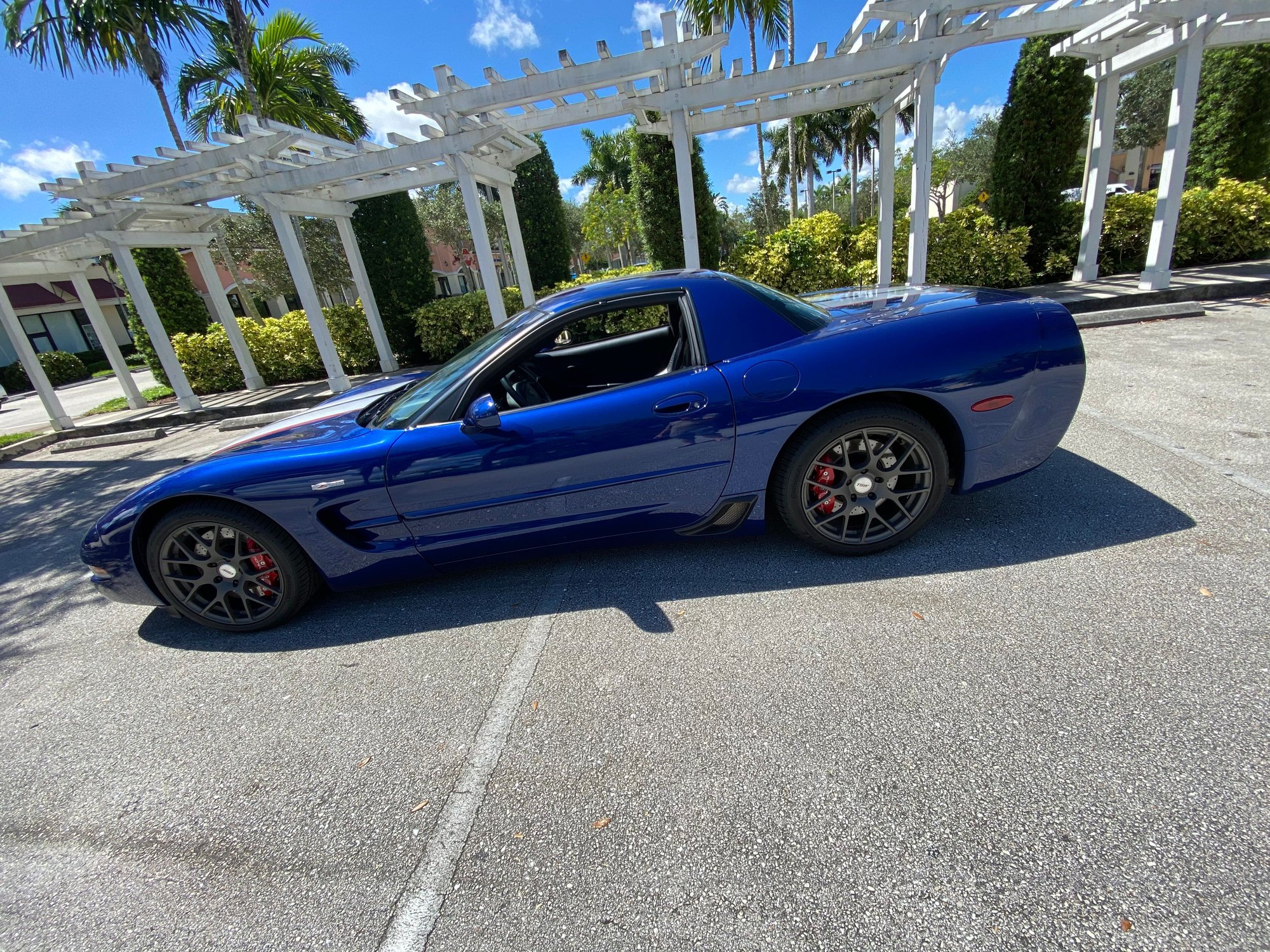

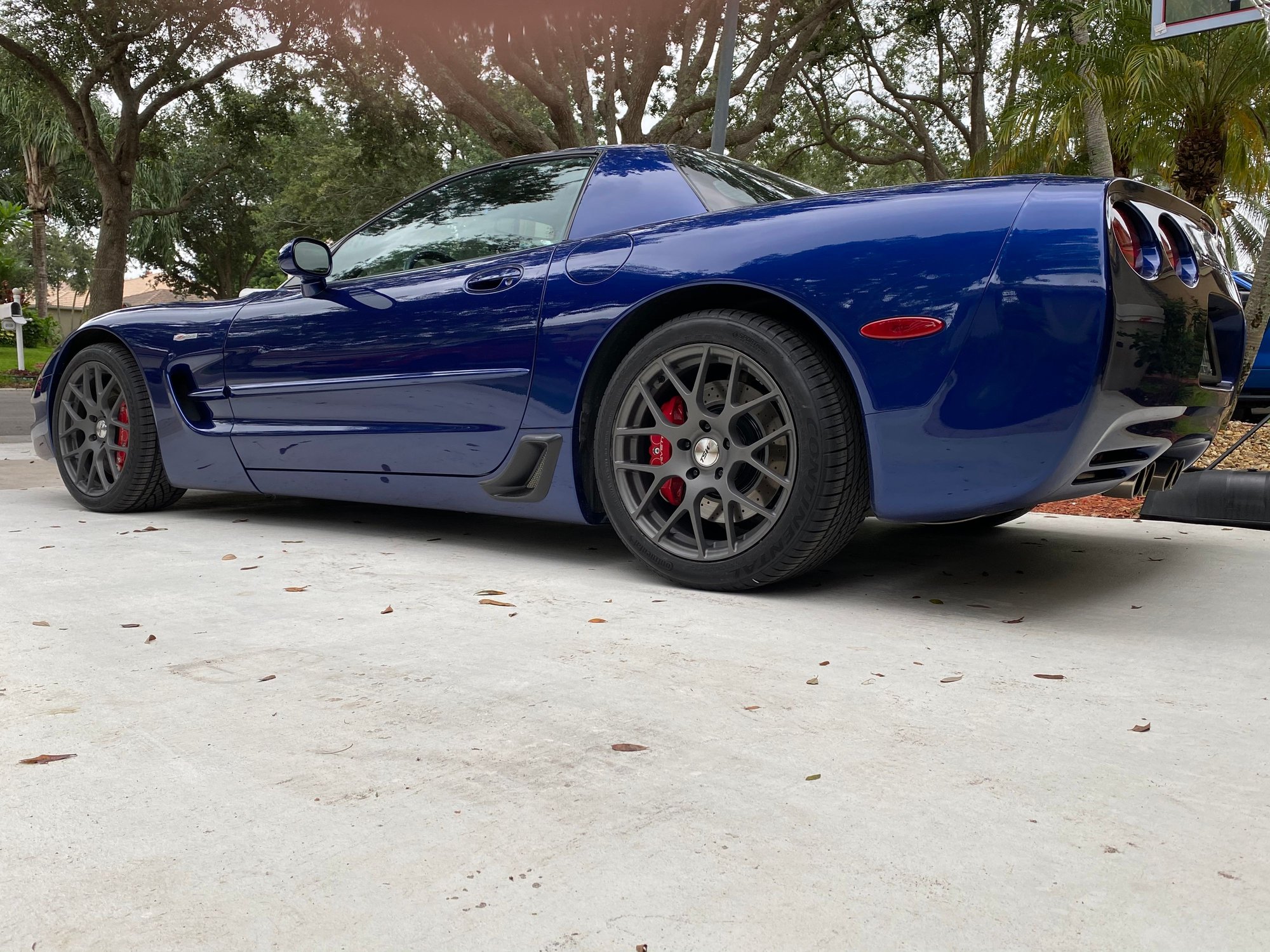

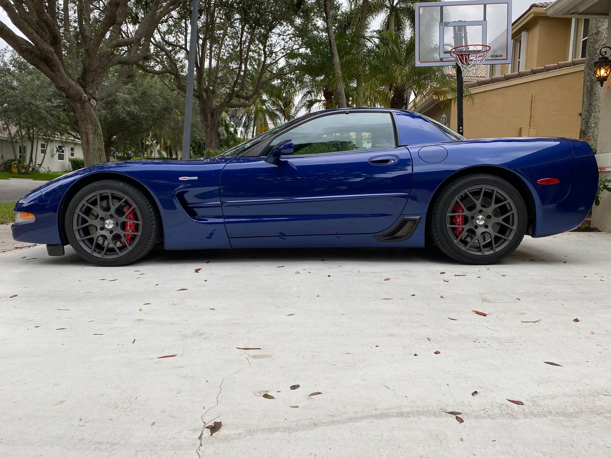

18x9 Front- 265/35/18 (+50)
18x10.5 Rear- 295/35/18 (+65)
Continental Extreme Contact DW06 Tires
No poke out of wheels or tires, are flush to the outer fender lip, no rubbing or other fitment issues. They (in the stock form and spacing) clear C6 Z06 rotors an caliper by a great deal.

I'm going to assume you're asking about my car since it's the only with a splitter. It is the ACP World Challenge front end with the 6inch splitter. Car is converted to a front breather with a fully enclosed undertray..

Originally Posted by Usmc,zo6
That Z looks insane!
Thank you! I absolutely love it!!
Oops, I actually was yes. Thanks for the info, that looks amazing.

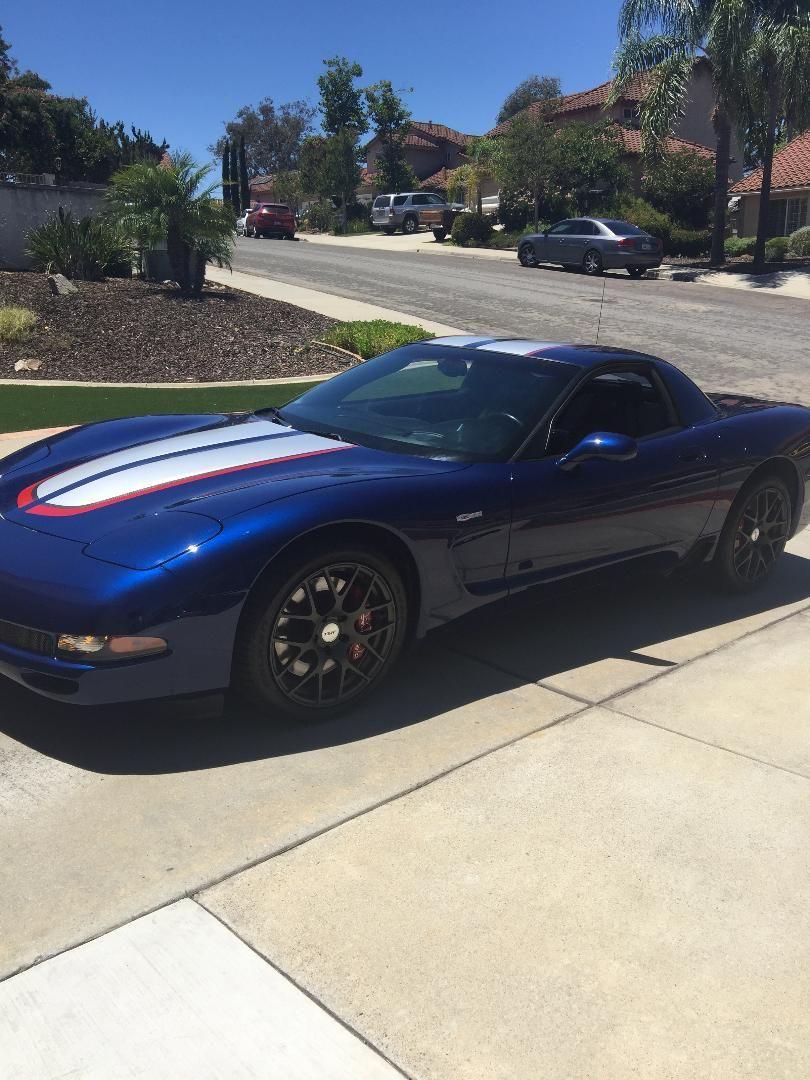

285x35x18 sq set up with c6z brake set up
almost look like twins with fl z
