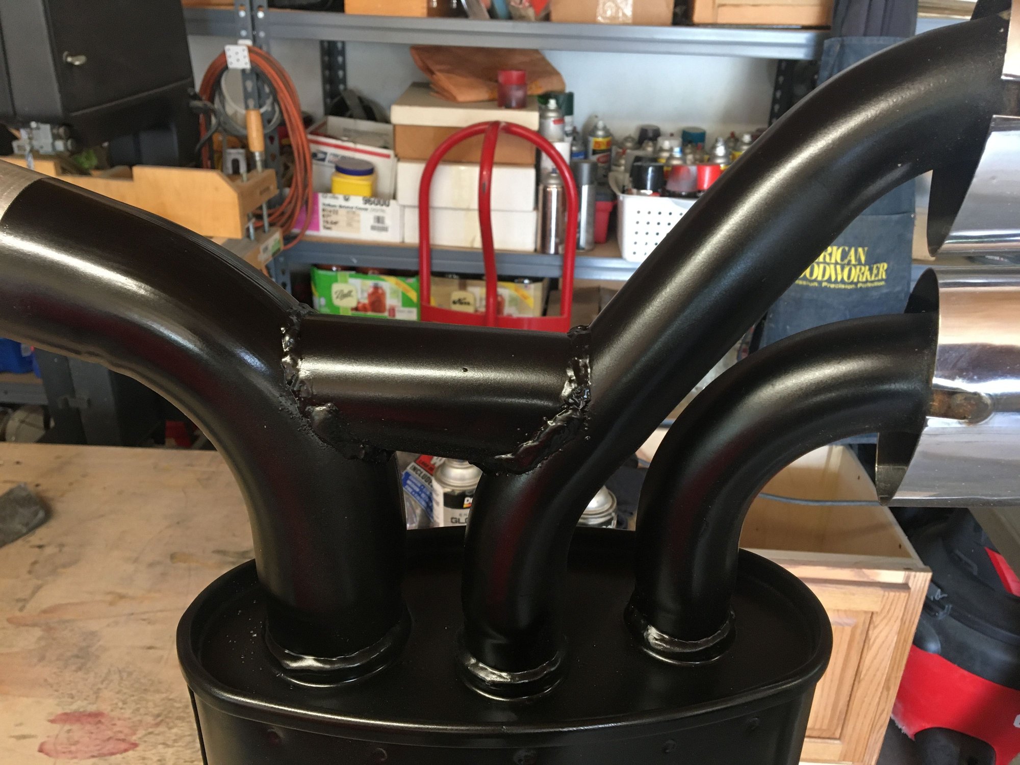

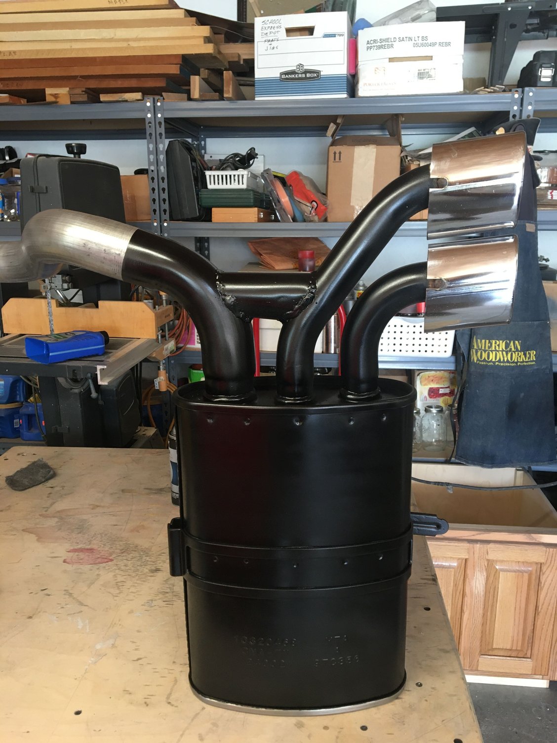

Just did the muffler bypass mod on my 2003 Vert, 6 speed, with 10300 miles.
I bought s set of mufflers and pipes that had been on a 2003 and removed with 300 miles on them.
Took off original mufflers and pipes and put in storage. Purchased another set today to put on my
2004 vert, 6 speed. I will start the clean up process tomorrow on the new mufflers, these had about 30 k miles on them..
Old Oct 6, 2020 | 12:00 AM
glassman2000's Avatar
glassman2000
Joined: Sep 2007
Posts: 138
Likes: 19
From: Bardstown, KY
Photos attached
MUffler installed
Painted ready to install. Painted with caliper paint, black, heat resistant
showing tips.
