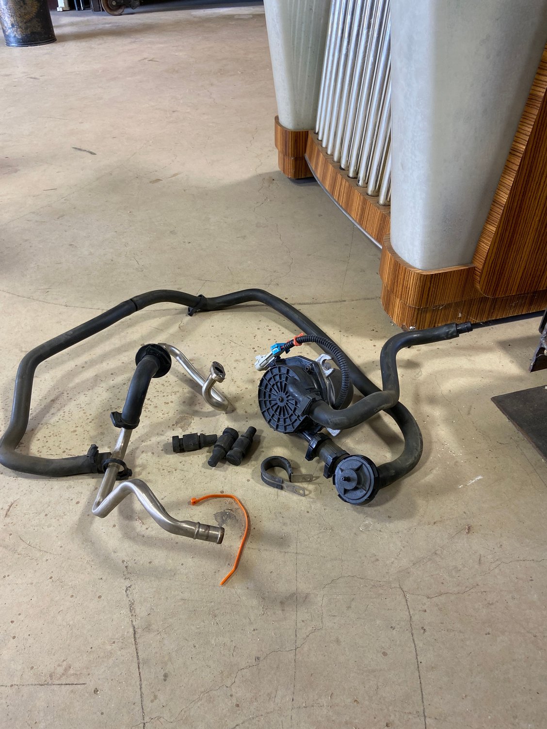

I had to purchase 2ea 2.75” diameter lap clamps to fit the slip fit Borla and mine were used so if you buy new you should get them with it. I bought 24” oxygen sensor extensions because my front sensors are now way farther back. Bought new plug wires because my wires broke when I removed them. Bought protective socks to keep the plug wires off the headers, had to remove the drivers side valve cover to get the header in so you might need valve cover gaskets. Bought clamps to hold the oxygen sensor wire extensions off the headers. I removed the AIR pump and plumbing and built covers to block off the ports on the headers. Bought ARP stainless header bolts and Percys header gaskets. Had to unbolt the starter to get the pass side in.

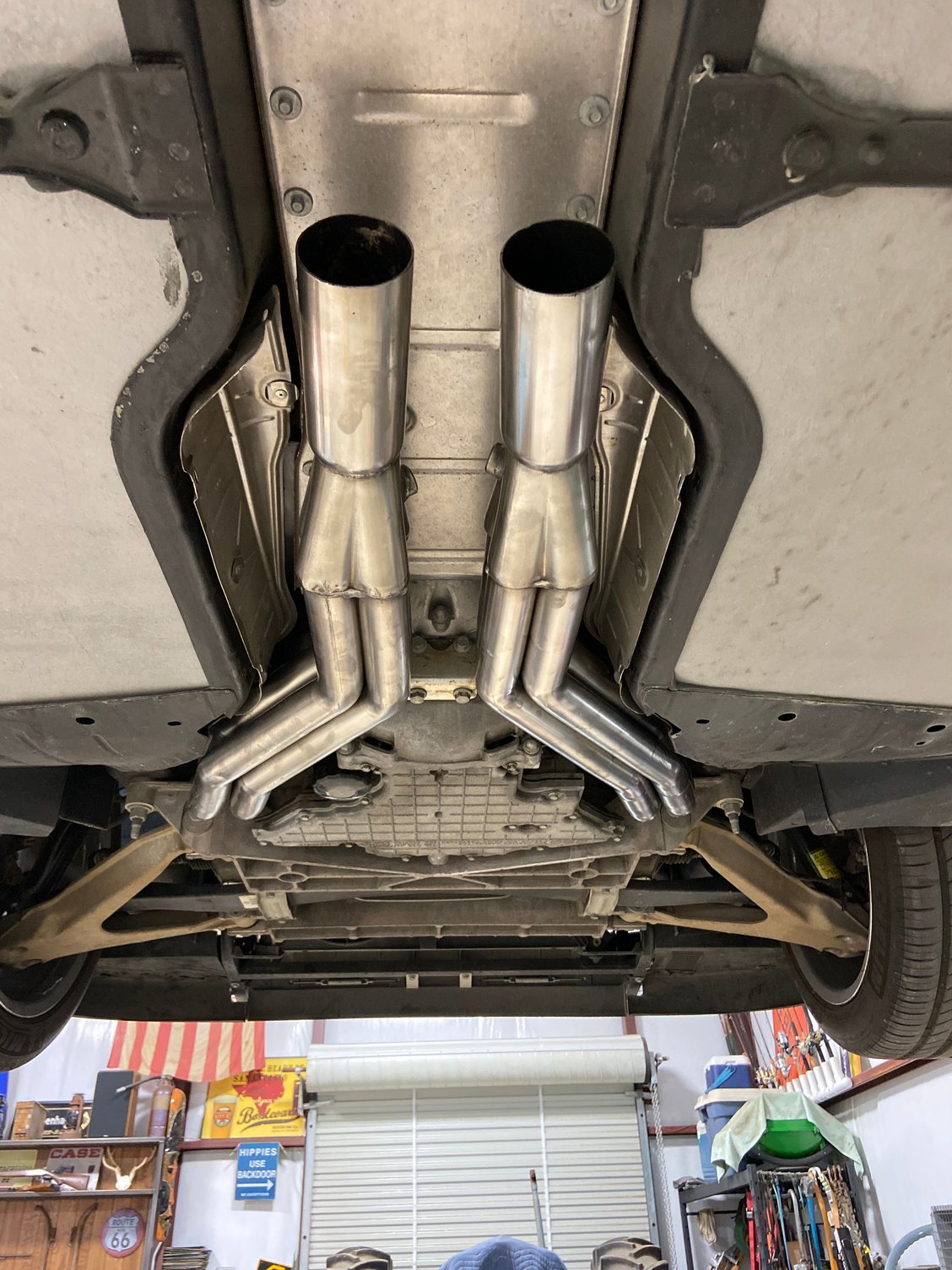

Installed my cat back today. Borla headers, Borla x pipe, Borla atak cat back and no cats.

The 2nd video driving sounds excellent for a stock cam. Very nice mods!
