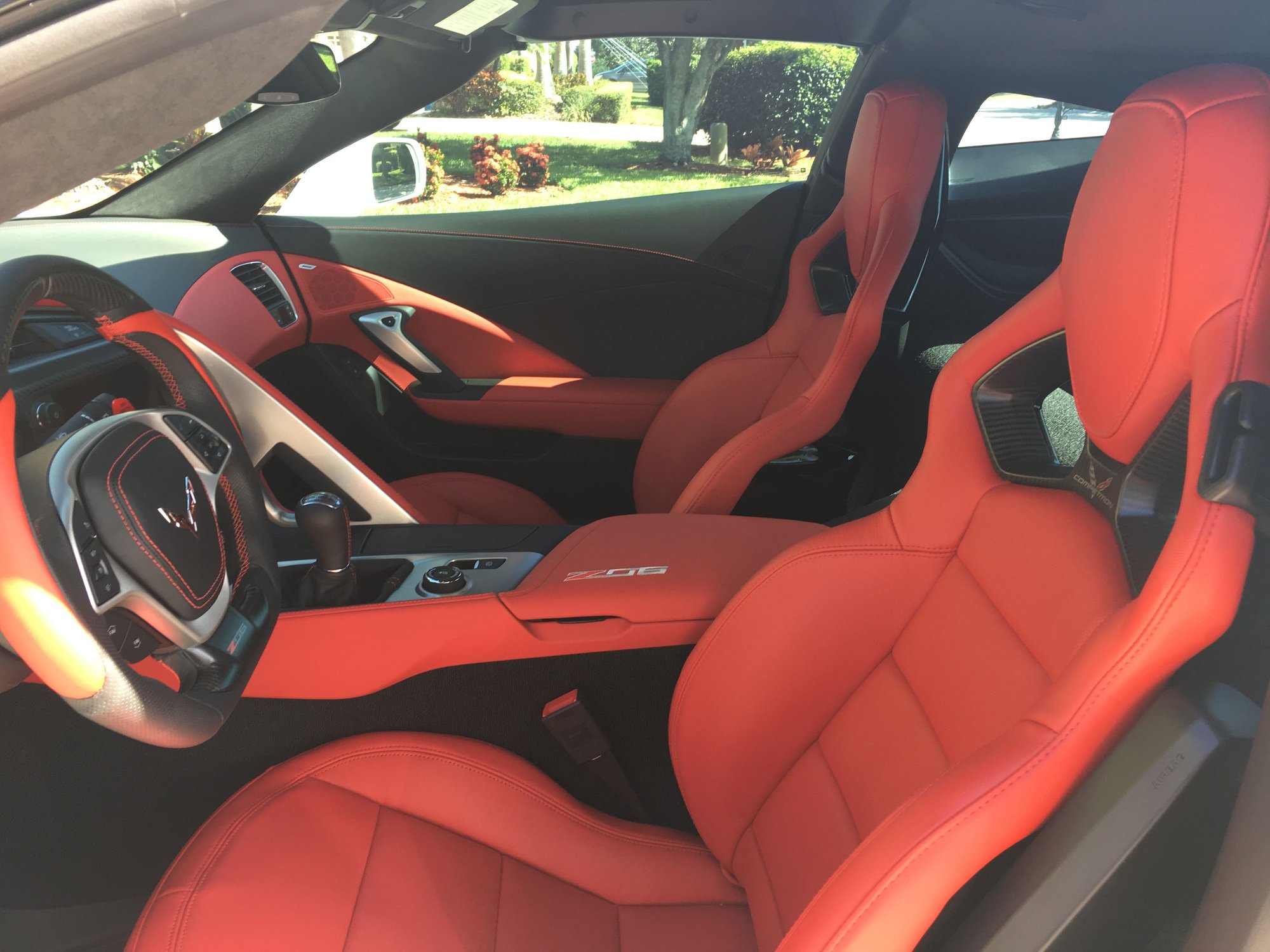

If you like the looks of the Corbeau seats, perhaps another option are the C7 Competition Seats. I have those in my C7Z and really like the look and they fit me like a glove when driving. I have yet to see anyone install the C7 Competition Seats into a C5 so I'm not sure on the fit and/or compatibility as compared to the GT seats.
Those are the exact seats I really want, for my car. Probably never find a pair at a price I can afford, though.
