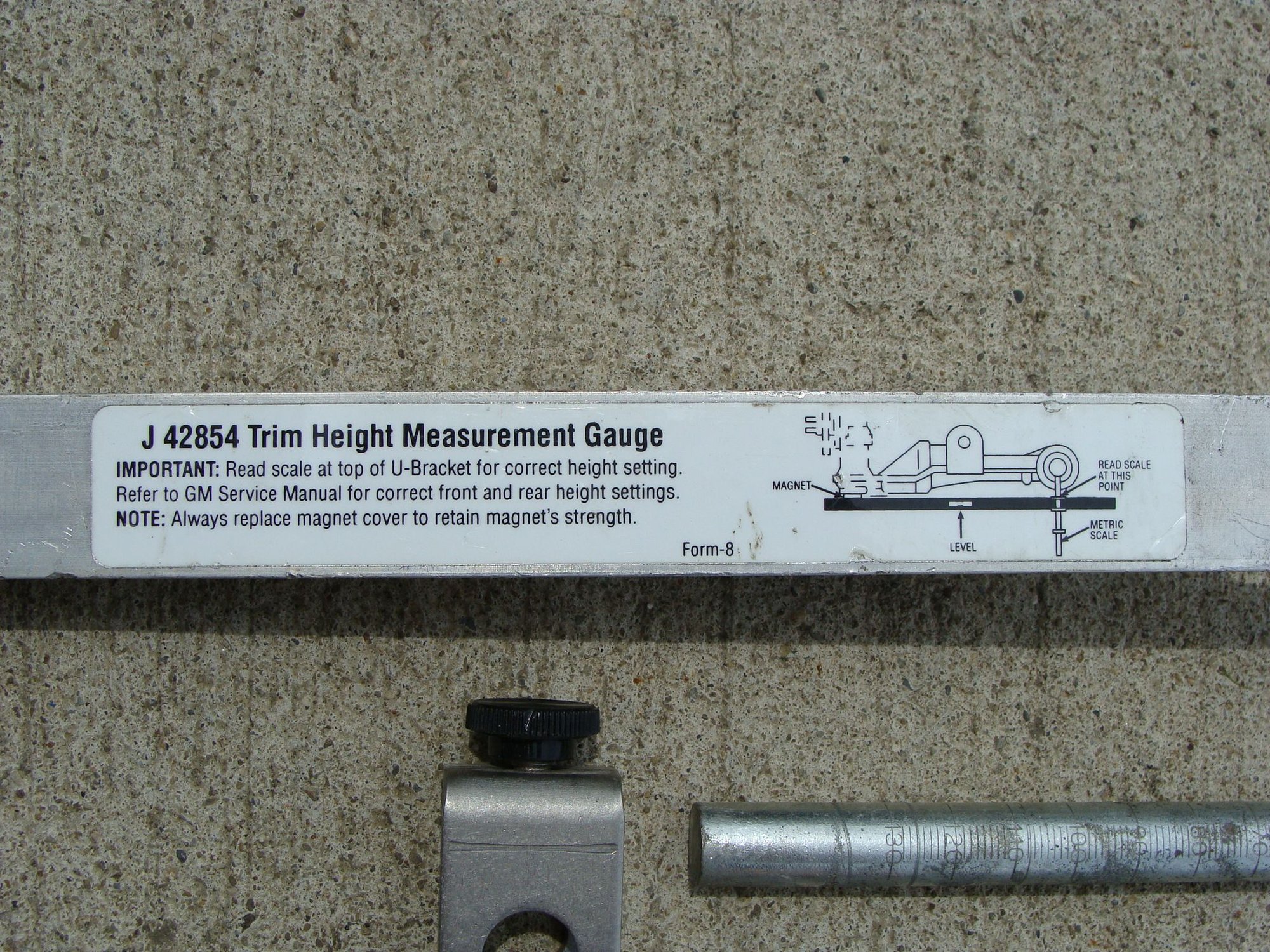

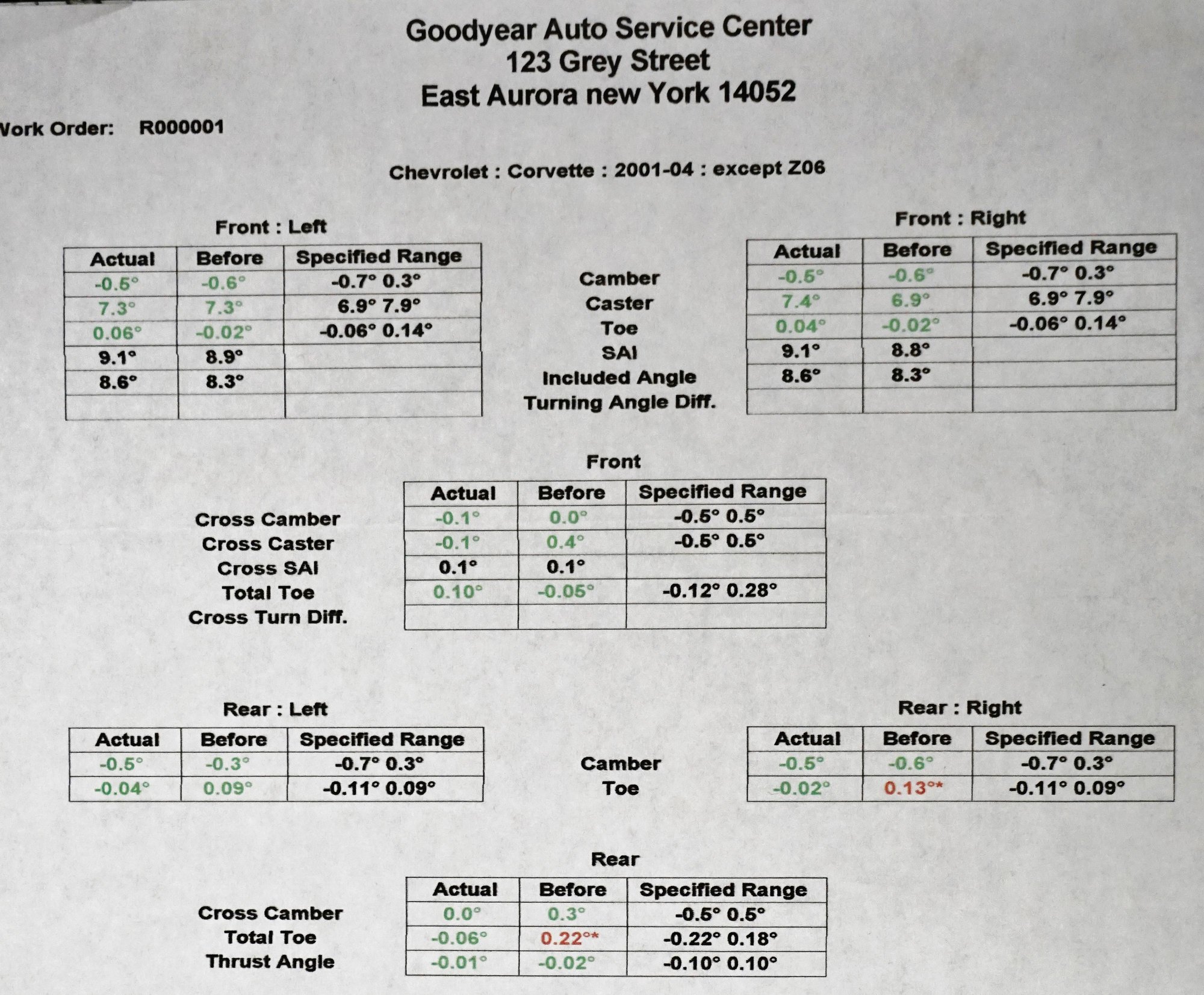

Alignment specs will change when you lower your car, you will get more negative camber & negative toe, I think the recommended by GM for Z51 cars was 15mm which is in the middle of 1/2"-5/8" which I would imagine still keeps you within the alignment specs but they will change from stock ride height. When I purchased my coupe it was all stock with 5,000 miles I lowered it about 3/4"-1" in the rear & 1/2"-3/4" in front then took it for alignment & you can see how much from the stock settings it changed, but most of the settings were still within the range. I would have liked to see what it was at before lowering to get a better idea as an actual change, the guy who did the alignment said it looked as it was never touched so I would assume it was still at the stock coupe & convertible specs.
Also if you over lower your car then you would run into the bump steer problem & also shock stroke would be shorter so you would possibly hit the bump stops on compression strokes.
The 2nd & 3rd photo is the trim height gauge the dealers used to set ride height, I do recall threads & photos where the cars mostly Z06's were raised for transport purposes & the dealer was required to reset the ride height once at the dealer using the pictured gauge.

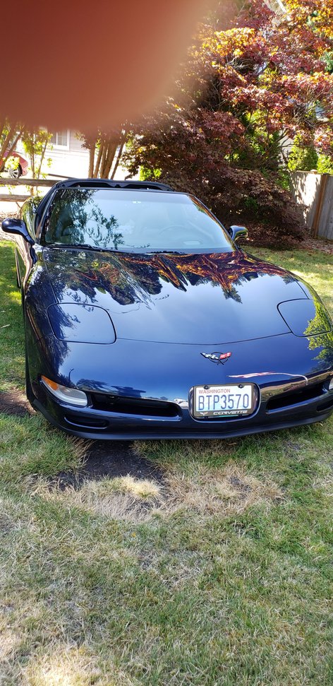

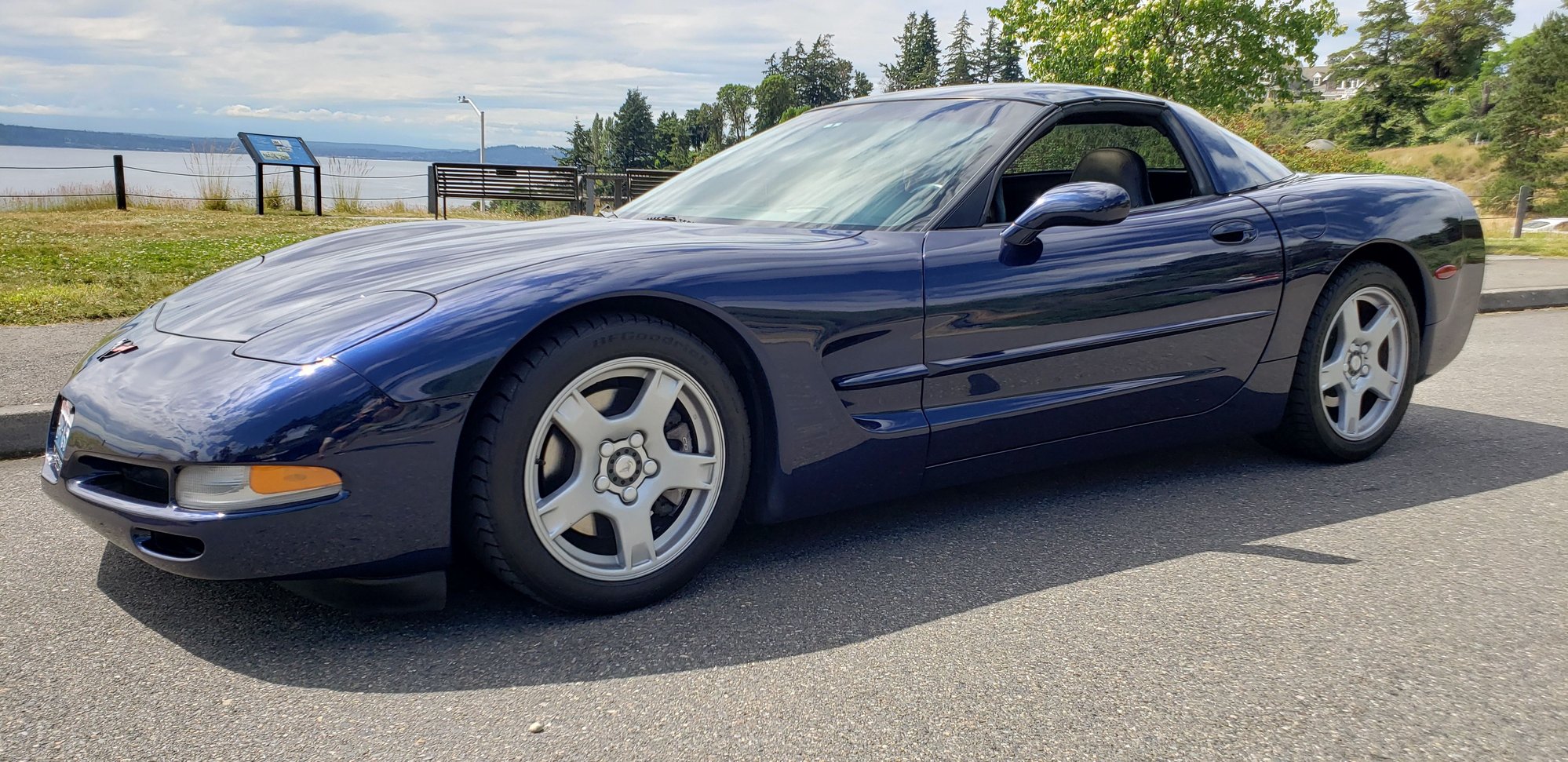

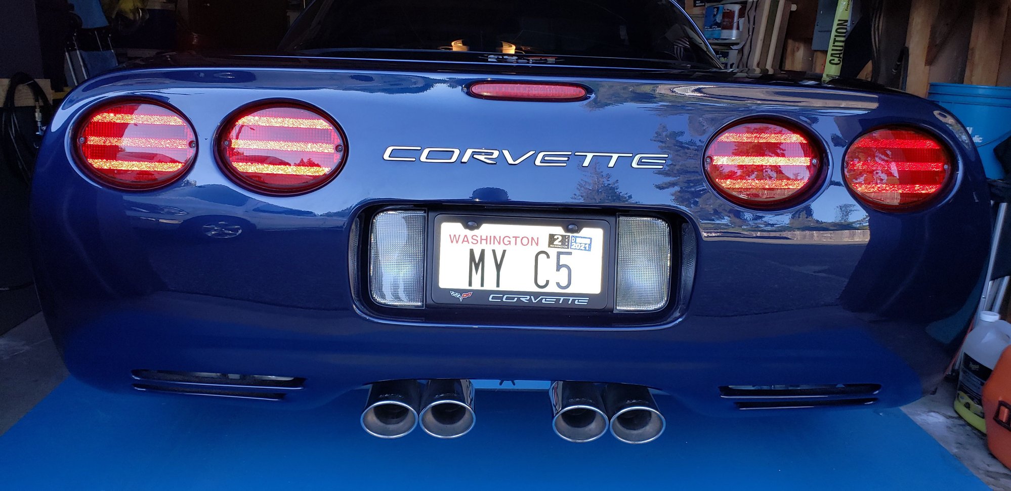

I'm third owner. First owner had her for almost 15 years. I found him and got all his records. He dropped her down front and back as far as he could on the stock bolts. Now I have about 2 inches between the pavement and the air deflector. I drive out of my driveway sideways and very slow but I love the ride and the looks. Here are three pictures that might show the height and it's on stock "wagon" wheels...ps, I love the stock wheels...almost no one has them anymore. And the last picture is what I did to her today...personalized plates.
I say go ahead and drop it down...you'll love it...just be careful of the driveway...lol

Beautiful car - love the blue - I always like the “wagon” wheels - hardly see them any more - the stance is perfect - my ‘98 now has the same stance - thanks for sharing

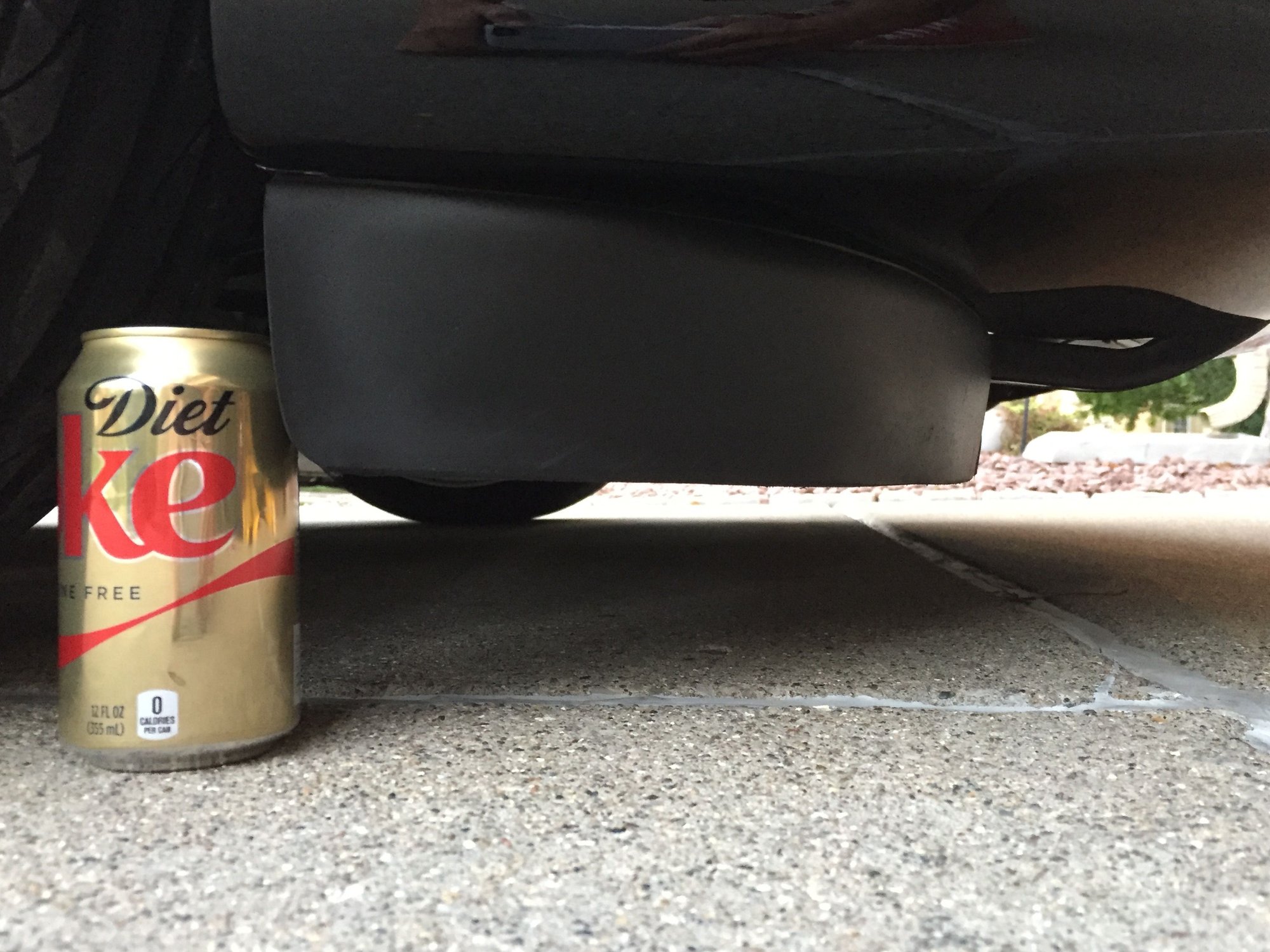

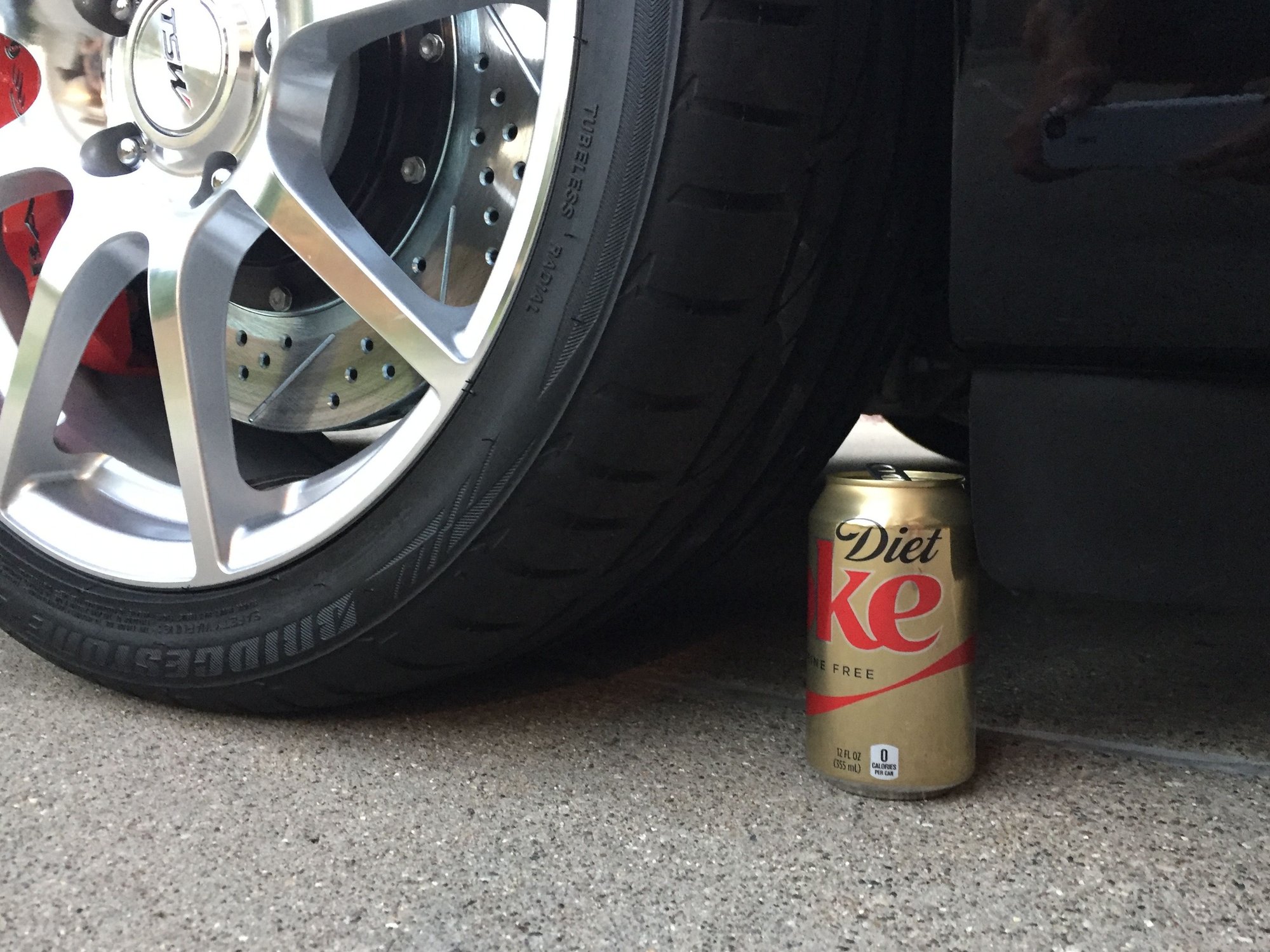

I’m Z one's Avatar
I’m Z one
Posts: 2,318
Likes: 243
2022 Corvette of the Year Finalist -- Modified
2021 C5 of the Year Winner - Modified
Mine is lowered and stack bolts and here it is
for reference to a 12oz can of Coca Cola.
