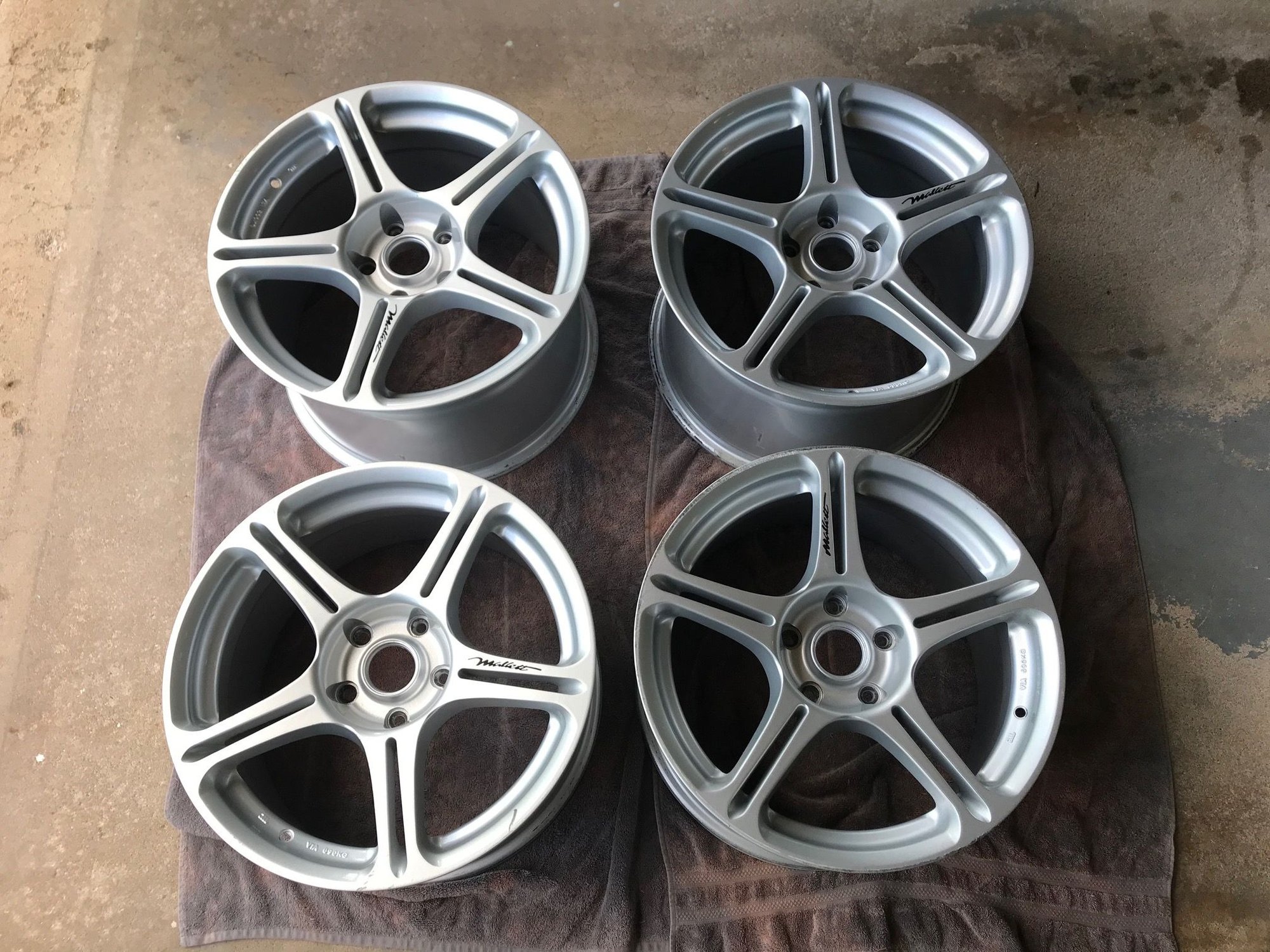

Here are some pics of how they sit currently.

Great rims, kind of thin spokes kicked up a notch. How are the weights? I'm running the Continentals on thin spokes (O.E. sizes, of course). Tremendous tires. Much better, to me, than the Michelin or Bridgestone.

I haven't been able to track down too much details on these, but as far I can tell they are just standard cast alloy, nothing special in terms of weight.
I saw some old posts that say that these are manufactured by the same company that did the XMS version, just to clear that up. I guess Mallet had early rights but XMS started selling them at some point.
I will post pictures once they are setup but i expect that wont be until spring at this point...
