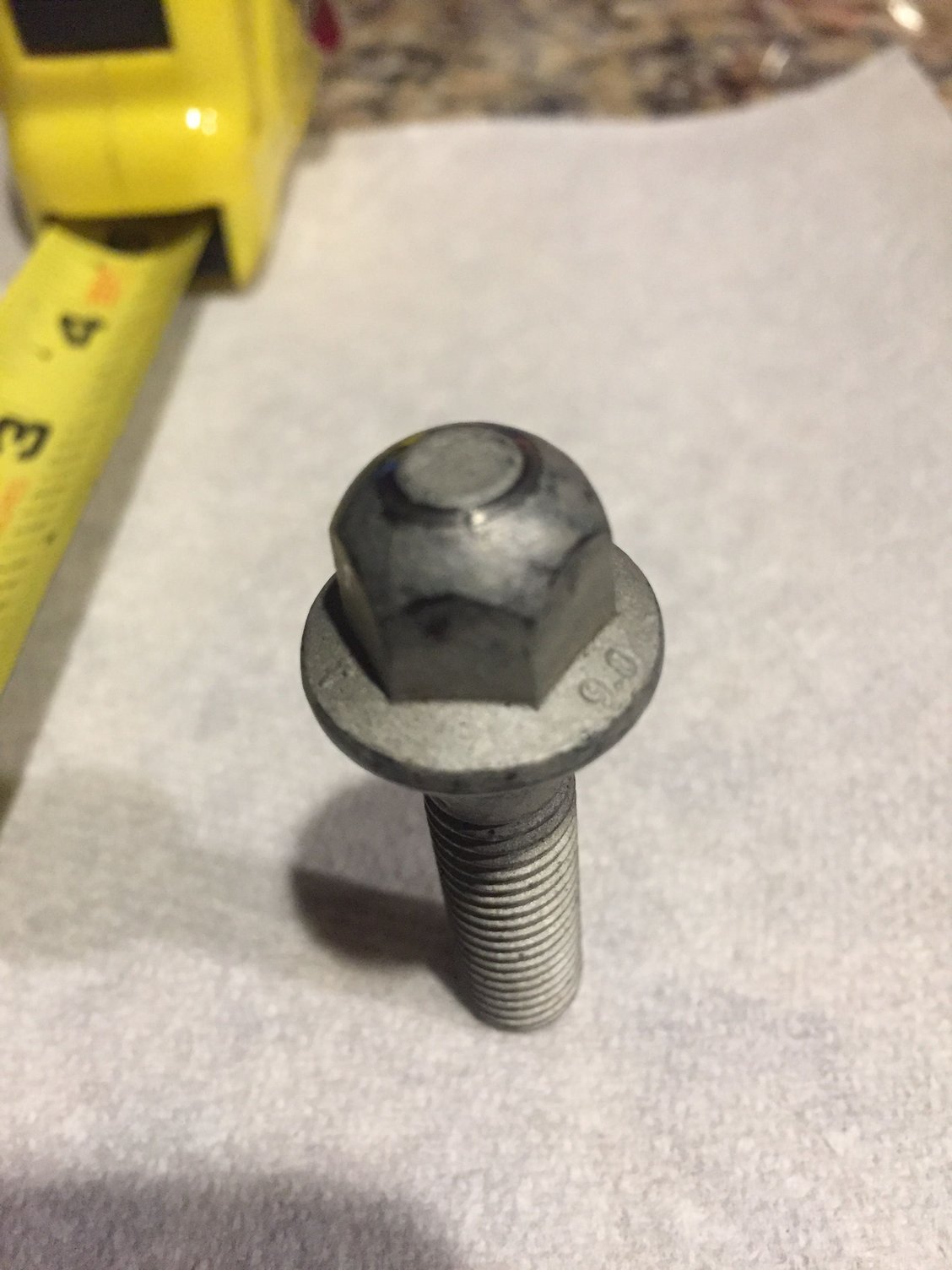

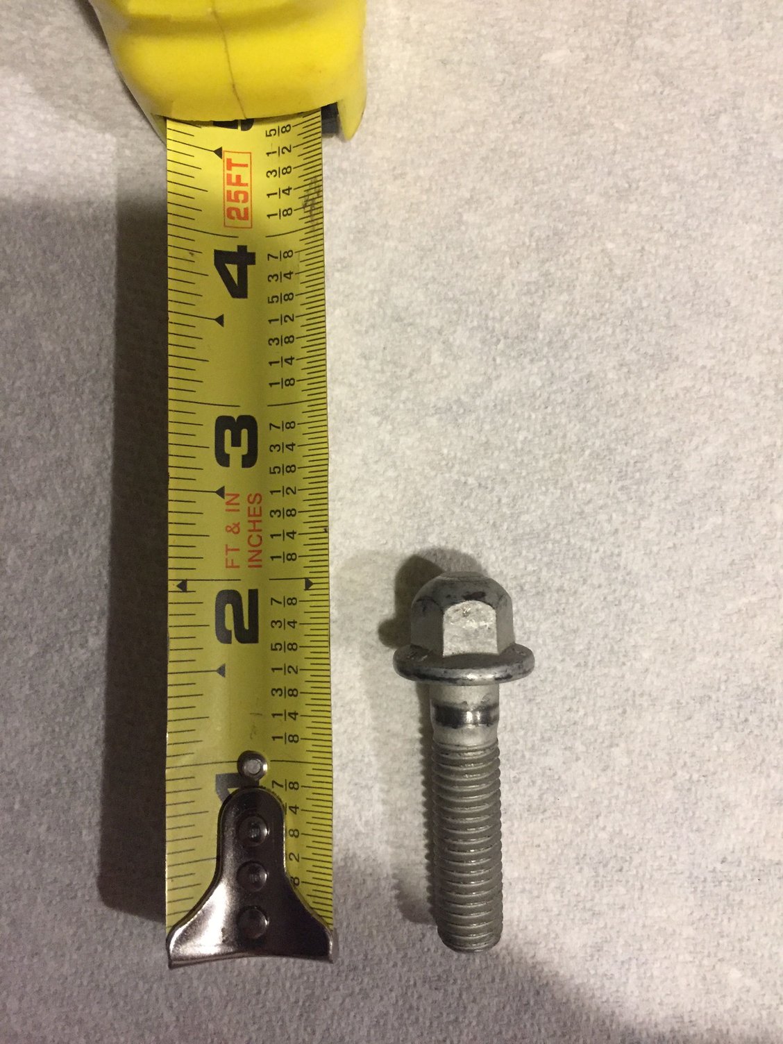

Vehicle is an 02 Base A4 Convertible and while I was changing the plugs I removed the valve cover plastic dress up shields.
Sitting between the manifold and the top edge of the passenger V.C. I found this. It looks like a suspension bolt but the head is 1/2 inch not 13mm
Anyone who has an idea where it came from please chime in

I highly doubt its metric. 13 fits very loosely. 1/2 inch was tight
I’ve rebuilt my entire C5. That’s metric 9.8 on the head of the bolt tells the tale. Get better tools.

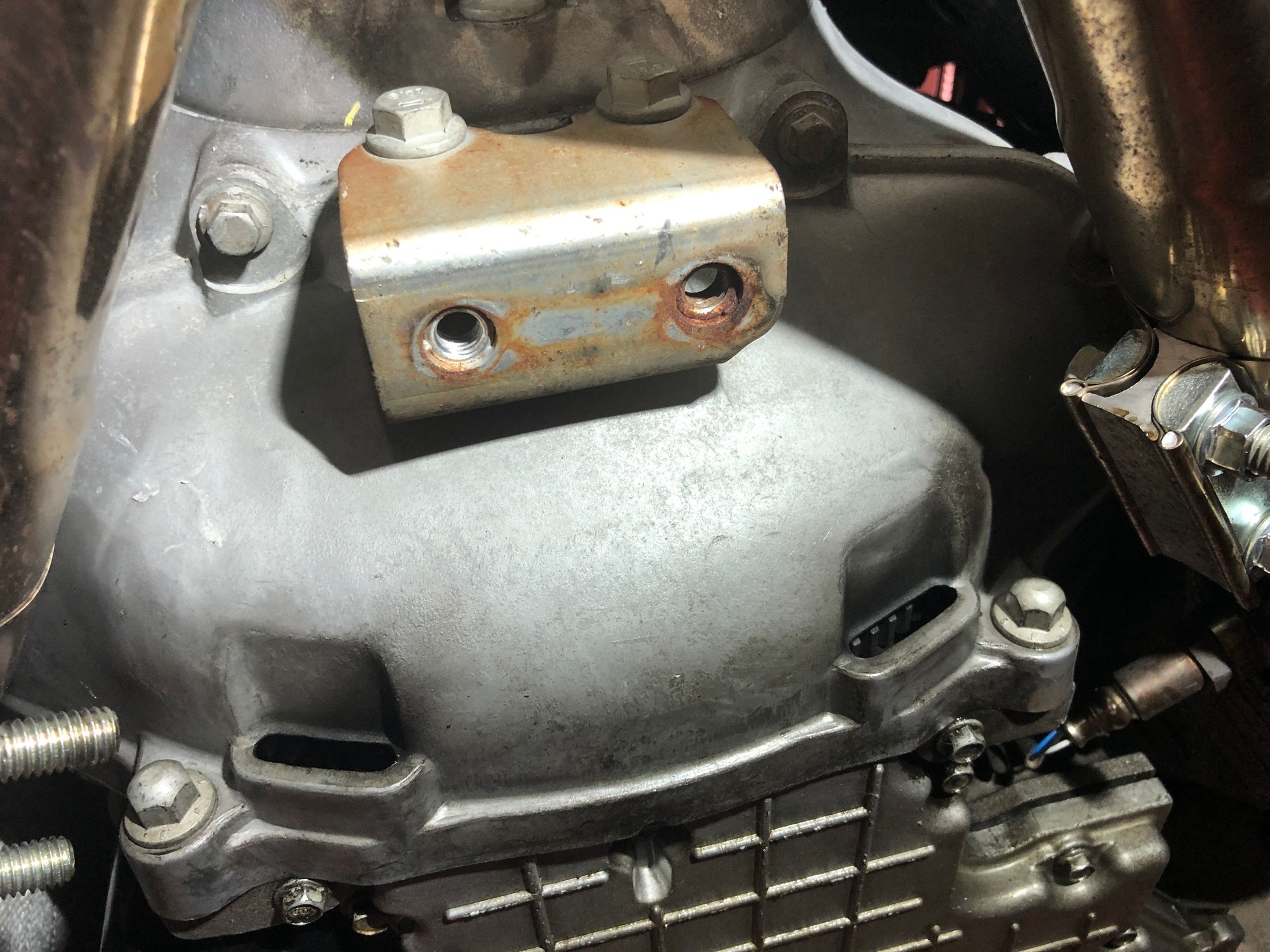

bellhousing

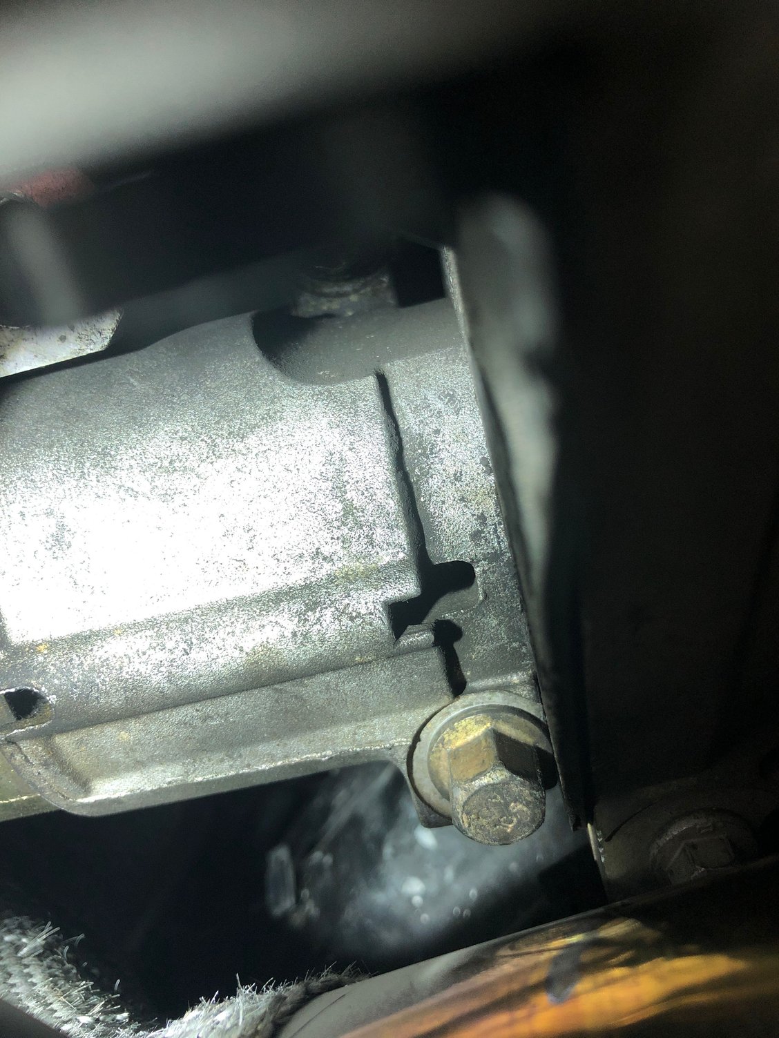

starter

If you have headers check here too. Some types don’t use this mounting location on the bellhousing clearly

Ahh, I have Craftsman sockets and wrenches and are in good shape. The bolt is < 13mm. If that thing is a 13mm sure is sloppy.

It’s a torque tube bolt from either the motor or transmission end.
Old Sep 13, 2020 | 11:20 PM
Hary Gahtoe's Avatar
Hary Gahtoe
Joined: Apr 2005
Posts: 1,461
Likes: 378
From: Bellinum Wa
That is what that missing bolt looks like. It would make sense why it has the wear mark on the shank like that

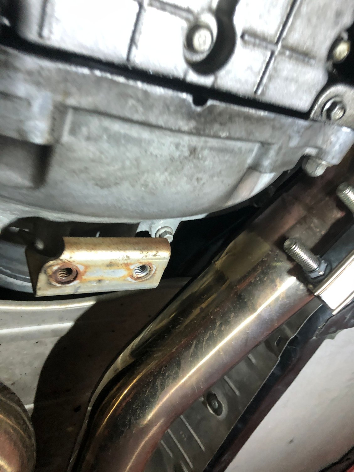

That bolt DEFINITELY sucks and even with the rear cradle lowered it takes a series of extensions and swivels.

The head of that bolt has a longer “top hat”.
More like the torque tube to bellhousing bolts not seen thus far.
I’d say it’s the one at 1 o’clock that most neglect to replace as its tough to access. You won’t see it though with the exhaust h-pipe still in the way.

I know because I left that one out. And I got a squeaking sound at idle mostly that I chased forever exhaust related. That missing bolt held the wiring harness in place and that metal started rubbing on the bell housing making a vibrating squeaking noise that finally I tracked down. That was a few weeks of frustration and that missing bolt was it. Installed it and my world was correct again.
