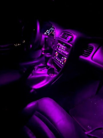

Mark, here is where I am at currently. Now granted all the interior is out now but the bulbs are still the same. I have so many questions smh. One thing I want to ask is, on the picture of the cargo light housing, I am assuming you simply wired in a 194 harness like you just sent me?
Yes everyone, I know it looks purple but it's not, it is more like magenta, or a pinkish color

I feel like what you have would be perfect if you could add just a little more blue to it. There are a lot of people who would consider the light in that picture to be purple, but I totally understand what you're saying. I used to be a theatrical lighting designer. When dealing with the additive property of light, you'll get the shade of purple that you're looking for if you can add just a little bit of blue in there. I'm not sure how many LEDs you have in each cluster. If they are all the same magenta color (as apposed to different colors mixed together to create that color), you might be able to wire a single blue LED in with each cluster to get the results you want.
There is another option that you might be happy with. As I mentioned, I used to work in theatrical lighting. The old school way to get the color you want is to use color filter "gels". This is more like tinting film than actual gel. You could switch everything to white LED, and then wrap them in color gels. You can get a gel sample book (that will contain MANY different color gels). You can then try test each one by holding it over a white LED in your car. Once you get the exact shade you want, you can then order a sheet of that specific gel color. Some companies that make these theatrical lighting gels are Roscolux (sometimes called Rosco) or Lee. They come in fairly large sheets, and you can then cut them to size. It would be easy to install inside the reflector of your map lights. In addition, you could simply wrap some of the gel around the footlight LEDs. It might look a bit DIY if someone actually sticks their head up in the footwell, but it should give you the overall effect you're looking for. The one note I have about this method is that Purple is a HIGHLY saturated color, so the light intensity may not be as bright as you'll get with just a straight LED. However, I really do think you'd be happy with the result.
