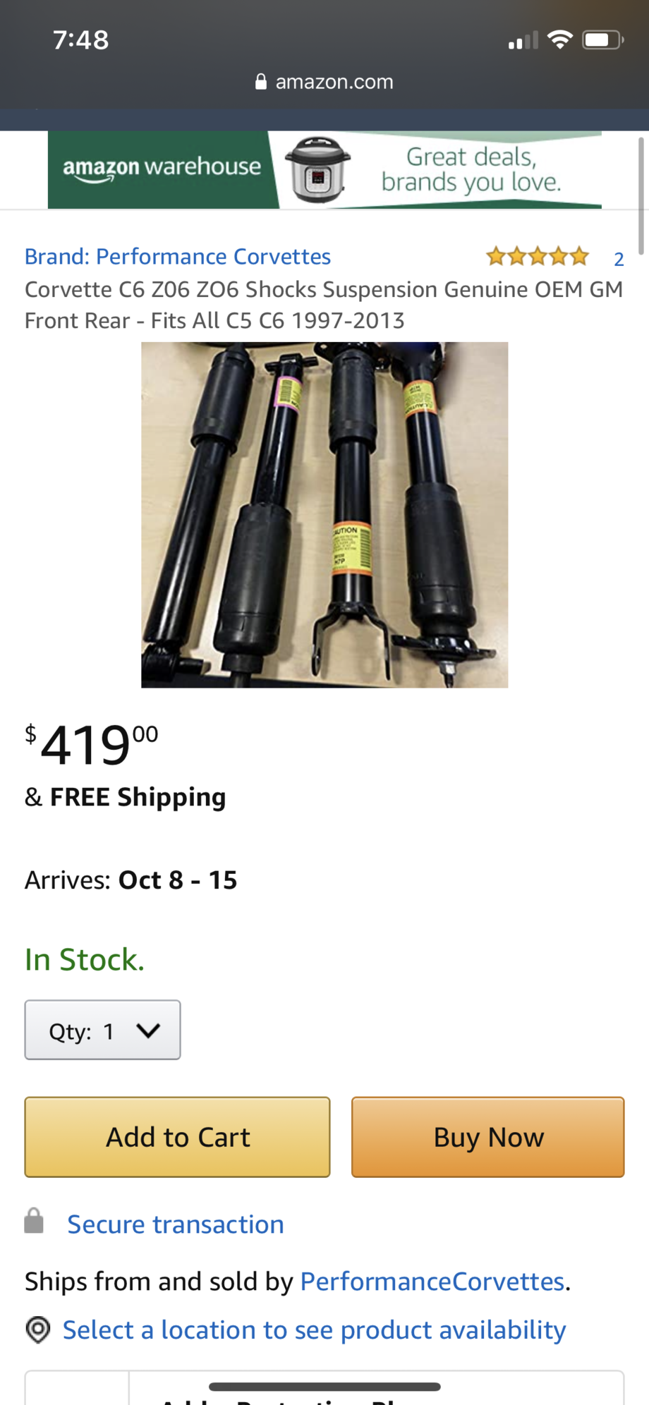

Anyone have the GM part numbers for the C6 Z06 shocks? I found these on Amazon.

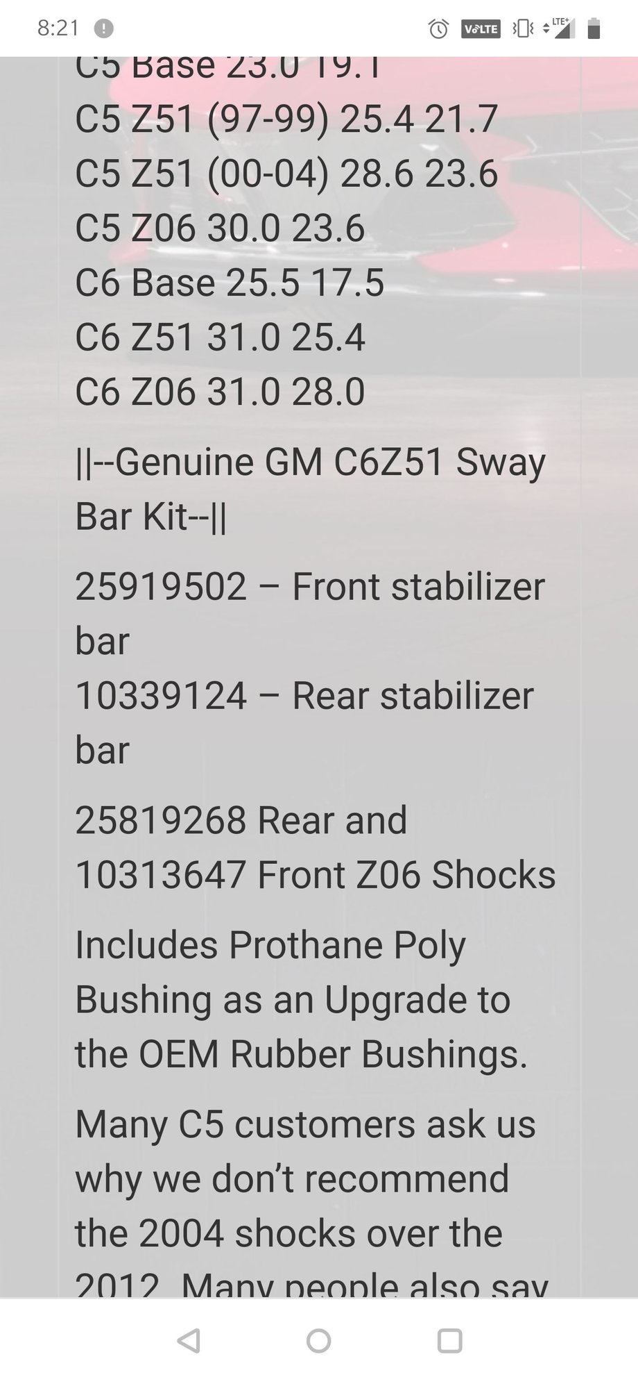

Posts: 106
Likes: 33
This pic has the part numbers you want for the C6Z06 shocks
