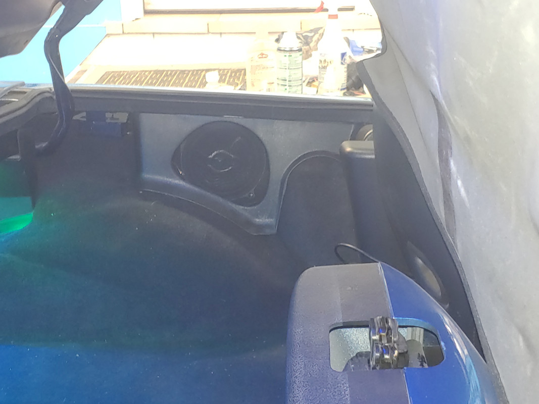

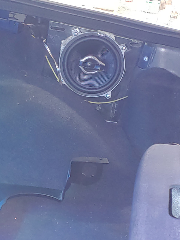

I have a 2002 Vert
I used 5.25 Hertz HCX 150 watt premium speakers + 300 watts rms 1/2 of an old school Rockford 600a4
The other 300 watts of the 600a4 is for the sub which is plenty.
They stick up 1/4-1/2 " but I packed insulation around them and the cover fits.
I used Hertz HCX 6x9s in the doors with a Rockford 500a2 500 watt rms amp
Component speakers don't do it for me won't take 500 watts rms.
Also added tweeters at the tops of the A pillars powered by a 200 watt Kicker compact amp
The 6x9s will fit if you gut a speaker cover and use it as a spacer.
You can hear this system quite loud and clear with good bass at 90 mph with the top down.
Had these Pyles before the Hertz HCXs

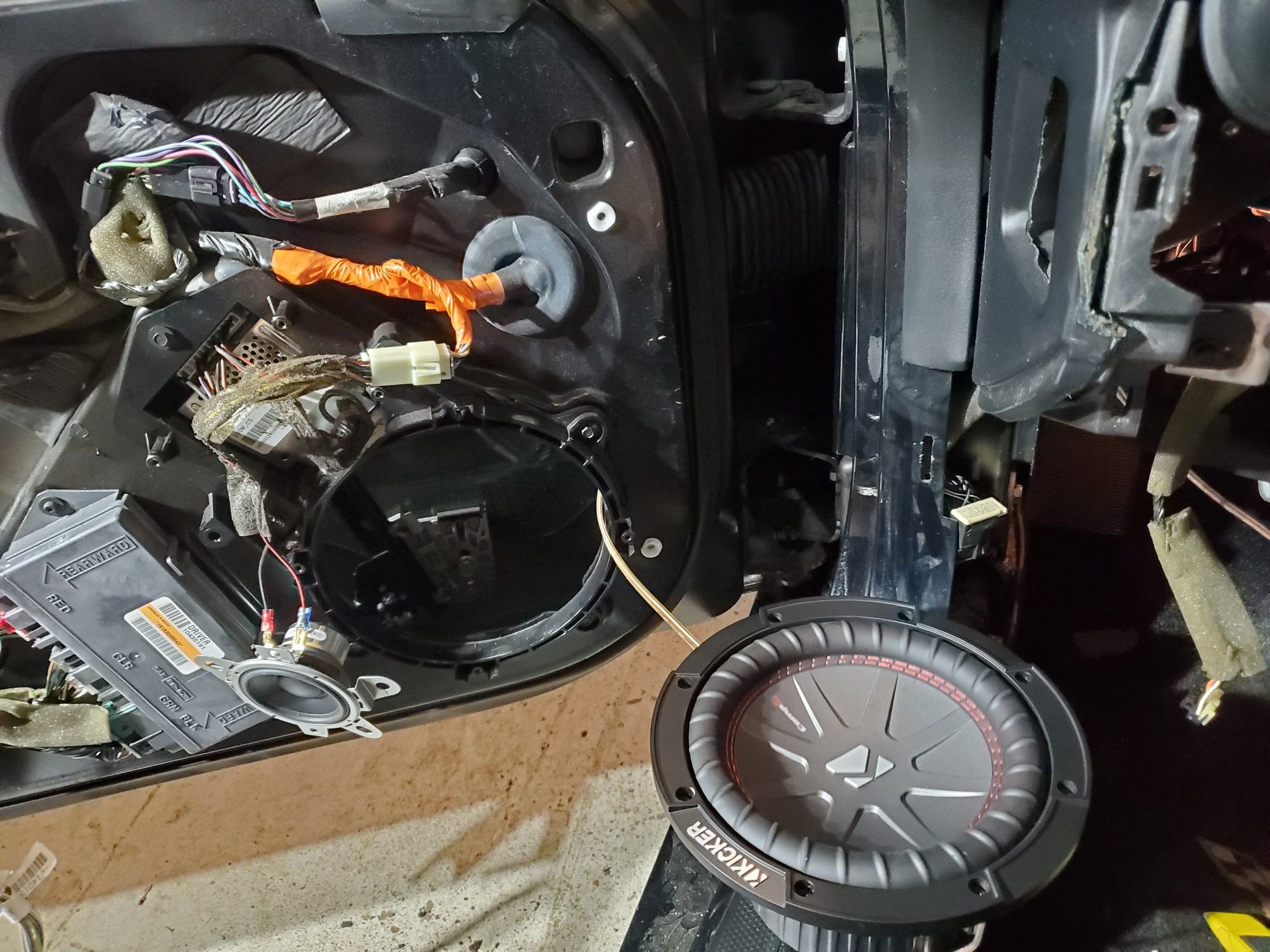

I just went through this myself.. put hertz in the rear.. but honestly, you don't really even need the rear speakers, they do so little.
I ended up putting 8" subs in the door and high quality audio frogs. You can check out my build here if you want.. everything fit behind the stock grills. https://www.corvetteforum.com/forums...s-in-door.html
