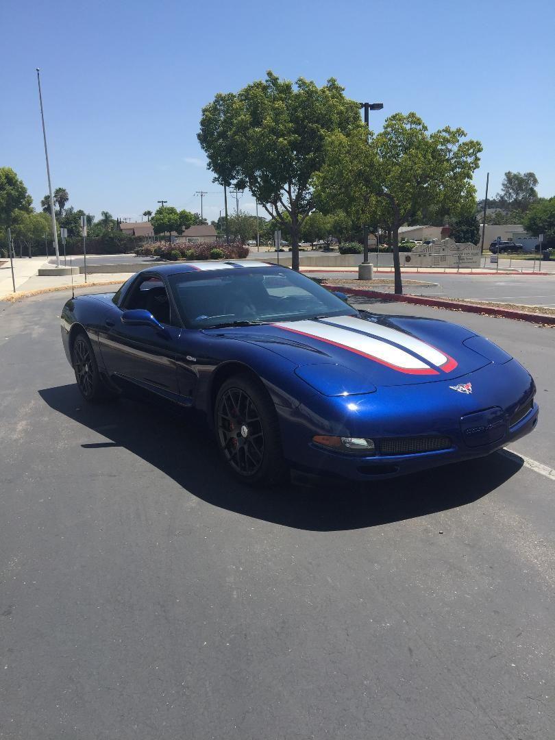

Default 04 z16
bought it 3 mo's ago $19,500 w/70k miles
been great so for far, had tune, w/cai, tightened up a lot of stuff including intake manifold
