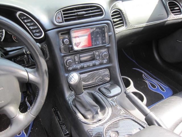

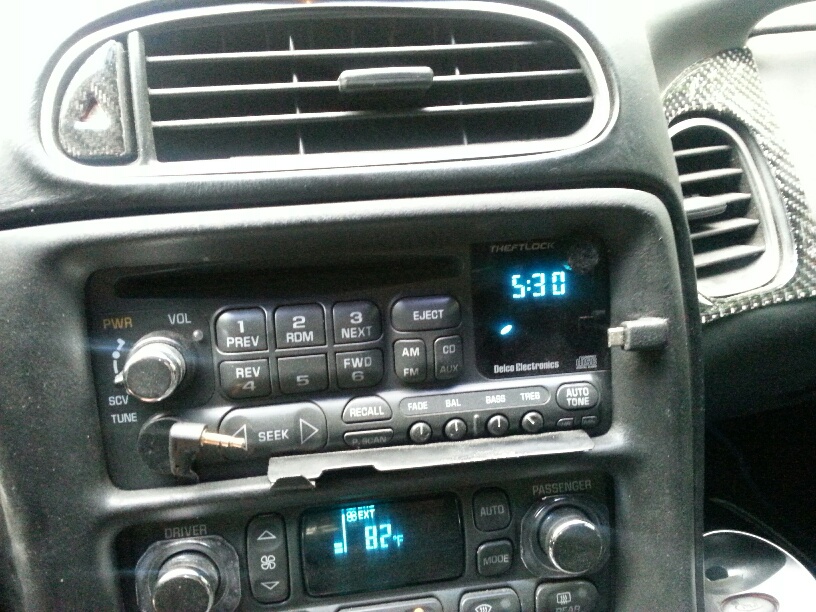

I'll just throw this out there, if you can solder for 5 bucks you can add a 3.5mm aux jack to your existing head unit and connect your phone thru that. I did this mod and it works great.
I did that before made it clip in
