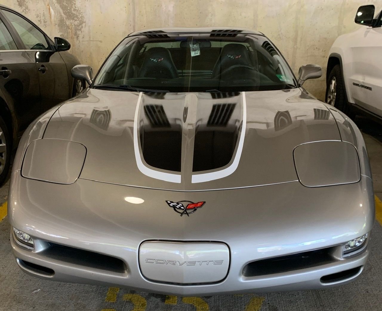

Giving some thought to adding some basic strips to the hood of my C5. Does anyone have any suggestions on where to purchase the decals? Looking for strips that will be made out of a thin film if possible. Something like what is pictured below or one that would extend below the hood line. Thanks

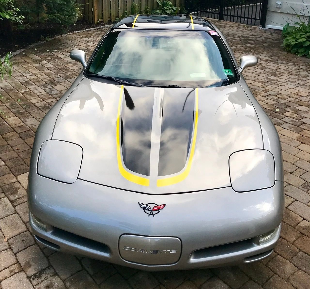

Sure did. Called Mike a couple of times to verify the printed instructions. I don’t think English is his native language, so I needed some further clarifications.
Used the wet method, which is a pleasure. most important thing is to measure and layout to the point that you question your sanity, then do it one more time.

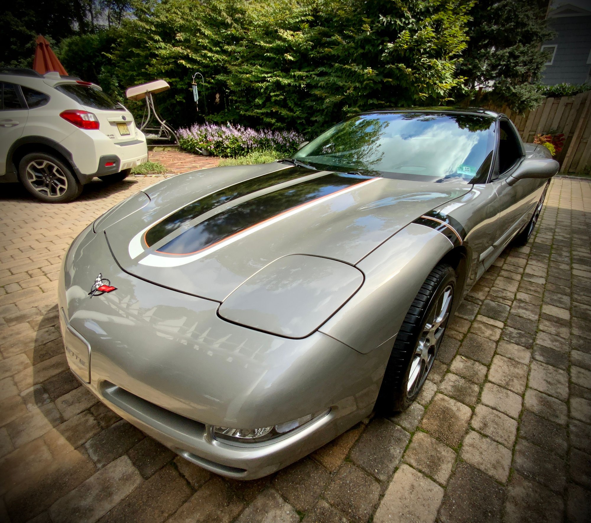

Go to vettestripes.com, and go into the C5 section. There’s a similar blue car like yours with I believe a silver and black stripe.
The problem with our (most) cars is that we don’t have a defined corner or center to mark off from. Hood sides end in curves, no matter how small, they are not hard corners. I used a lot of painter’s tape, measured many times, and more or less ‘decided’ where my corners would be. I used whatever I could as a reference point, then put tape in that area, and <then> got exact with fine line Sharpies. As far as parallel, what Mike does is instruct you to leave the waste sections of the large stripes as spacers, so it’s pretty fool proof. If you get your centers and other reference points right, it will be great.
I got tired of the yellow!
