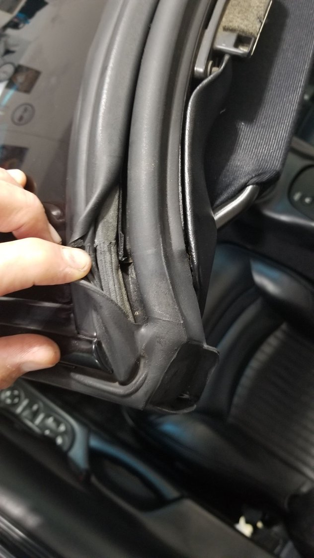

The weatherstripping at both corners of the windshield is ripped..i know this part is insane expensive..anyone have a fix for it

And is there a water channel that runs down it to the floor..there is a hole there. Pulled and cleaned the udders on the driver side..ill do the other side. Wondering if I can glue some rubber in there to seal it up. 800 bucks for a new one.

Going to RTV it..play with window adjustment, etc...And not drive it in the friggin rain.

Considering I replaced all the weatherstrip in my 92..and it still leaked a little ..and was expensive as hell..I'll give it a try. I don't drive in the rain 90%.

I had a tear in the weatherstripping on my 2003 and this is what I used:
Permatex Adhesive Sealant, Black Silicone Part #81158
Can be found at many auto parts stores and works great to reattach the torn pieces.

I goobed some RTV black in there..see how that works.
