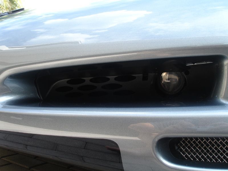

I opted to drill about 4-1” holes in each one, saved the trouble of replacing. Put a screen in the intake. Looks nice. But doesn’t add any additional cooling air, I have a Raid air filter set up.

I'm installing them in an attempt to slightly lower coolant temp as opposed to intake temp. Thanks for the pic. I have seen cars with the hole saw method and really didn't like it personally.

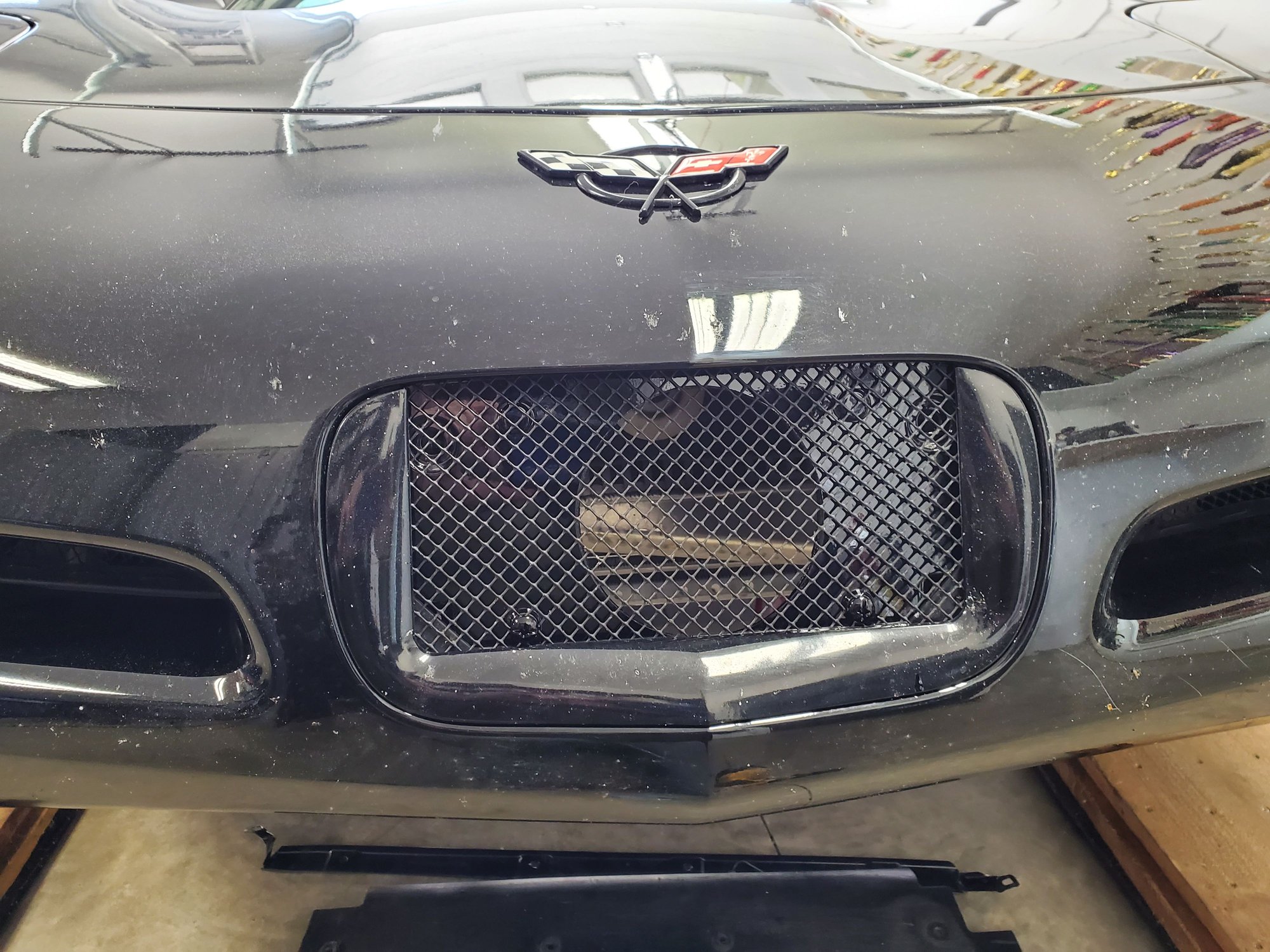

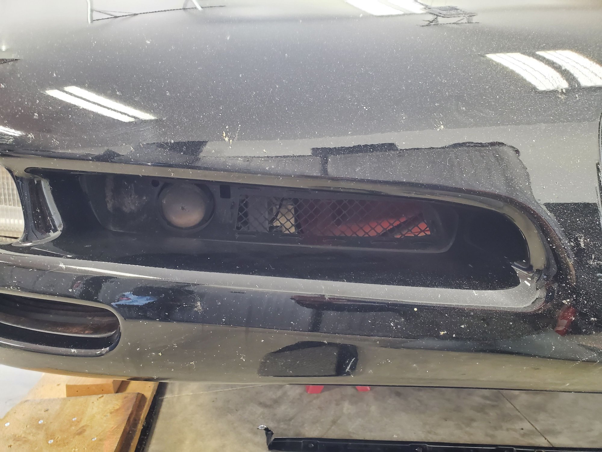

My black 99 coupe had these already installed. The car is supercharged so without a doubt it help lower temperatures. I've also cut a big hole in where the front license plate normally goes.
Sorry, the car was not clean when I took these pictures.

Where did you get the mesh screeon & license pocket cover? I have 97 C5 base I bought a used zo6 oem air cleaner and put on only the top air cleaner lid which has a big hole. My air cleaner cover has no hole except i did see like 3 round holes on both ends on underside. I figure If i did what you did there least I will get better air flow into air cleaner.

Sorry, the screen and plate surround was on the car when I purchased the car so I don't know where they came from. Then I hit a possum and the front bumper had to be replaced. That's why I had to cut another hole.

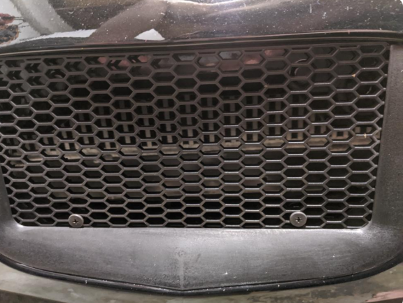

It's an OEM license plate holder. You can get them all day on eBay for about $30. Then you just find a mesh of your liking, cut it to fit (size of a license plate and it slides right in) and use the lower license plate screws to hold it in. I put one together for myself months ago with a plastic honeycomb grille and have plenty of leftover material to make about 10 more "screens" if it catches a rock or something one day. Super easy to do. Here's another dirty car picture for your viewing pleasure:

Thats what I wanted to see thank you. I like them. I'm gonna get em.

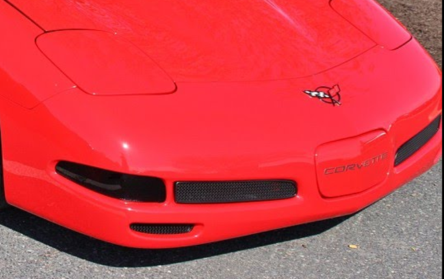

If you want the functionality, but end up not liking the look, you can add race mesh screens. I removed the cold air screens to install a Vararam CAI and didn't like that I could see some of the hardware of the Vararam when I got down to eye level. So I put race mesh screens over both the cold air and brake cooling vents. The large ones are held in place with double-sided velcro so they stay in place but I can still remove to clean or get to the fog lights.

better close up...
