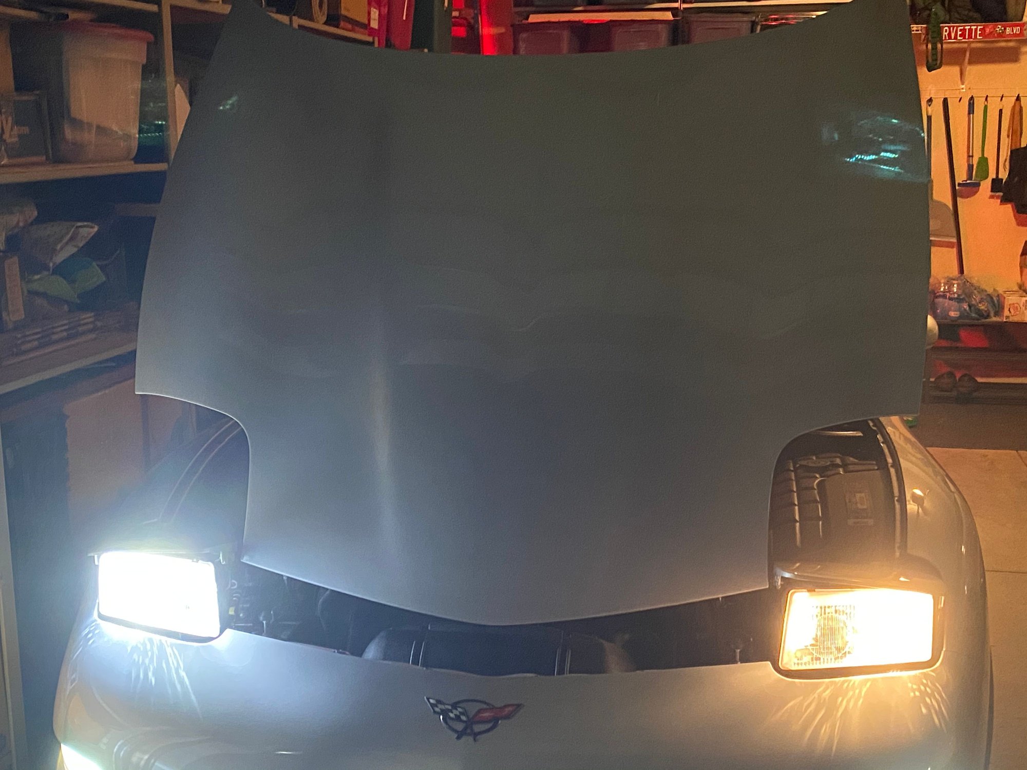

Default Super Bright LEDs
Extremely happy with the product and customer service of super bright LEDs.com.
Mine have a lifetime warranty.
Great difference from stock
This photo comparison doesn’t do it justice. Not going to argue but I feel I have enough short and long throw of light on the road.
