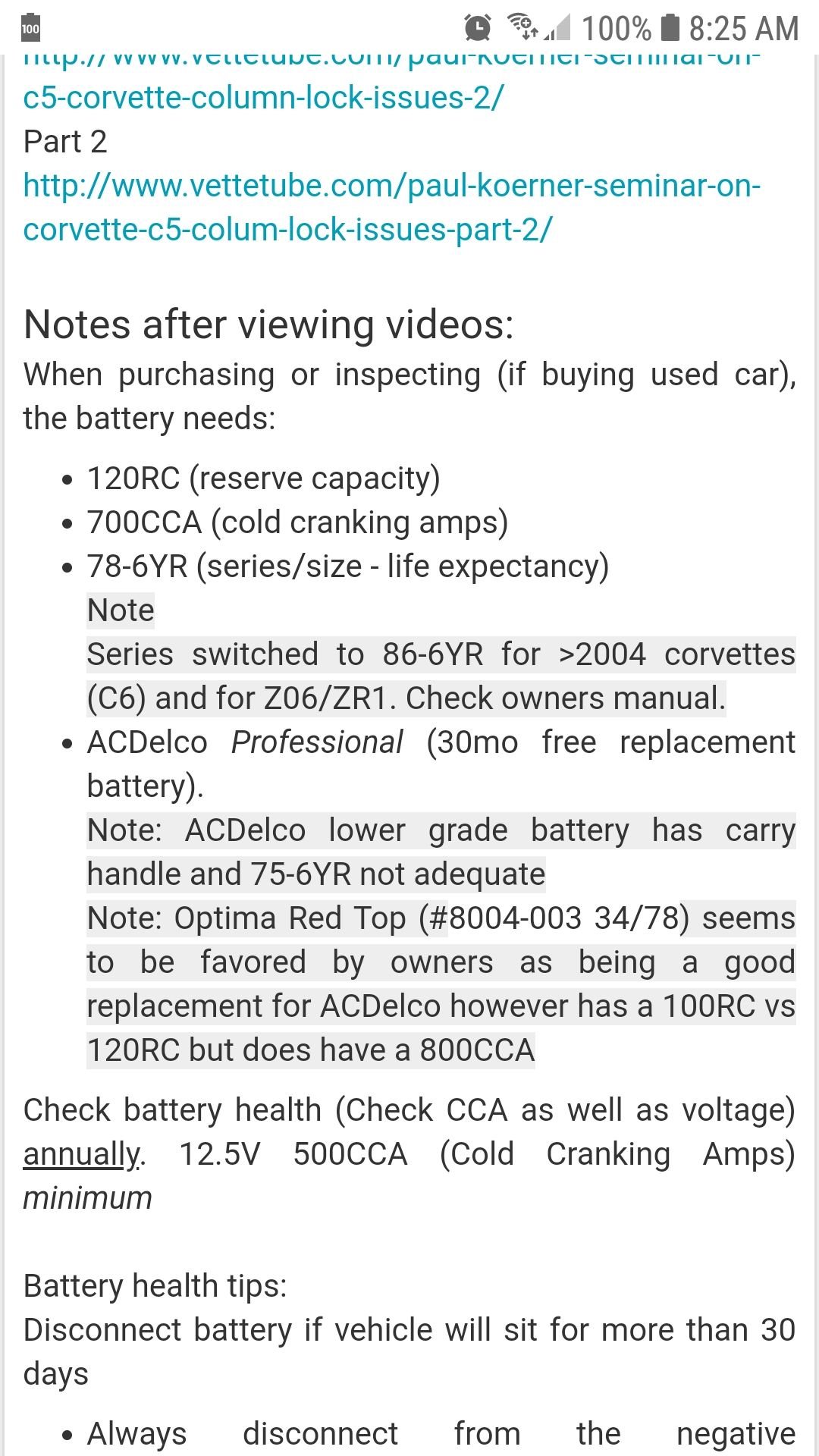

The C5 was designed to operate with a 120 Reserve Capacity battery. Hope this helps..
Your side post battery would be a group size 78

Default Thanks everyone !
Thanks Smoken1 !
This is exactly what I was looking for, and I was able to find the original post I saw yesterday. It just wasn't on the forum, but on Corvette blog post. I'll share a screenshot so others can see as well if the question comes up again.
