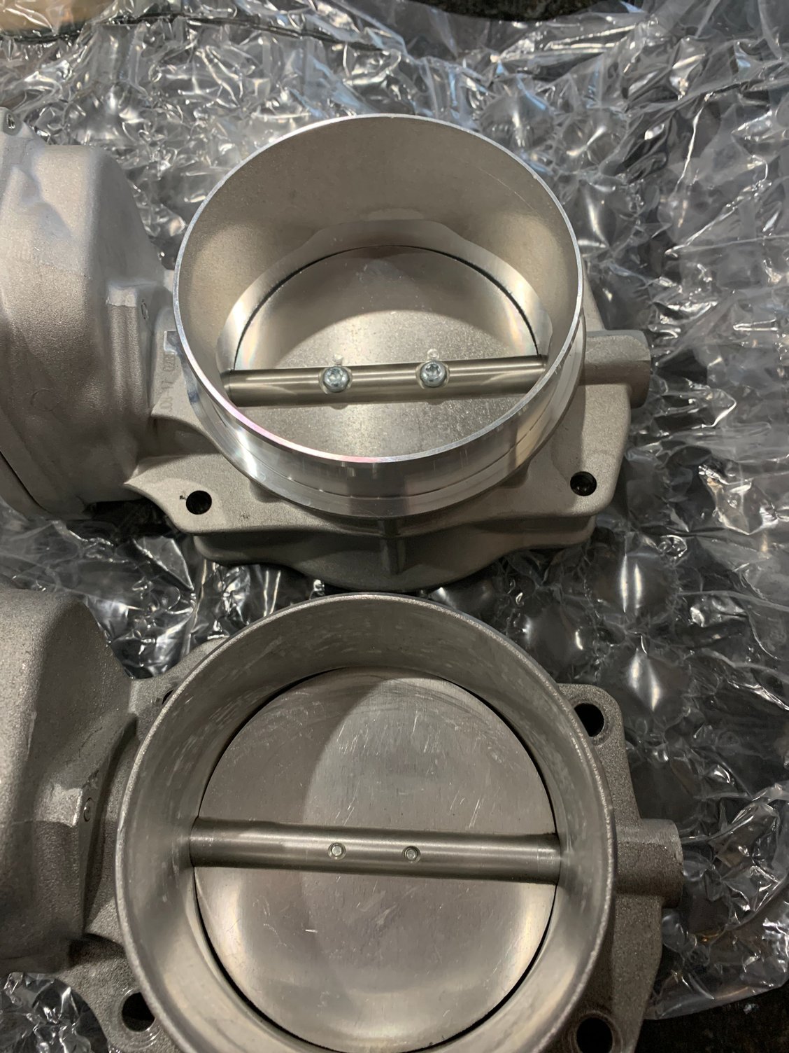

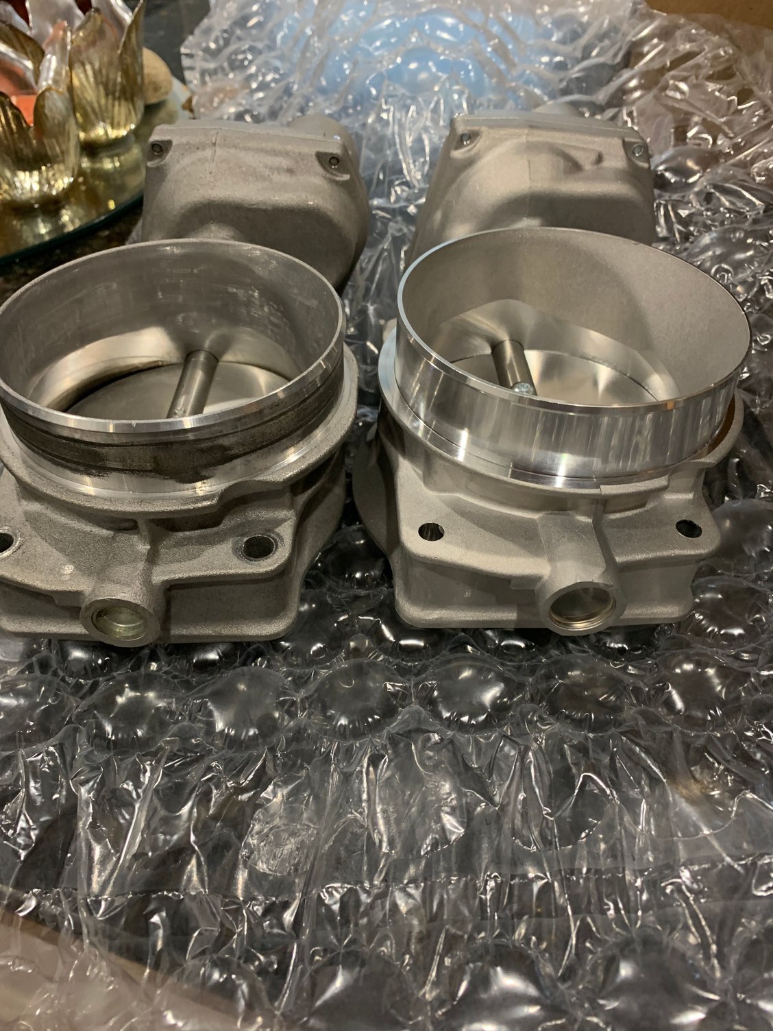

I was perusing LS parts and always keep my eyes out for elusive LS2 throttle bodies. I came across these new LS2 throttle bodies - for what seems to be an almost too good to be true price. So I ordered one out of curiosity and to have a spare on the shelf (I am the typical car guy parts hoarder). I compared it to my first LS2 TB that didn't play well with my car and it's clearly a new non-GM casting and is manufactured by TRQ Autoparts. I am sure it's a Chinese product, but none the less here is the link if anyone is interested. I am keeping it and next time I have my intake apart I will install it to see what it does.

The TB on my car now is a remanufactured GM TB by Cardone that I found on Oreillys website and it was the last one in stock anywhere. It’s been absolutely fine.
So I wondered if I was just buying a different house brand of the same part. But definitely not.

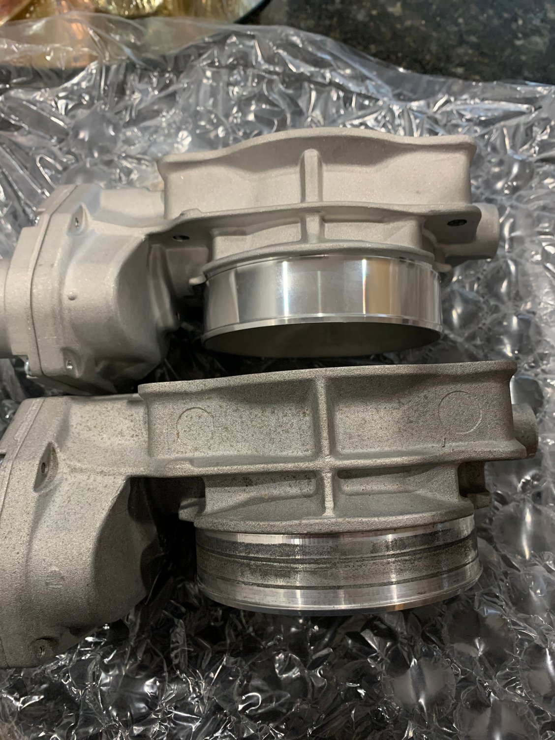

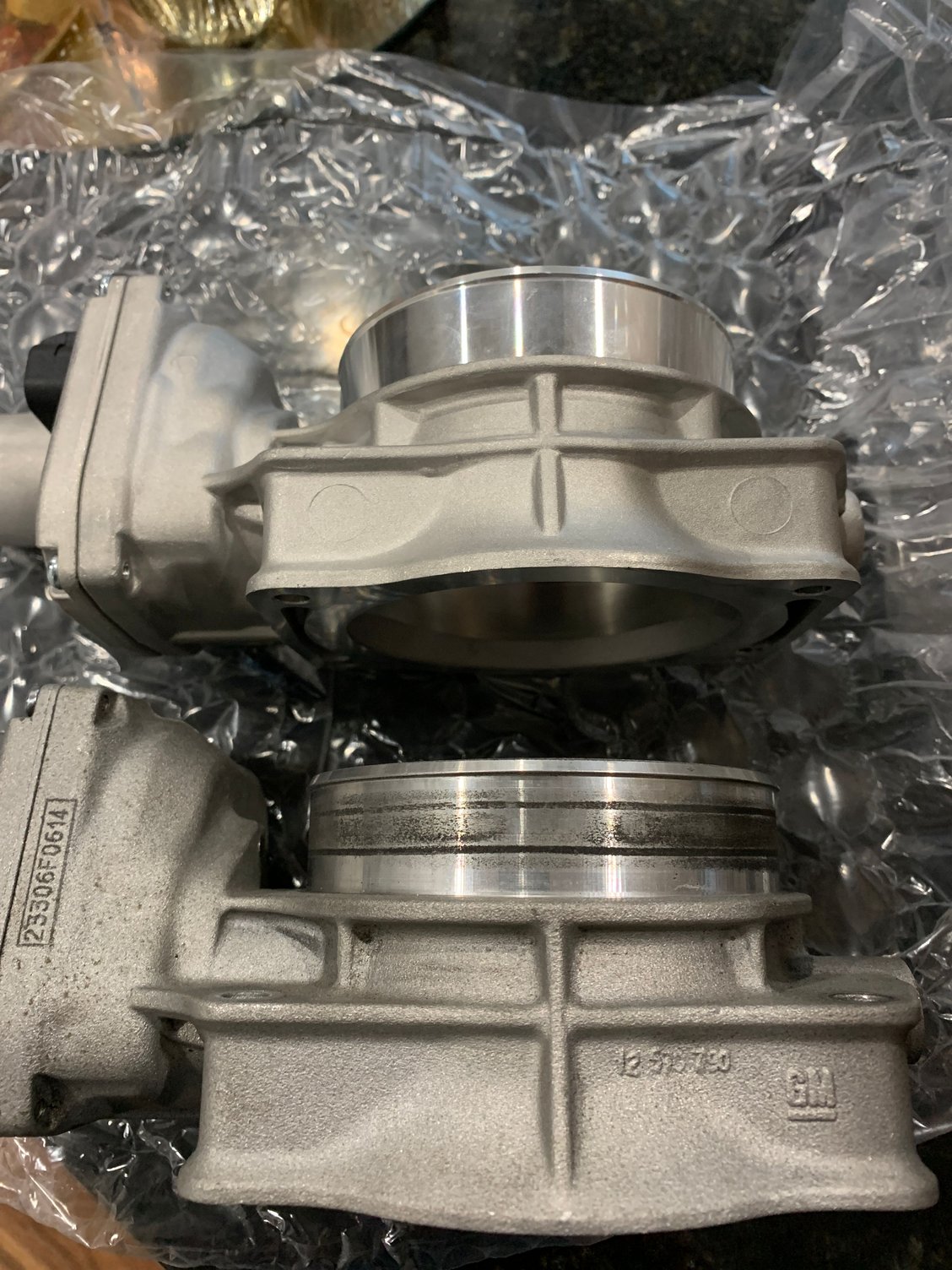

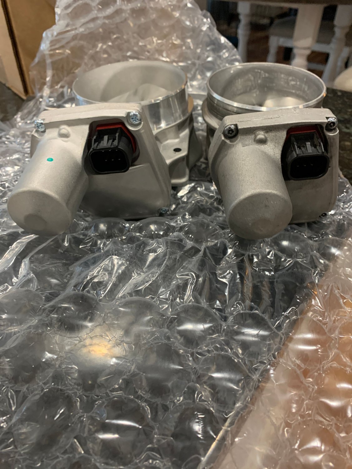

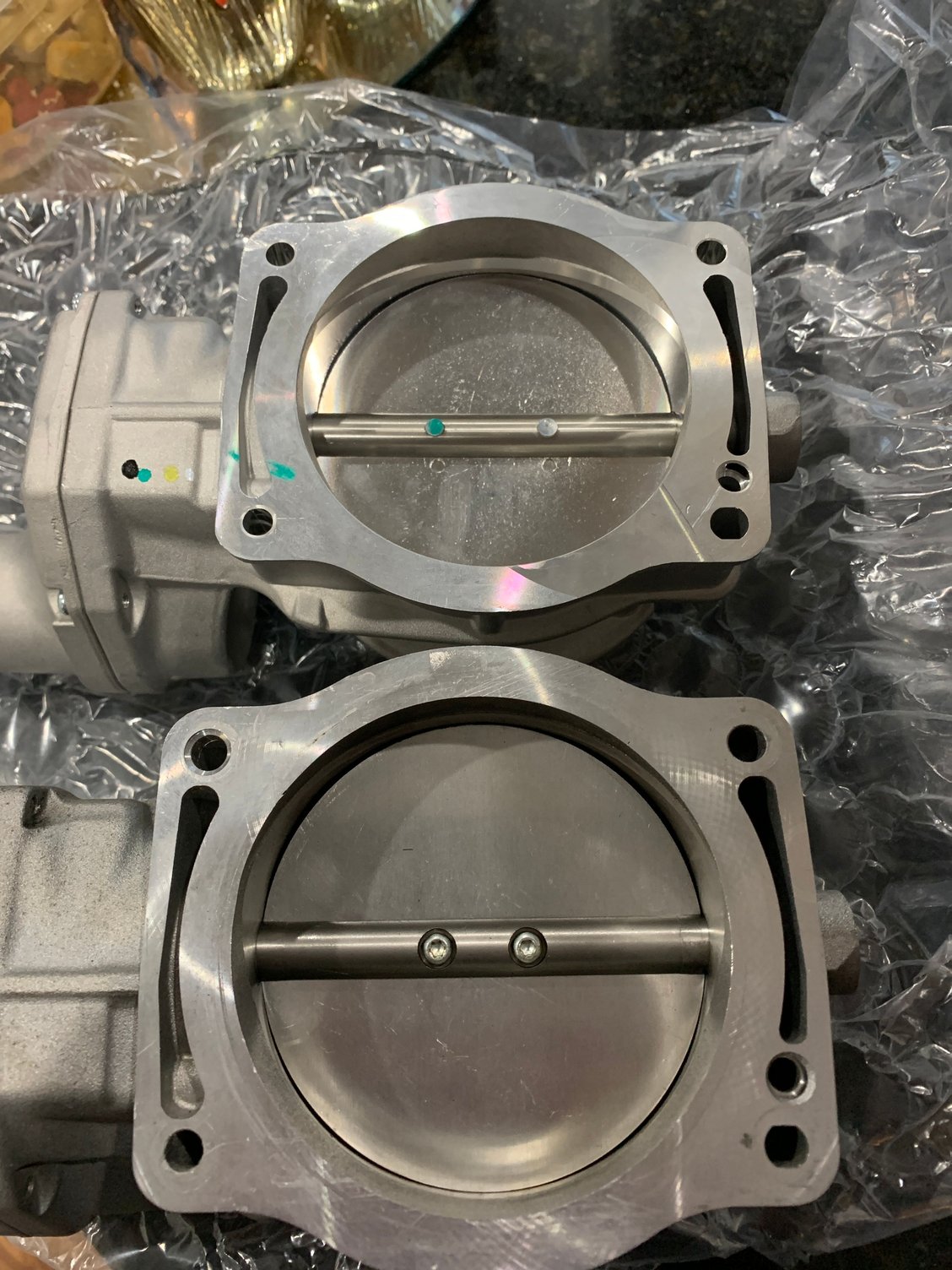

so here are to e side by side comparisons of a GM TB and the TRQ TB. The GM is the bottom unit in the pictures
Ultimately if the ChinaRona Throttle Body works as designed its a hell of a deal. When I have time in the next week or two I’ll remove my remanufactured GM TB and see if this thing throws any codes etc.

​​​​​​It's a real pain in the *** to source a decent LS2 TB. I bought the GM TB in the picture from a forum member who sells a quite a few of them on here and my tuner said it was hanging open and recommended replacing it. I happened to find the one single Oreilly Auto / Cardone LS2 TB in the country and felt like I hit the lottery in June of this year. The one on the pictures may just need cleaned up in the way Ron described above. But I was happy to find it.
