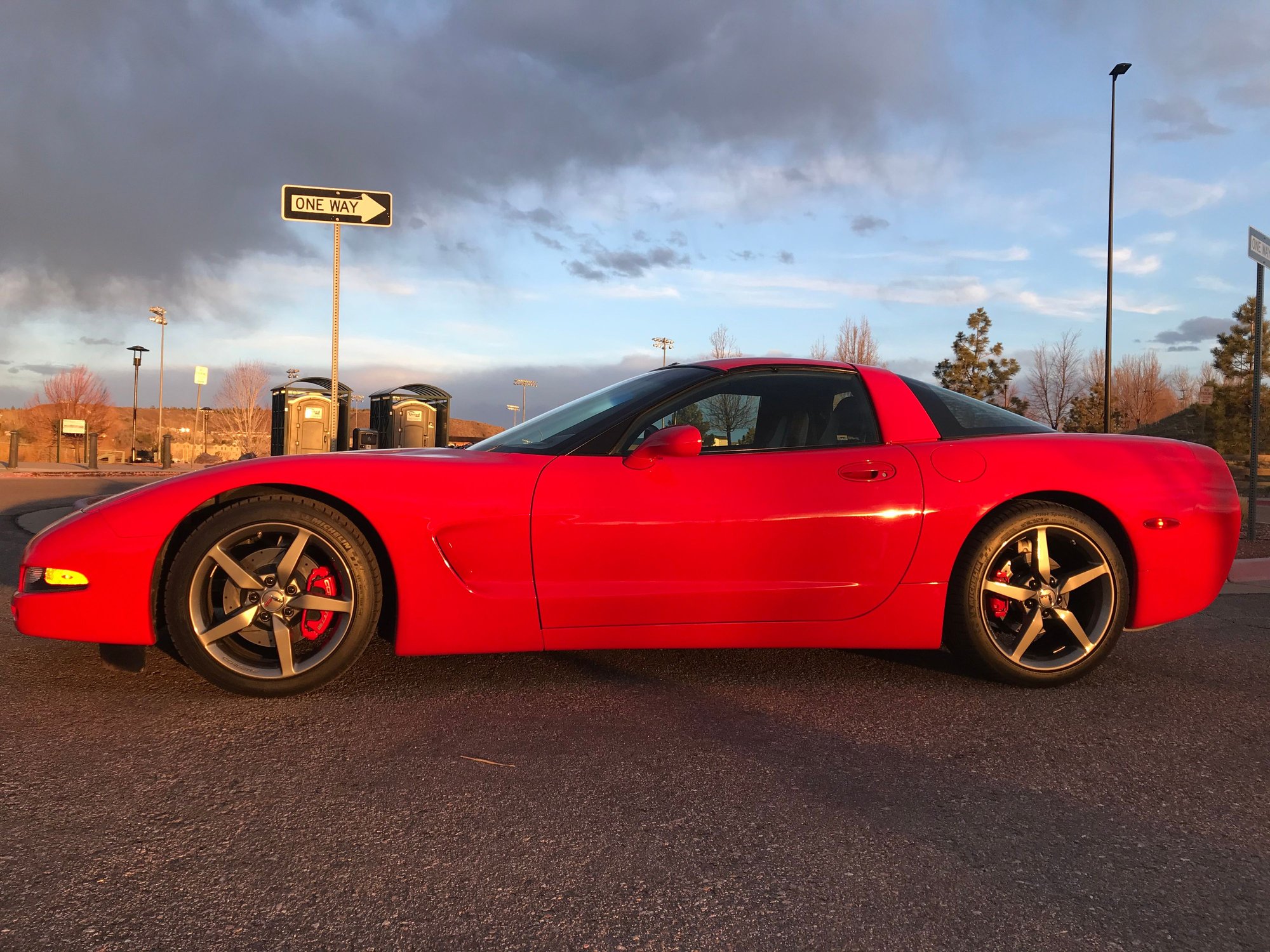

I have those wheels. Used 3/4” spacer on the rear and trimmed the lugs.

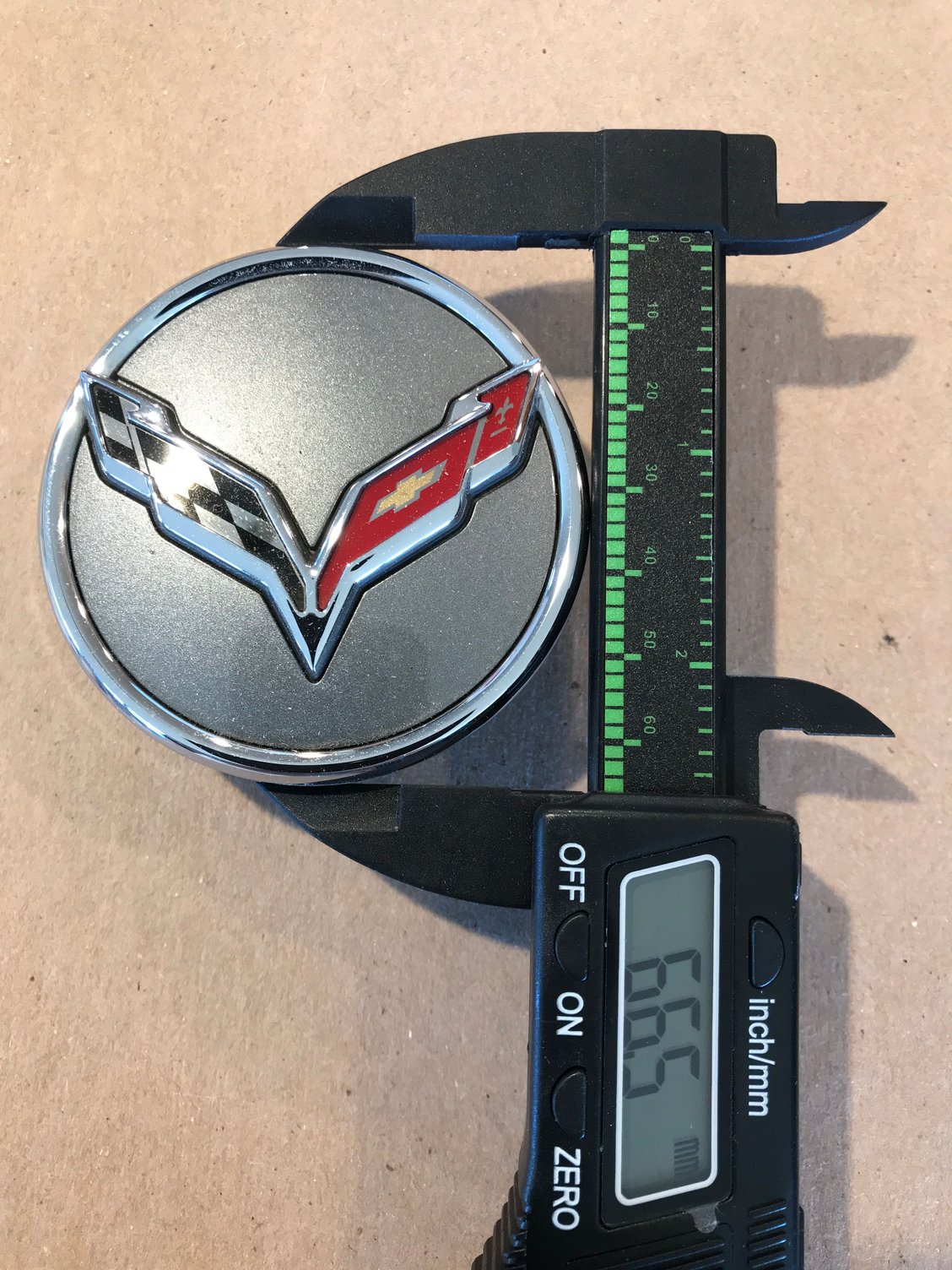

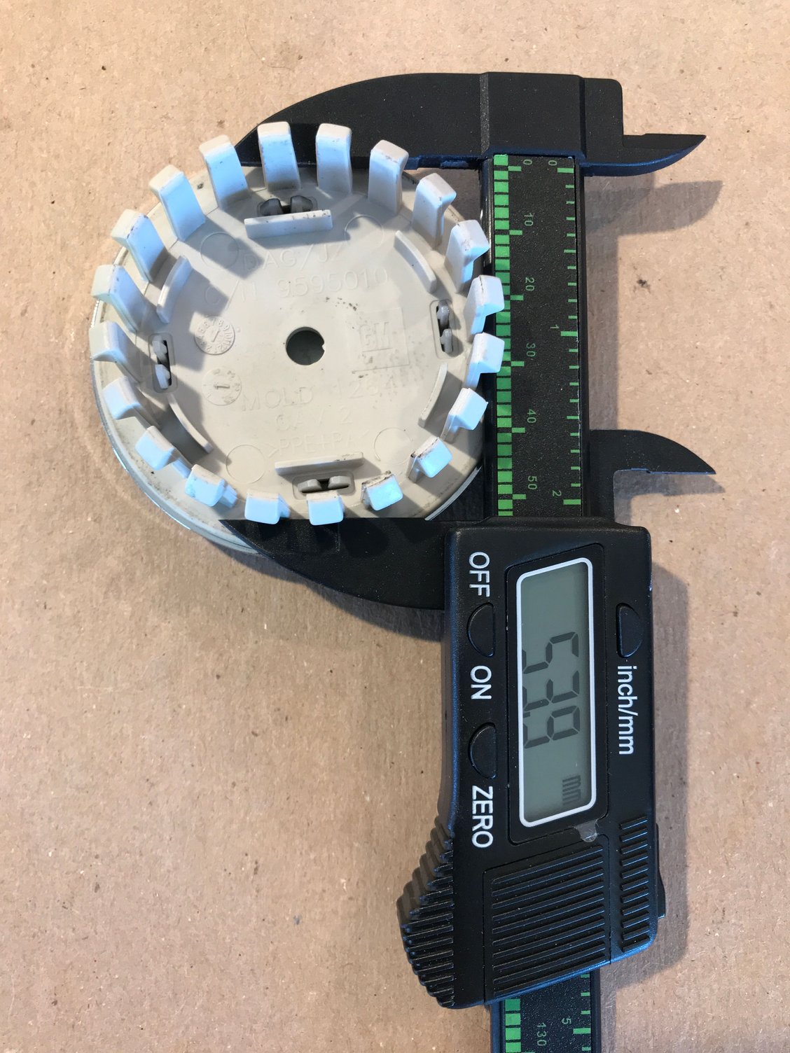

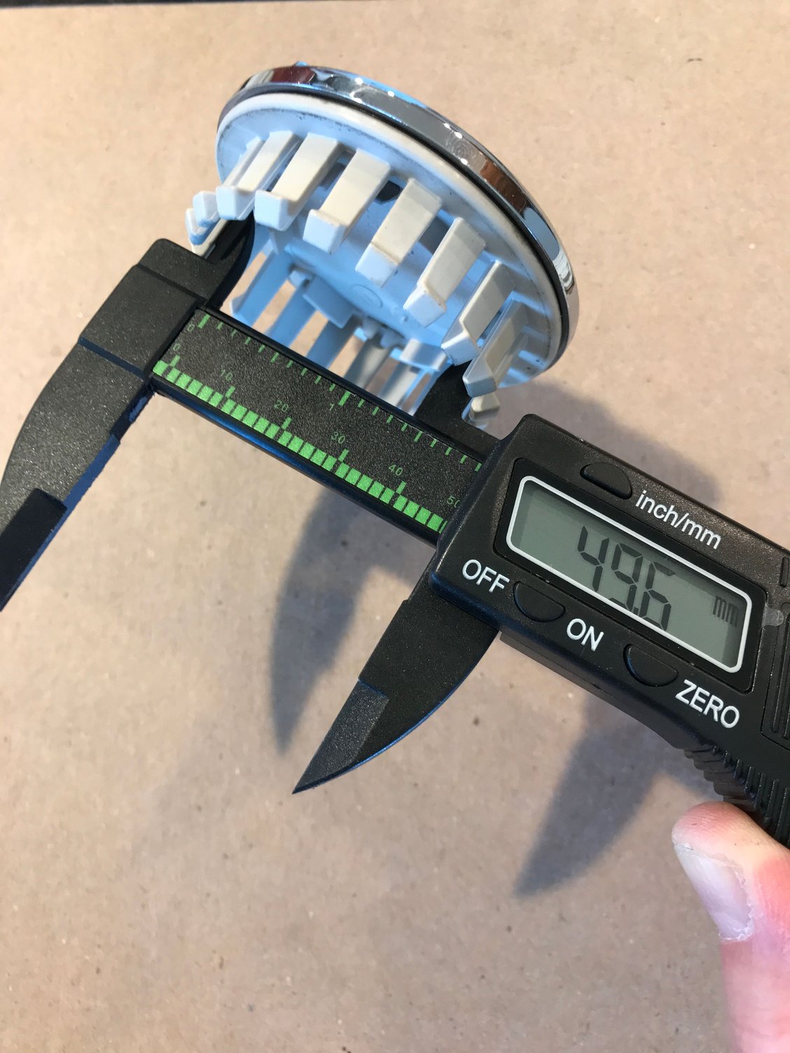

Well, I bought those c7 wheels. Now I need a 20mm hub centric adapter for the rear. (if this is the wrong term, sorry) Looking for a quality one, already painted black. Also, are center caps a generic size?
That looks fantastic. I could see going down this road someday!
Nicely done.

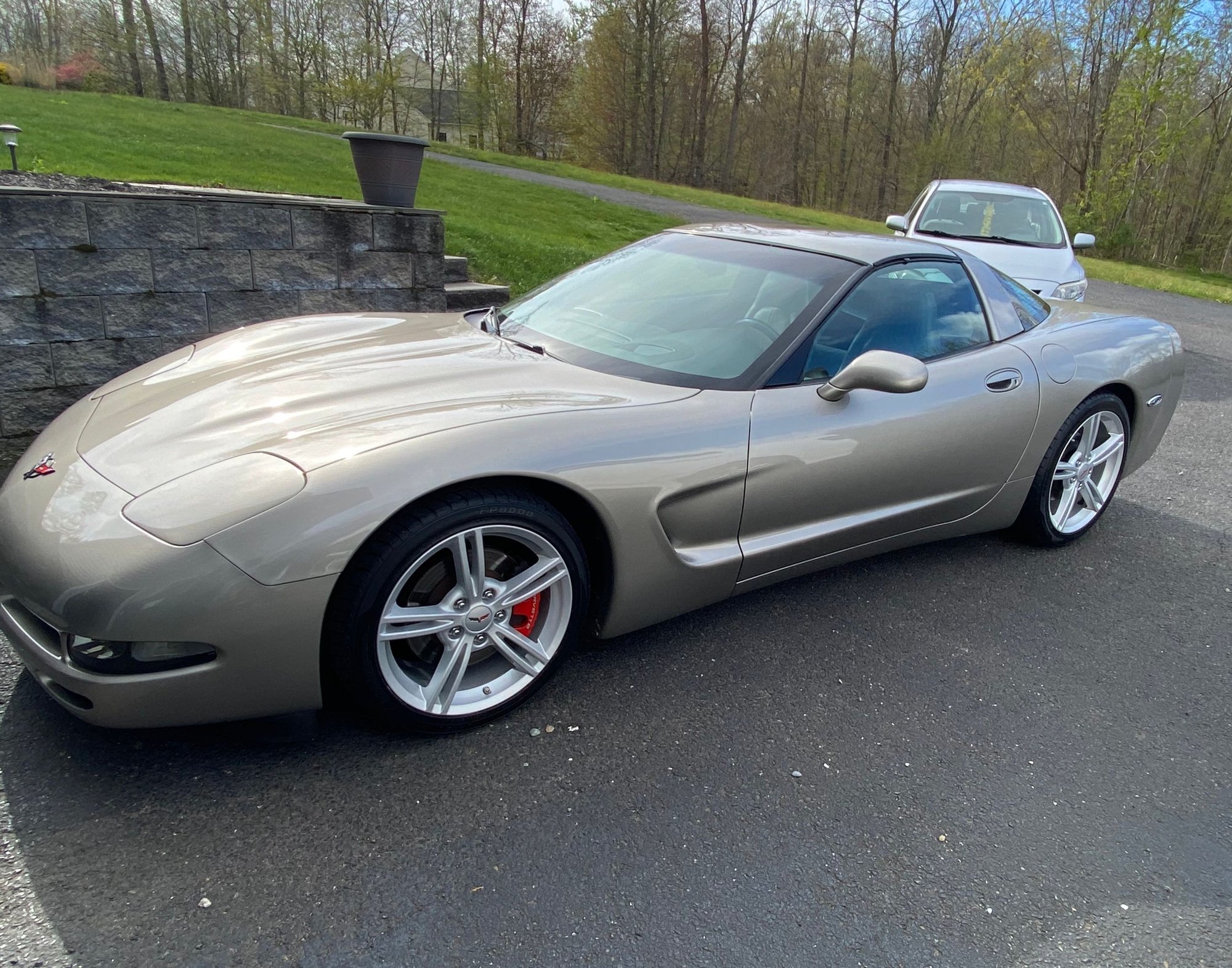

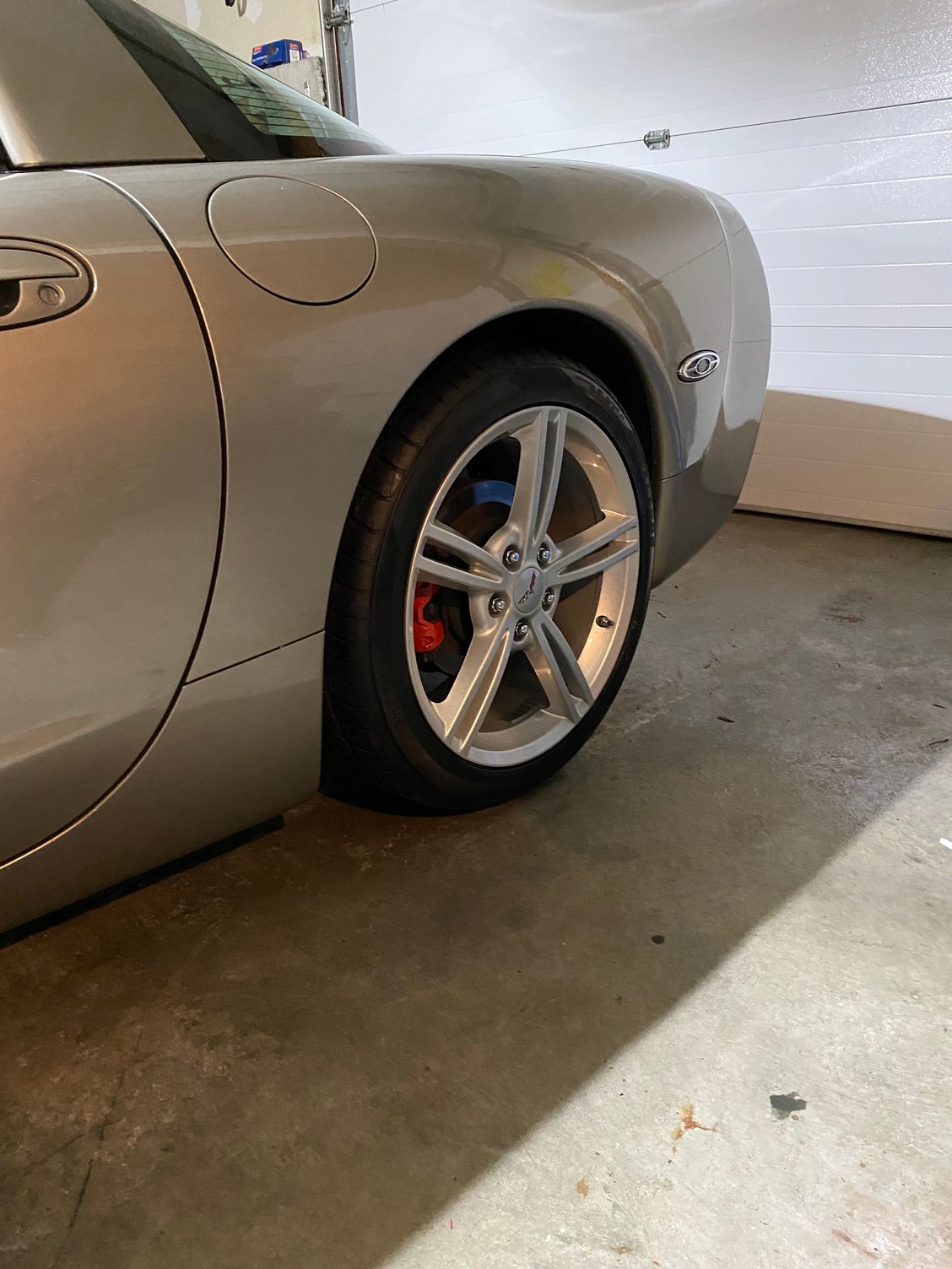

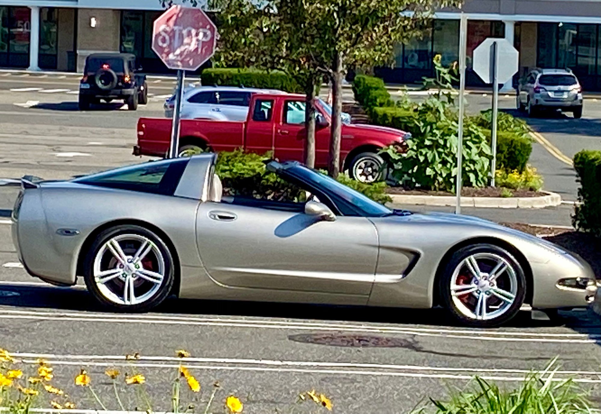

I've got the new wheels on now. Havent driven it though (cars put away for the winter) Car looks very 4x4 right now, hasn't settled down after jacking each corner up. Put my big boy pants on and trimmed the wheel lugs.
Had trouble updoading the pics
To c7 wheels on c5

Rule #1: It didn’t happen unless proven with photos.
Old Jan 12, 2021 | 05:47 PM
USAZR1's Avatar
USAZR1
Joined: Jan 2000
Posts: 10,405
Likes: 3,408
From: Central TX
Dave, those C7 wheels look really good on your Vert.
Old Jan 12, 2021 | 05:55 PM
rockymountain1999's Avatar
rockymountain1999
Joined: Aug 2019
Posts: 412
Likes: 205
From: Castle Rock, CO.
2021 C6 of the Year Finalist - Modified
Yep those look good!
