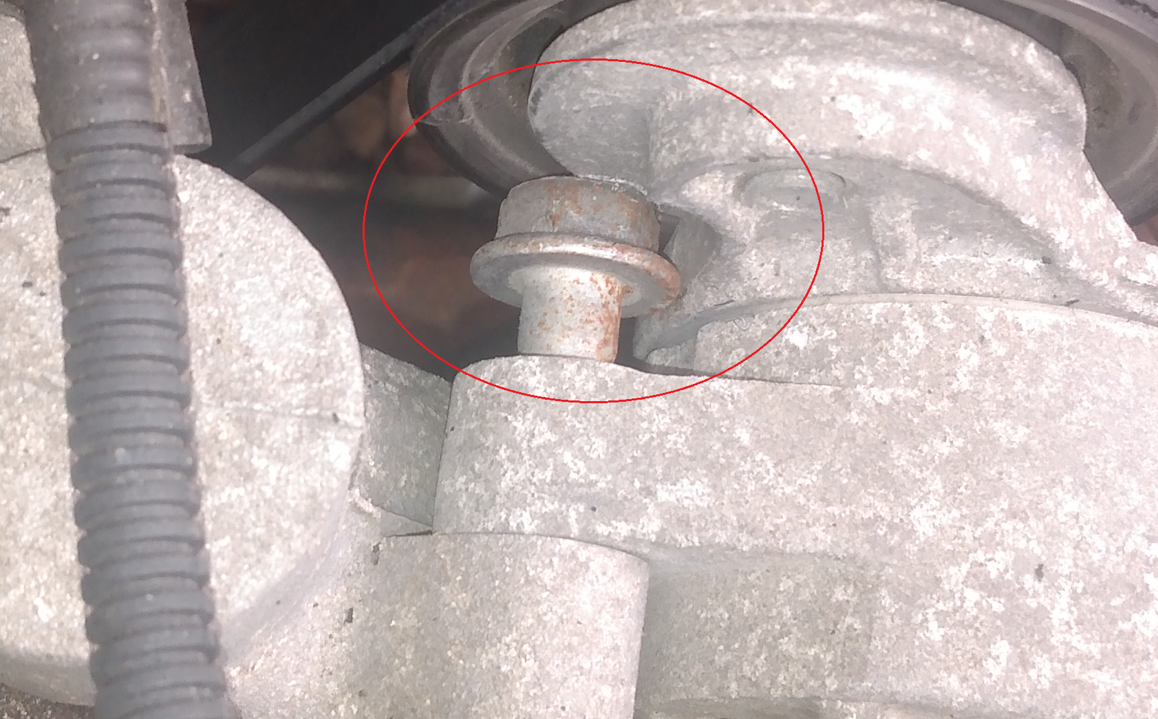

2003 C5 tensioner bolt
Hi folks, I am a lifelong enthusiast but never owned a corvette and just finished a stint as a diesel owner. This 2003 50th Anniversary was parked on a pacific coast side street for a long time, has 144k miles and has alot of rusty parts. This is the tensioner bolt, it is making a squeaking sound when it runs and as you can see has backtracked into the tensioner itself and neither can move. It runs fine but the squeak drew my attention. I have not found a tool that can get in there to turn the bolt. Ideas? Thank you!

Maybe unbolt the pulley to allow the tensioner to move out of the way?

[edited] Are you suggesting unbolting the pully wheel itself? I did not think I could do that with tension on it.

Take the belt off and you may be able to move the tensioner where you need it to be for the to access the bolt.

We were advised to soak the bolt in a different kind of penetrating oil called Blaster than we tried before and it finally moved out of the way. Problem solved.
