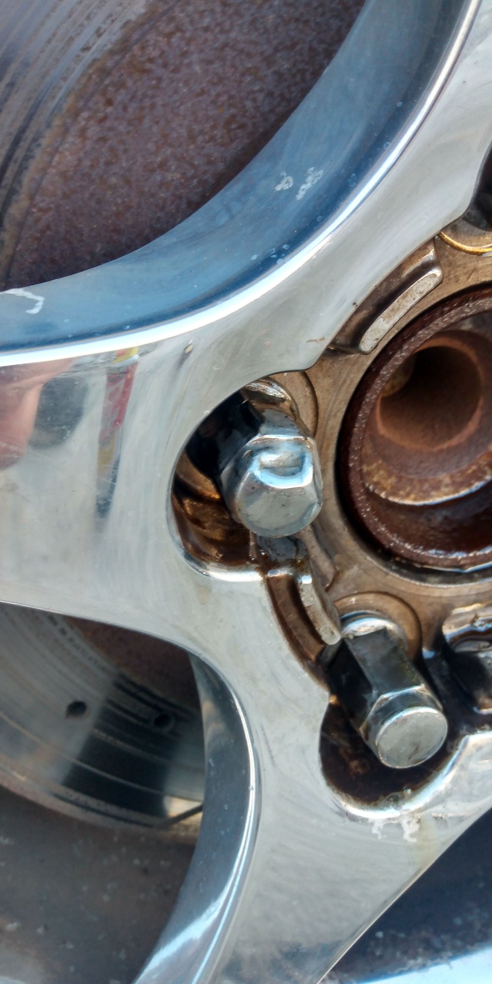

Hey folks Happy New year I just noticed this deformed lug does anyone recommend hammering an 18 mm socket onto it? The 19 mm that works on all the other ones just slips. And it's been on there a while. I just soaked it with Blaster.

I have successfully removed wheel lock by hammering a lightly smaller 12 point socket on to them. Snap On and others make socket type tools for removing locks with missing keys. I suspect the same method will work on your lug.

A lot of times that style of lugnut has a tin chrome cover over a steel lugnut. If it were me I would chisel off that chrome cap since it's ruined anyways. Get down to the lug nut and put the tightest 6 point socket on here you can find even if it's American.

Given the dent in the end of the "nut", it has to be a cap.

Beat a smaller socket onto it and impact it off. Problem solved.

I had a lug nut that did the same. I pounded the impact socket on it and got it off. It was harder to get the lug nut out of the socket than off of the stud.

That's why I think it's easier to peel that tin crap off and just use a good quality 6 point socket on an impact. It will come off. The only time I've done the socket pounding thing is if it's a locking lug with no key.
I've never rounded off a lug nut in my life. It will either come off or the stud will break. If the stud breaks it wasn't meant to be.
