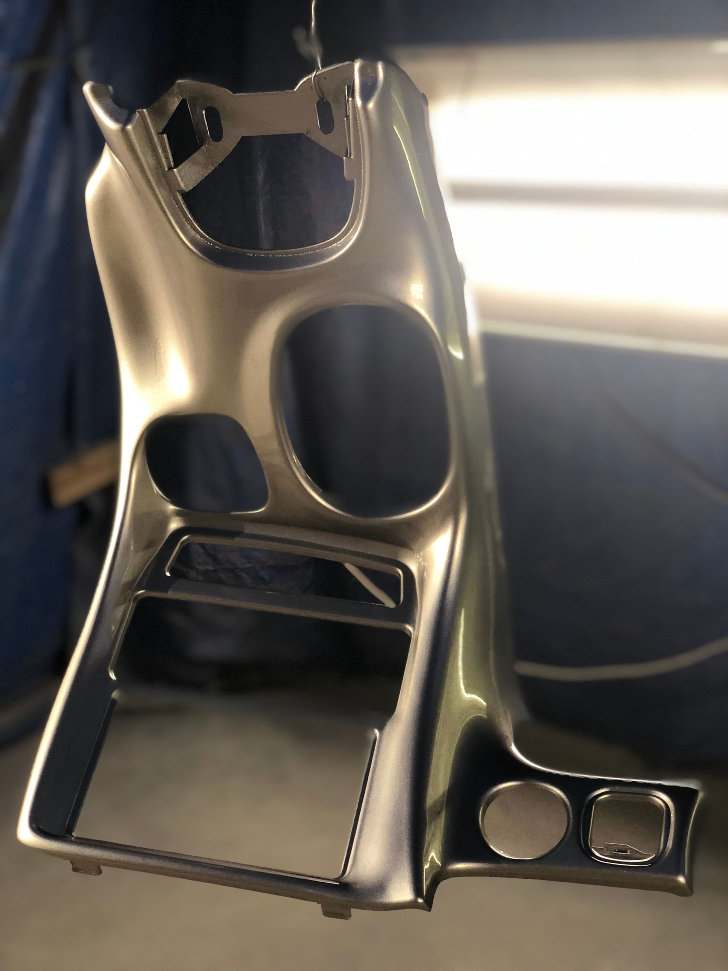

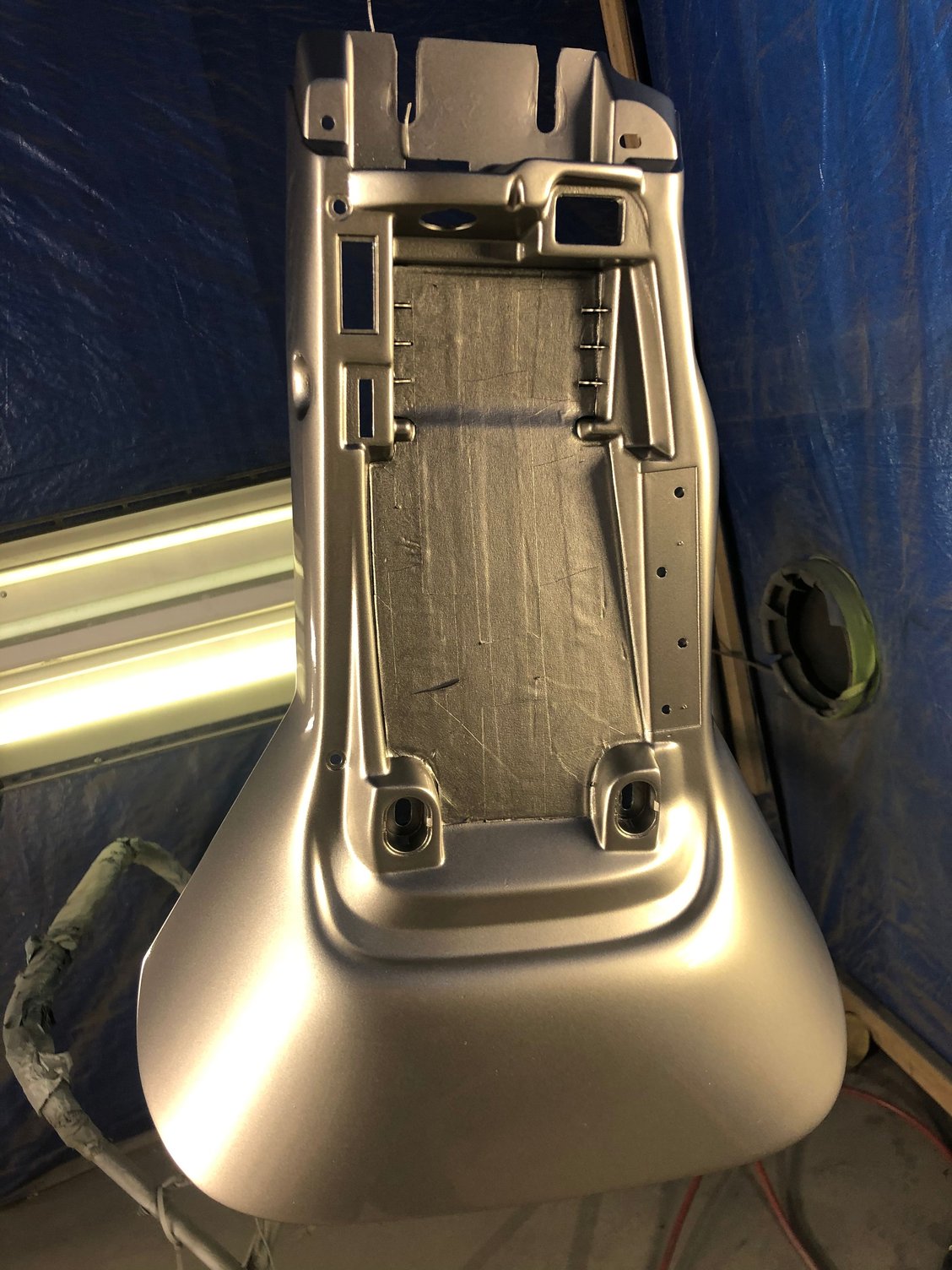

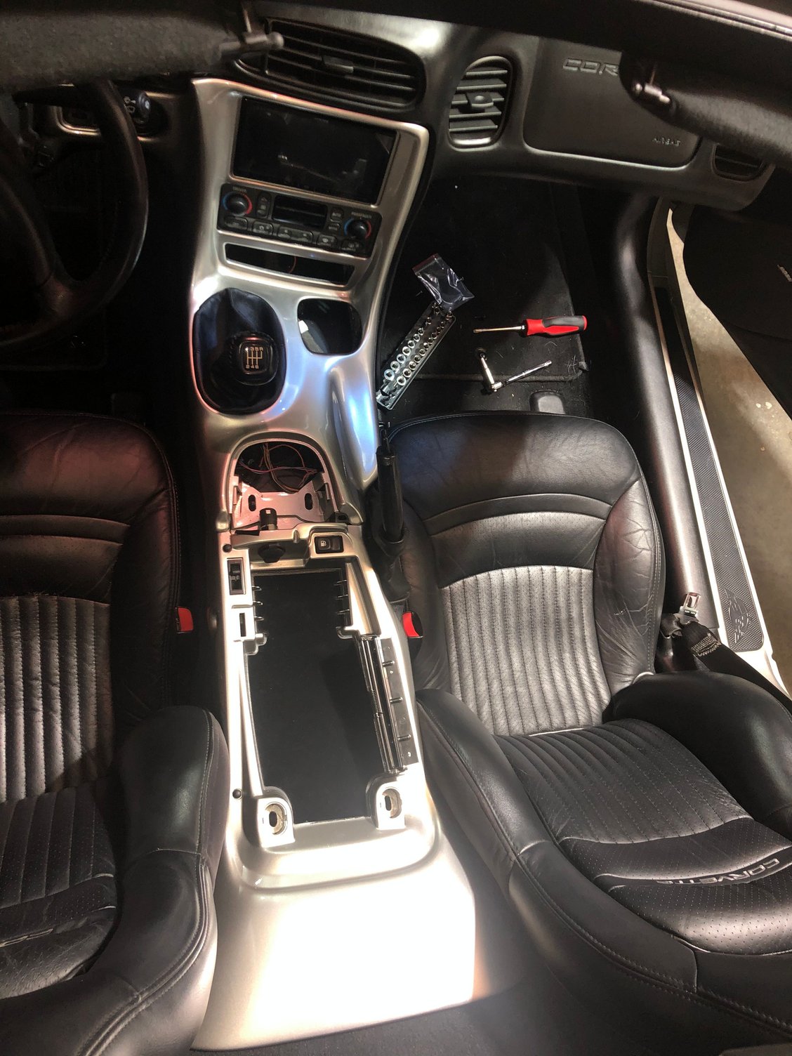

Santa, aka the wife, got me the Alpine ILX-W650 I’ve been looking at. I’ve got everything removed and because of the mismatch between the finish of the oem console and the replacement I purchased I decided to do a color match on the console. Turned out real nice. One coat of sealer, two coats of Pewter Metallic and two coats of clear. Waiting on the parking brake bypass to show up then I’ll finish up the harness and run the backup camera. Also installing the XM receiver and antenna.

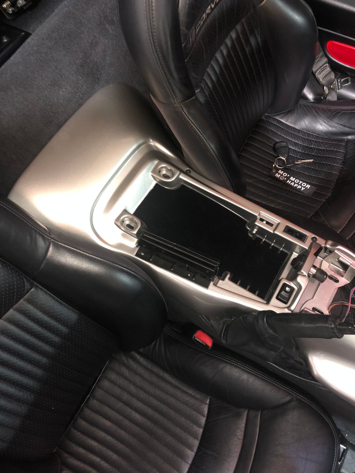

Test fit.

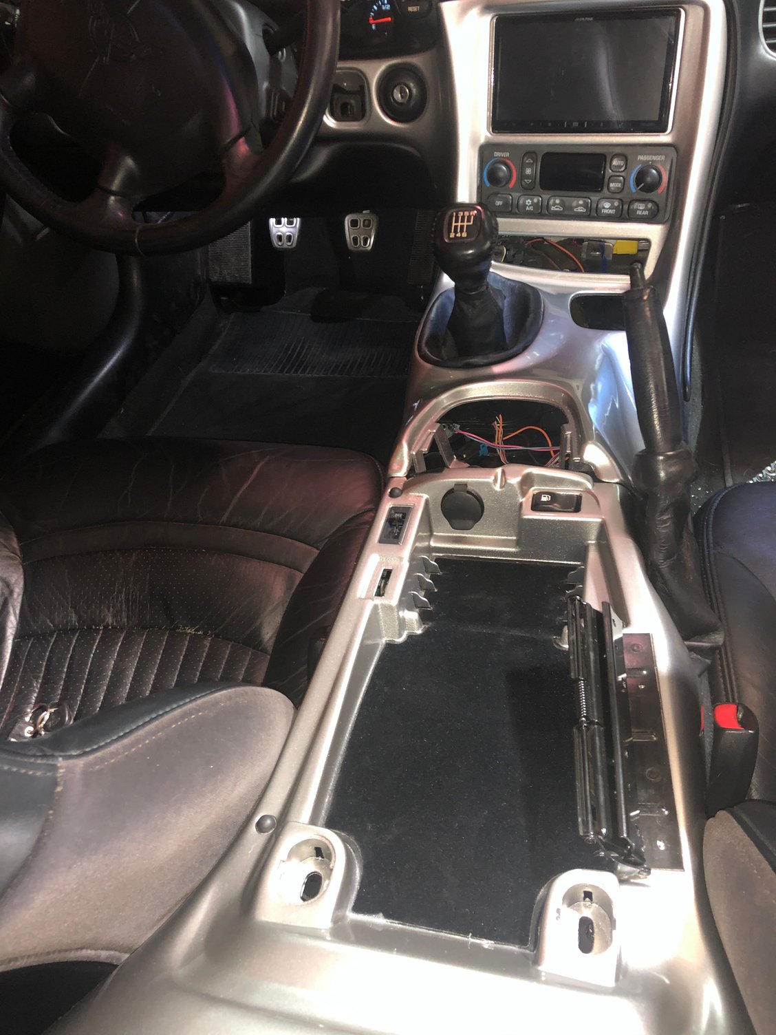

Test fit.

Thanks man. I won’t take full credit. My best friend has been a custom painter for 25 years. He’s got a paint booth in his shop. I did all the prep work, DA sanding and cleaning. I let him mix the paint and spray it. The paint is Nason Base that available from Oreillys. I think there’s companies out there that do a mix you can purchase in a rattle can. This was sprayed out of a gun

I know the brand of sealer was Nason. I didn’t remove all of the rubber coating from the aftermarket bezel. I did sand off all the texture from the OEM half of the console.
