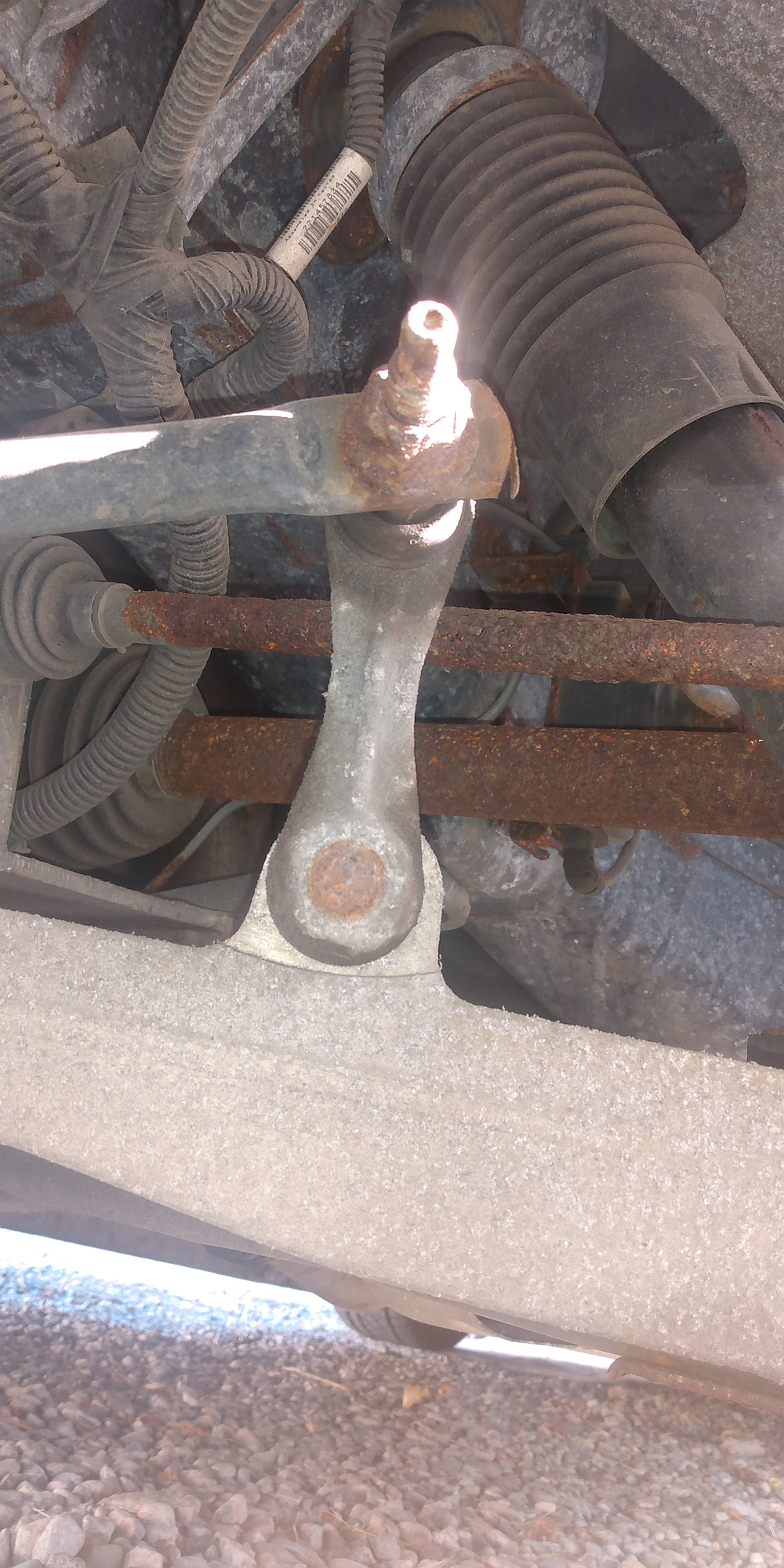

Hey folks - thanks so much for the responses, as a 54 year old computer geek I am still amazed at how much easier it is to learn things than it was before the internet. Or even Fidonet, for those who were into computers before then.
This car sat at the beach for 3 years and didn't move. How do I fix this so it can be considered a solid car again? One person said use steel wool and then some kind of anti rust protectant but the fact is it won't be in that environment again - the car is now in Las Vegas where it rarely rains, much less has any appreciable humidity.
I also considered taking each quadrant of the car apart and PB-Blaster all the nuts and bolts, scrub them clean along with anything I cannot remove and put it back together.

ALSO - lots of body panel alignment issues (headlight covers and quarter panel clearance with hood and door), but no issues with paint. Almost seems like its been taken apart on the outside only, but carfax says no accidents and previous owner cops to nothing like that. Is that a warning sign it's been wrecked or do people take the panels off for some reason?
It sounds like you have the right idea with the rust, sand it off, power wash it, seal it but I've never done anything like that. Only thing that looks that bad to me is the tie rod or whatever that is. As for the alignment issues, I believe they are pretty common with the headlights in particular but it looks like a pretty straightforward job (fiddling with some adjustment screws). I'm going to be tackling my headlight gap when my new lights arrive so I've already done the research and have the thread/video for you: https://www.corvetteforum.com/forums...alignment.html

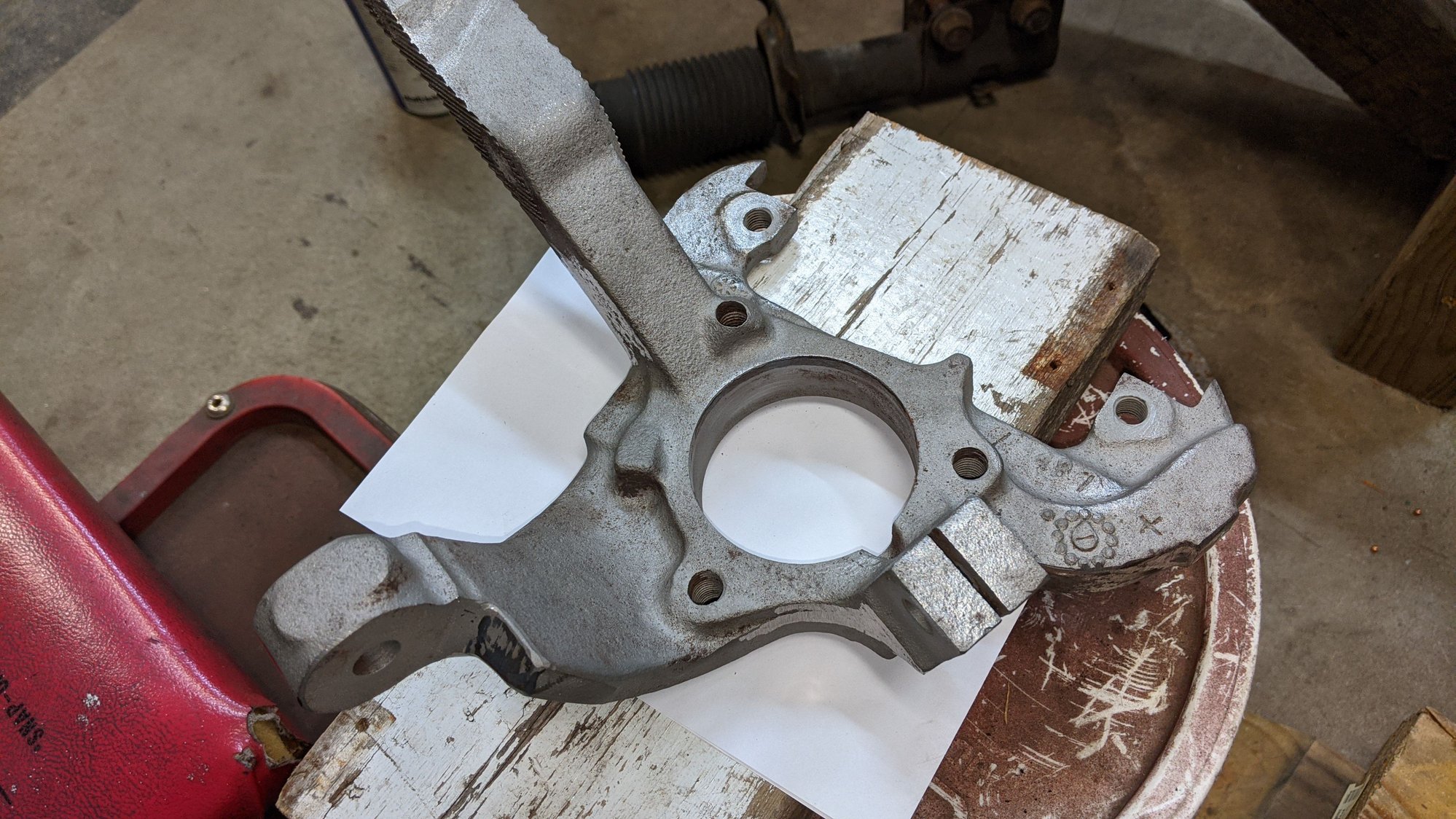

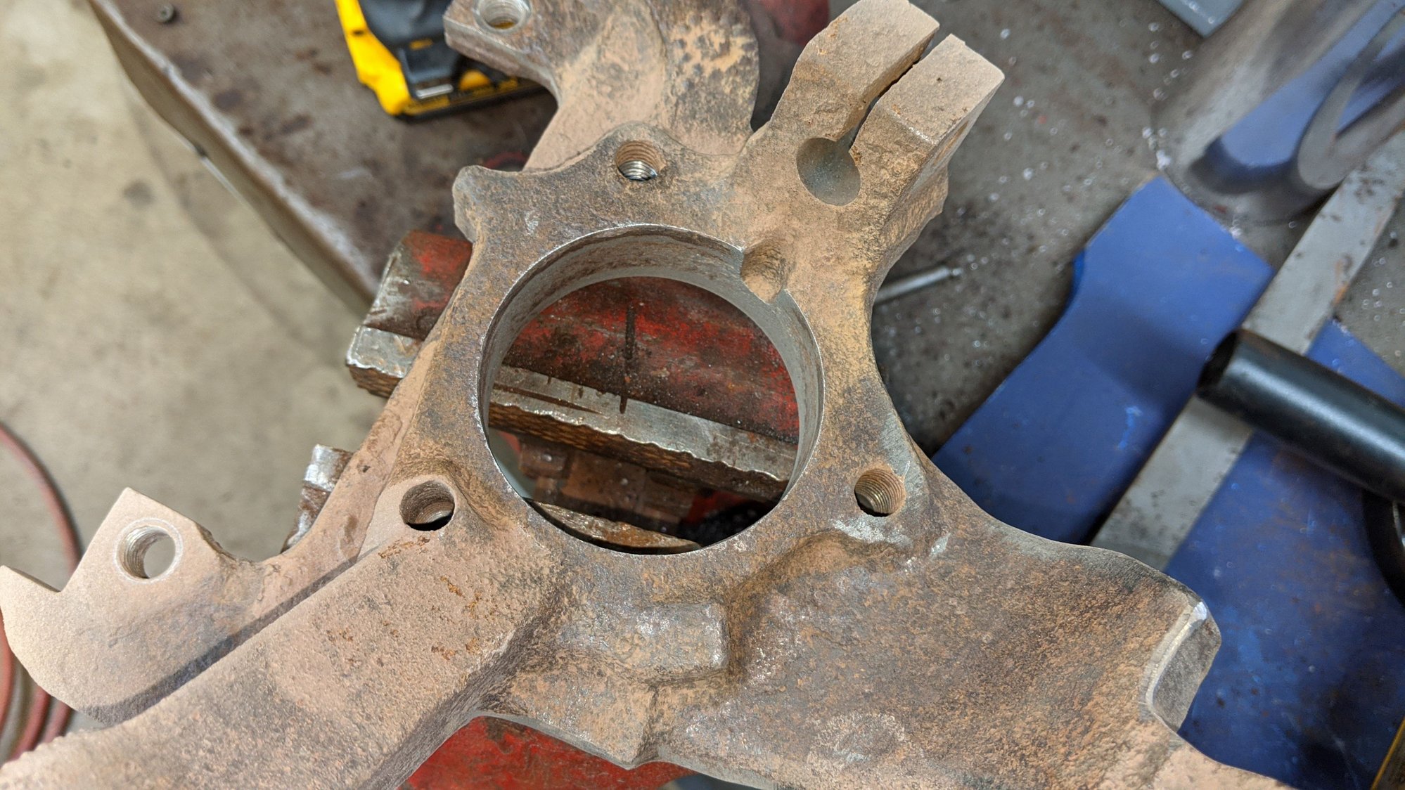

Ironically I just did some sandblasting yesterday on a steering knuckle for another project car I have. Takes time, gets sand everywhere, is harmful to breath in, but EFFECTIVE.
Old Jan 5, 2021 | 09:34 AM
Posts: 368,617
Likes: 24,867
Toys4Life C5 - great job with the sandblasting. The part looks like new.

None of the stuff pictured is structurally compromised and can simply be replaced as previously stated. My much bigger concern would be the frame. Likely not structurally compromised, but does it look as shitty as the piddly parts?
To salt damage
