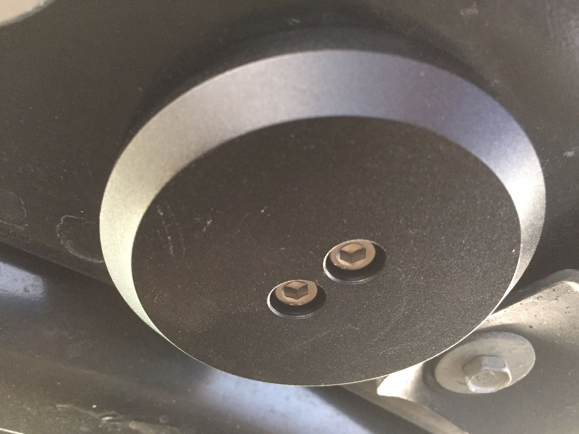

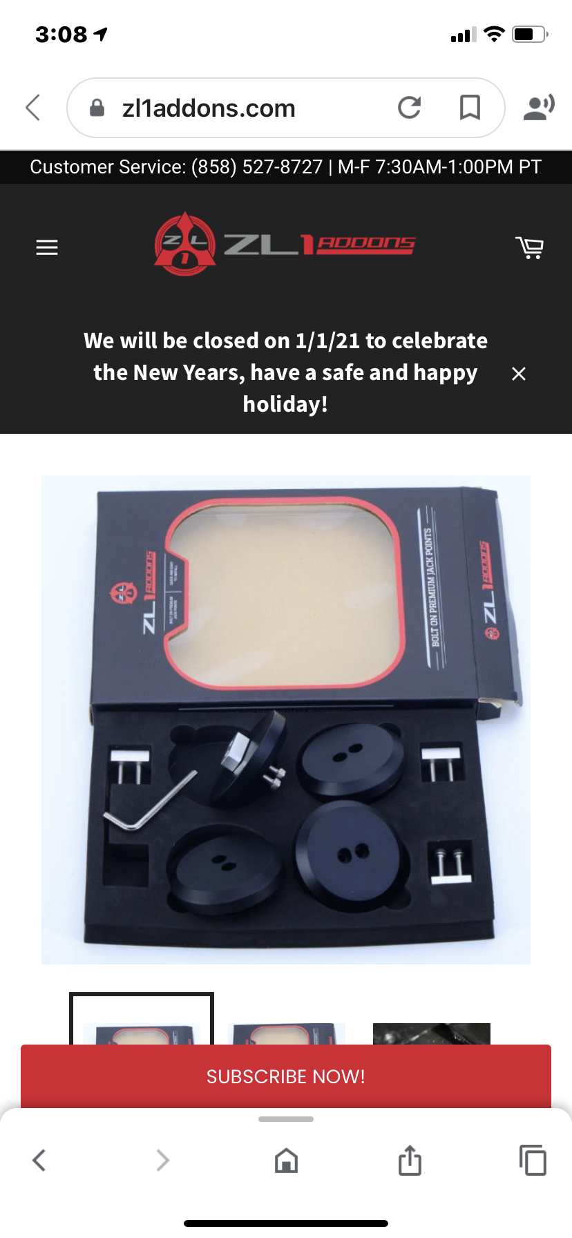

I choose to go with the ZL1 Addon's permanent jacking pucks ! Picture of puck on car is on my 17GS same pucks used on my 04 !
