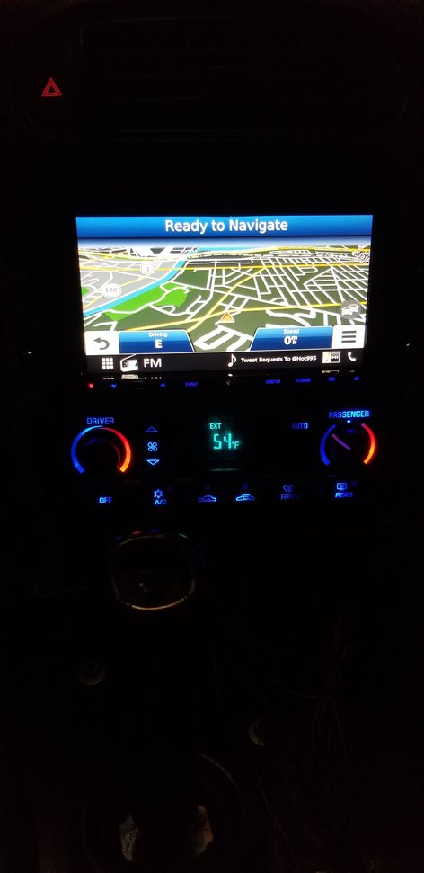

I did my own, many years ago a member named TStar had a thread about doing them. There is a diagram that I made (its crude, but it's easy to follow). This is what mine looks like now that it is fixed. You really do want to make sure you don't short anything so tape/heat shrink the leds so that you don't get any problems. You should shave the tops of the LEDs down for more even light distribution. I did not do that, but it still looks ok. I've had it like this for a while and have had no problems. To answer the original question, I don't think there should be any problem if the HVAC isn't present while driving. You will just be chilly or too hot, depending on the weather that day.
