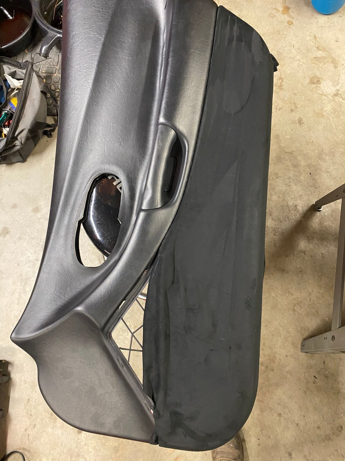

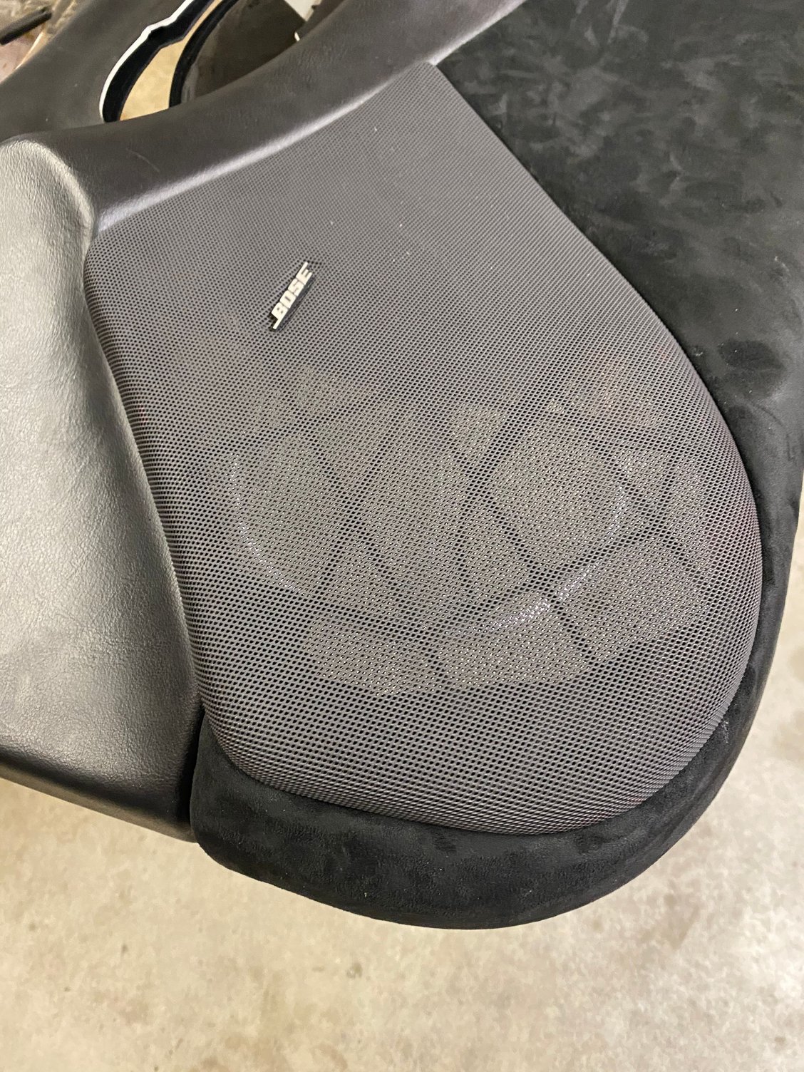

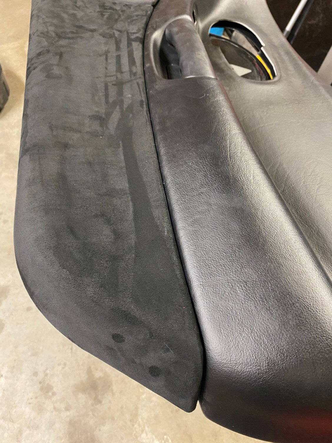

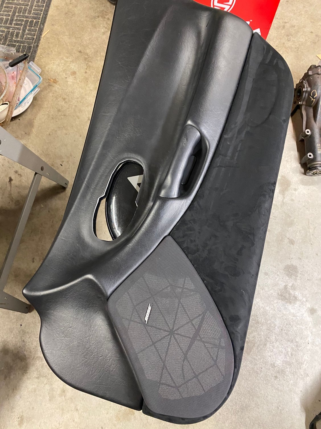

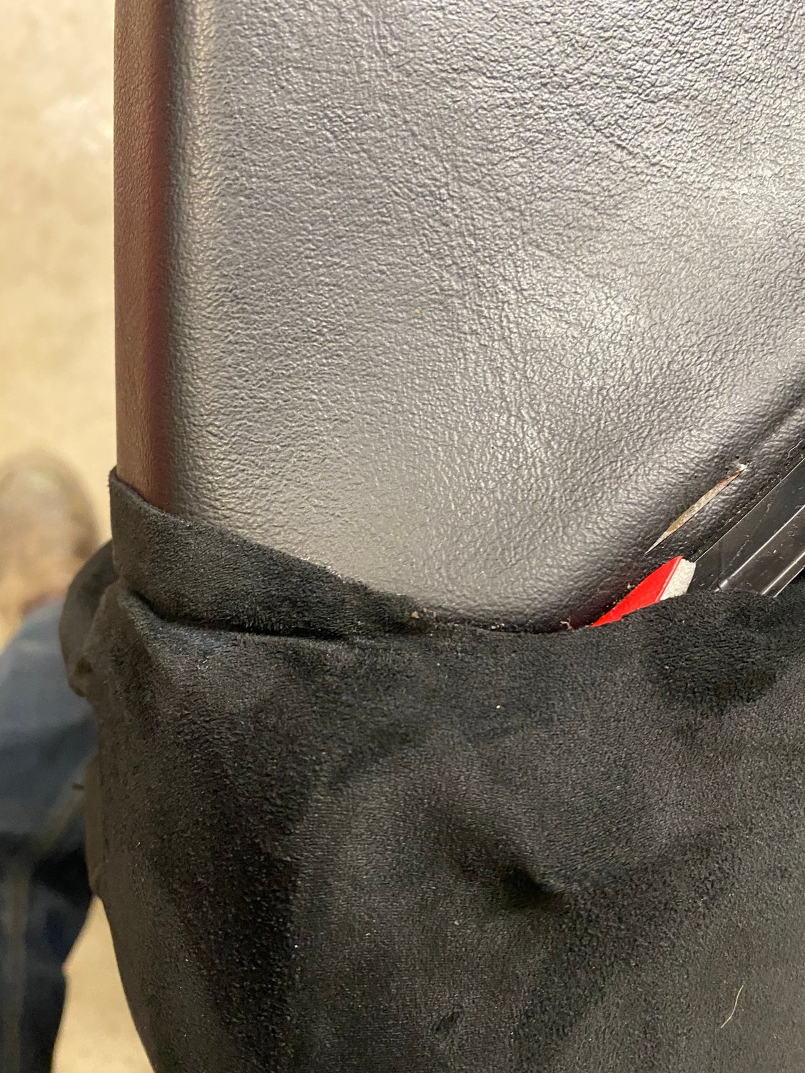

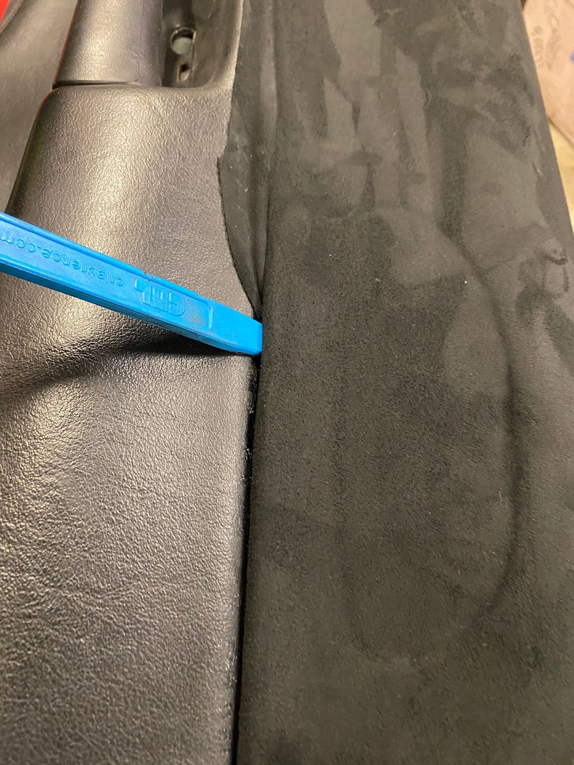

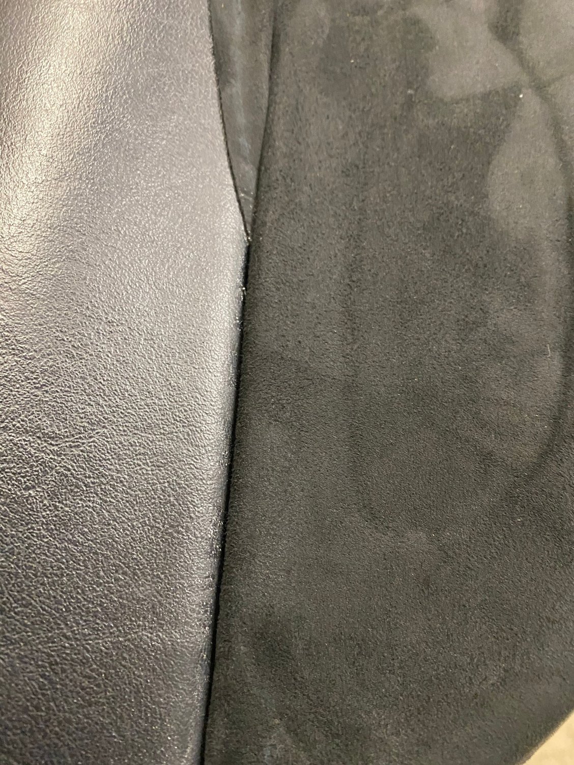

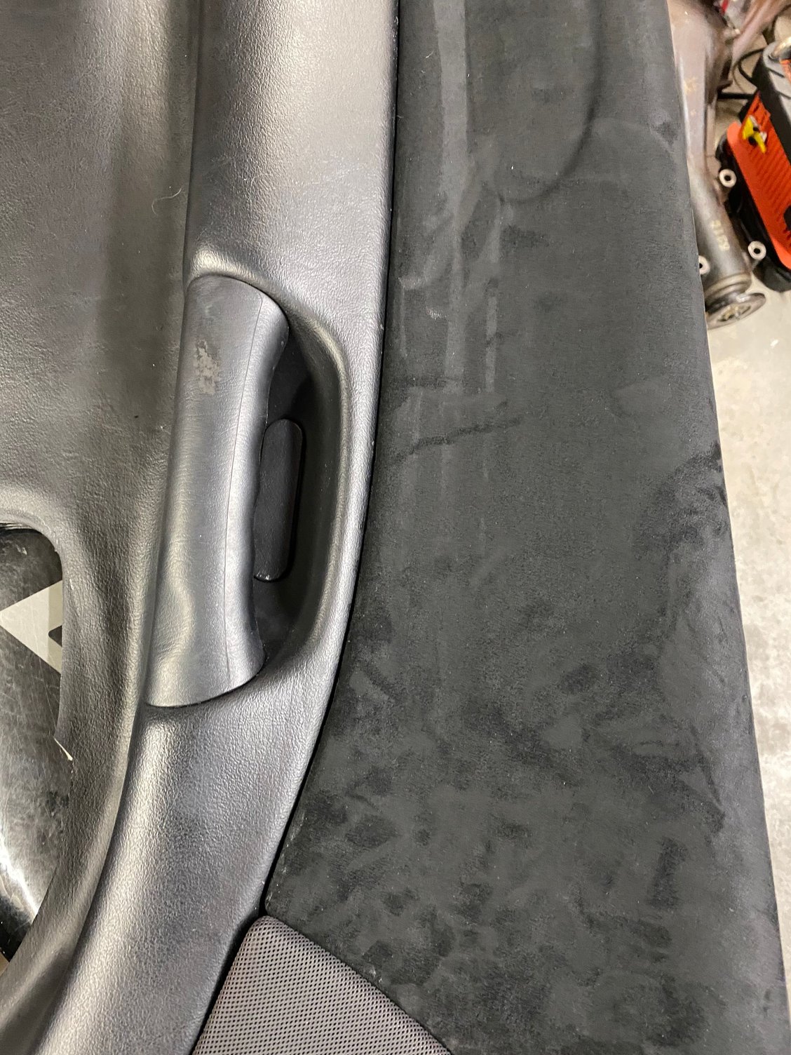

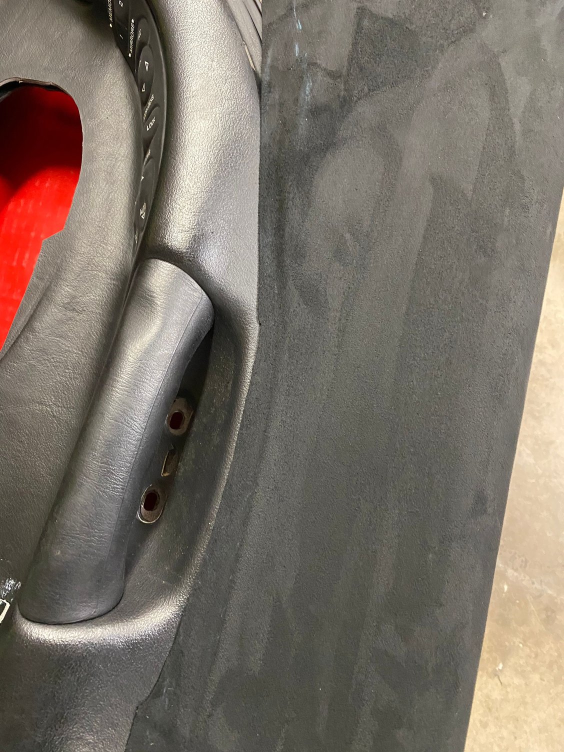

It's holding up great! No complaints whatsoever! I removed the fabric from the center console.
Yes, so for the door panels I figured out a SUPER easy way of applying it without removing the two pieces.
Instructions:
1. Clean the surface you are applying the adhesive/fabric to.
2. Cover the rest of the door panel. I used and trash bag and masking tape. Making tape doesn't leave sticky residue.
3. Remove speaker cover. Fold the tabs over and pull out.
4. Lay the fabric over the lower part of the door panel and cut out the shape, make sure you cut it bigger. Also, if you have chalk you can mark it.
5. Spray adhesive onto door panel and fabric.
6. Apply fabric to the door panel. Make sure to rub it onto the door panel and stretch it over the ends.

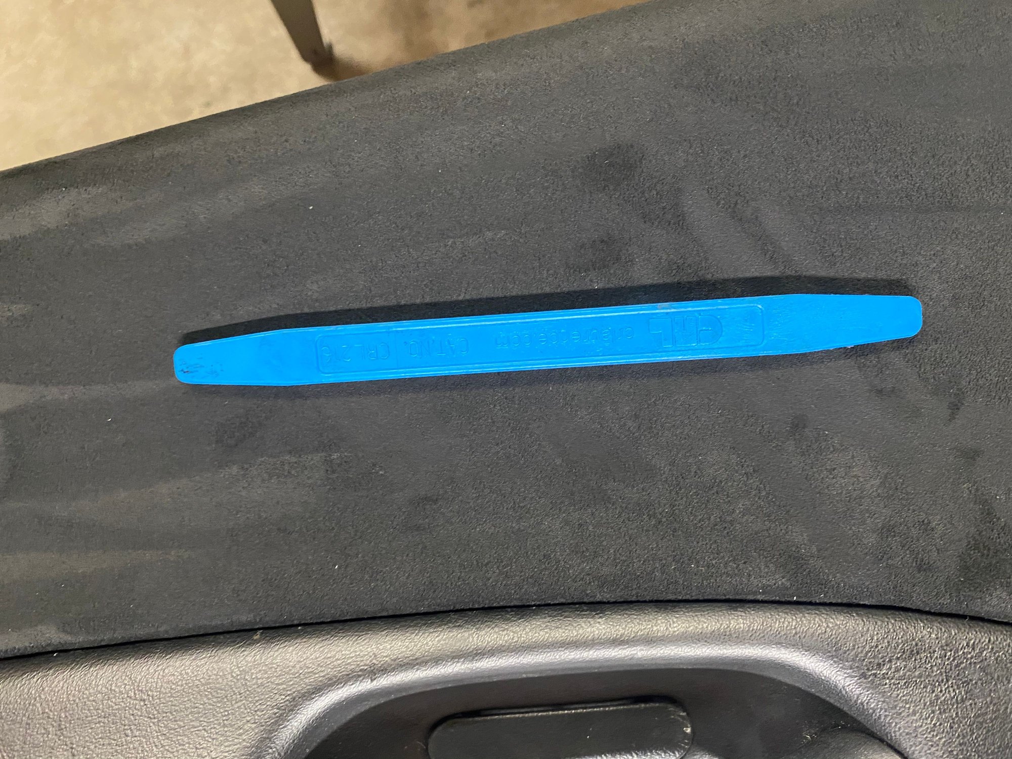

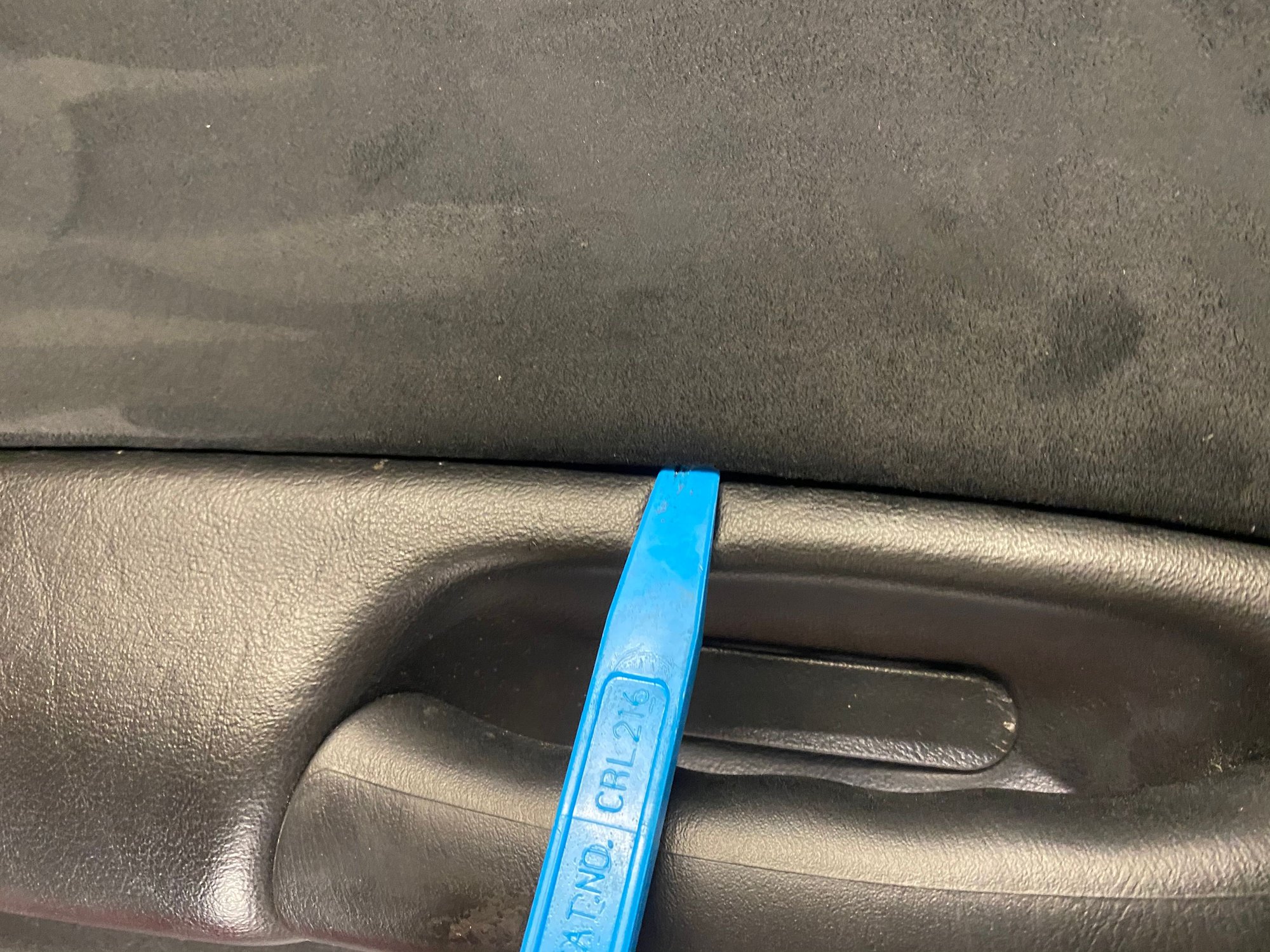

7. For the gap where the lower and upper panel meet, use an object to tuck it under the lower part. I used an auto glass stick.
8. Smooth it out and review for imperfections.
Pictures to better demonstrate:
