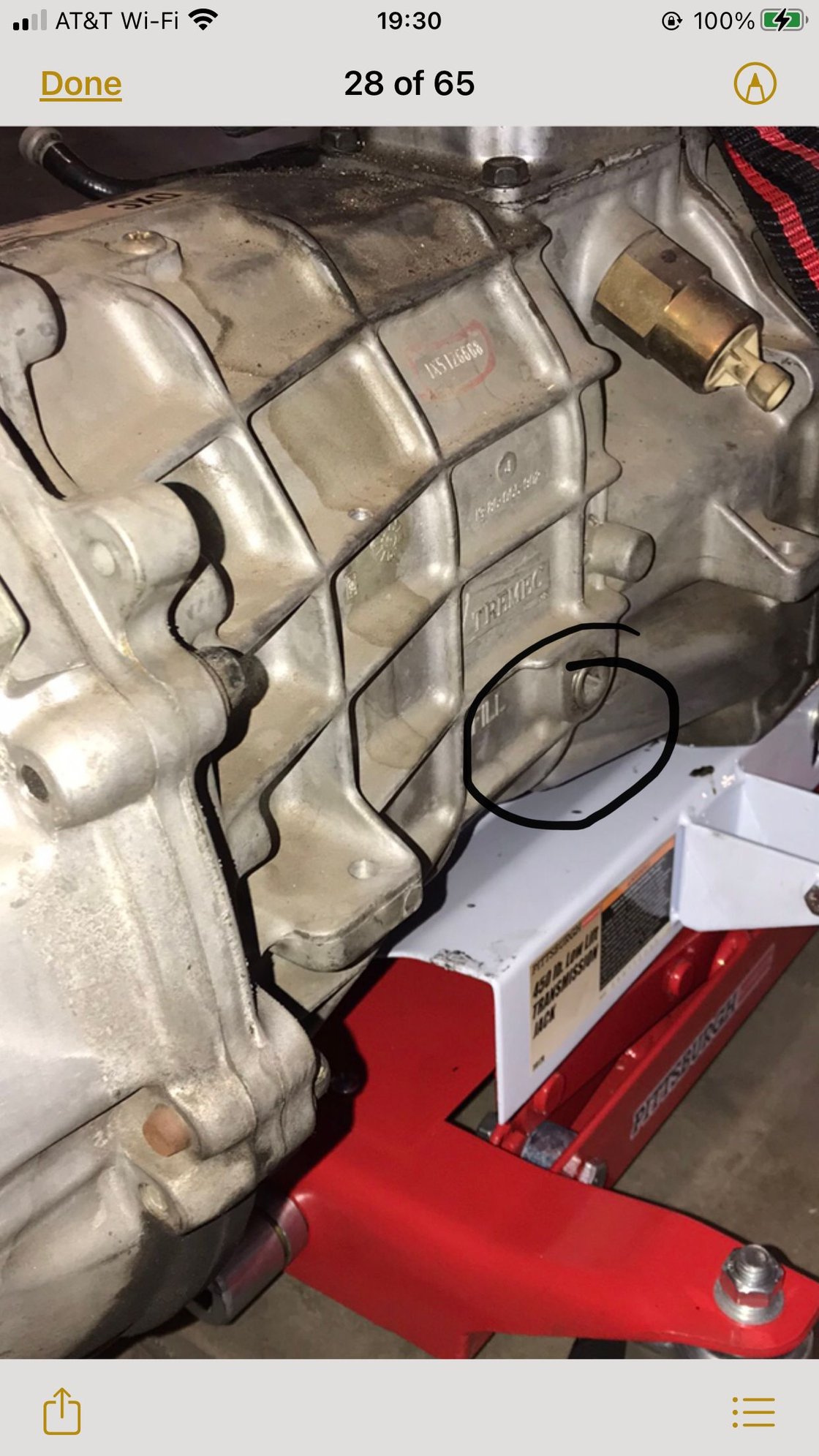

This help

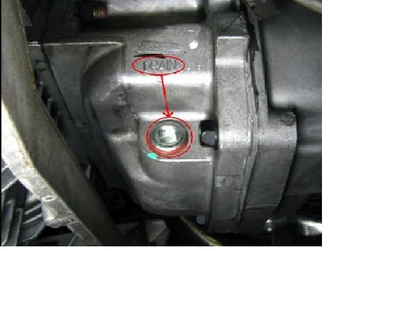

Or this
https://www.corvetteforum.com/forums...ans-fluid.html

Originally Posted by oh1vette
Thank you... This is consistent with "Mark's 2004 Corvette Z06"
Mark's 2004 Z06 Lots of great details and clear pictures of various procedures.
