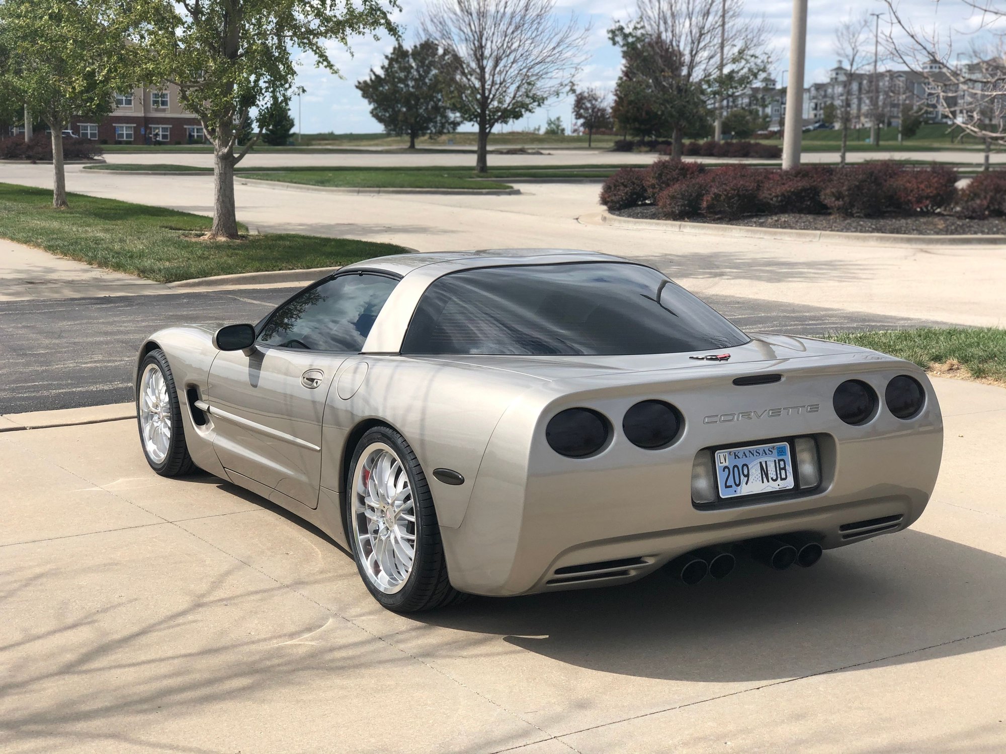

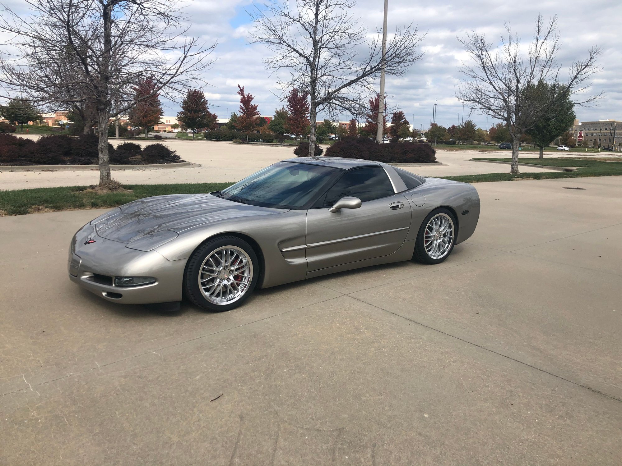

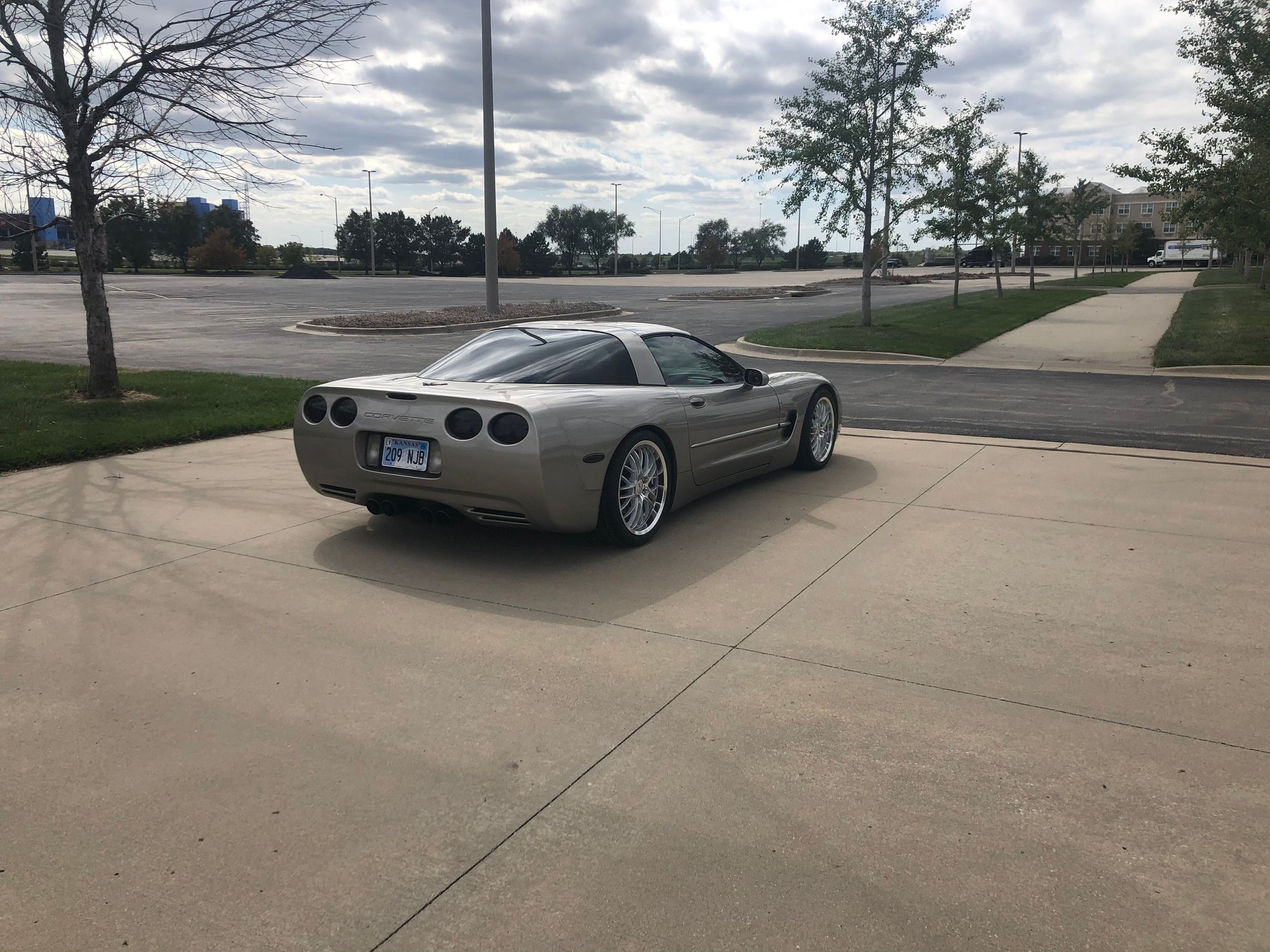

Here ya go.

That is one nice ride! The wheels and other subtle touches are just the ticket

110%.
That is one sweet looking ride. Congrats.

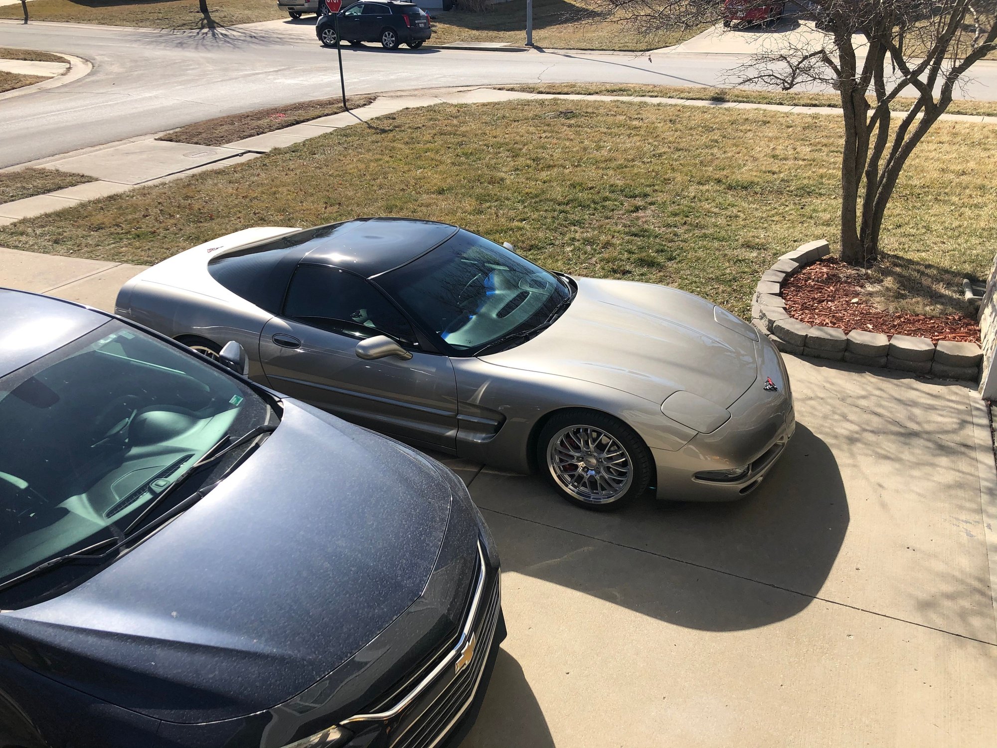

Thank you guys! Once it finally stops raining I’ll get some photos with the blacked out roof and hoop. Here’s a bad pic I took as soon as it was done. I’ll end up getting the tint redone darker so it all blends in better.

Wow, beautiful ride! What sizes and offsets did you go with on the Crays? And what tires did you use as well?

Front Wheel Size: 18x9
Front Offset or Backspace: +50
Rear Wheel Size: 19x10.5
Rear Offset or Backspace: +69 also used 1/4” spacers
Front Tire Size: 265/35 Hankook Ventus V12 evo2
Rear Tire Size: 305/30 Hankook Ventus V12 evo2

Are the rear wheels +69 offset or +65? Thought the later was what Cray used on those. Curious about you using the 1/4" spacer. What was that for ... to clear brakes or move the wheel more outboard?

The rears are 69 mm offset. I went with 305s out back and they are a very tight fit with roughly a half inch of clearance on the inside. No issues with brake clearance.

Correct. It’s a +69. I used the spacer because I was getting a slight rub on the back side of the tire on the inner fender wells. Plus it pushed the wheel out a smidge to even it up with the fender a little better

That offset is more suited for the rear of a base C6, that's why a spacer is required. Some wheel makers don't want to offer separate C5 and C6 fitments so those offsets are the result.
