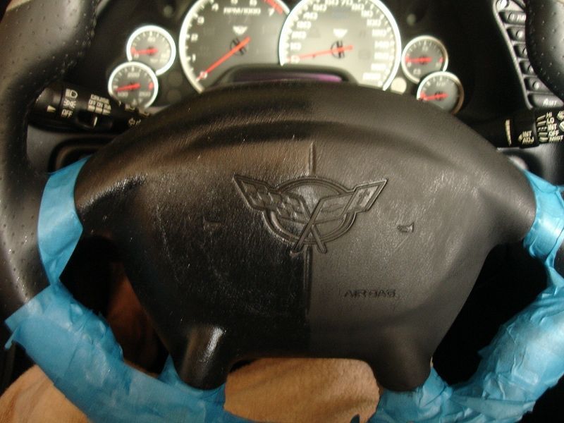

After I used Goof Off, I took some Rustoleum Supergloss Black spray paint. Spayed a generous amount on a paper shop towel (away from the car) and then blotted the paint onto the airbag cover. I did several coats. Let each coat dry before the next. Mine looks brand new. I did this without disassembling the airbag cover. I was just very careful to not get the paint on my seats or console etc.

I stumbled upon a fix for mine by accident. I had been trying everything, including the ammonia trick...goof off, even bug and tar remover. Out of the three, the bug and tar remover worked best, but it still was a very slow process. All the sudden I remembered that when I was going to put the corvette lettering on the passenger airbag cover, I sprayed alcohol on it and wiped it off to prep it. Much to my dismay, I had black on my rag and I knew I had taken some of the finish off. Luckily I didn't scrub and its not noticeable. I decided to try alcohol on my driver airbag to remove the sticky, since they seem to be the same material. I finally have a sticky free airbag! Took about 15 minutes, looks great.
