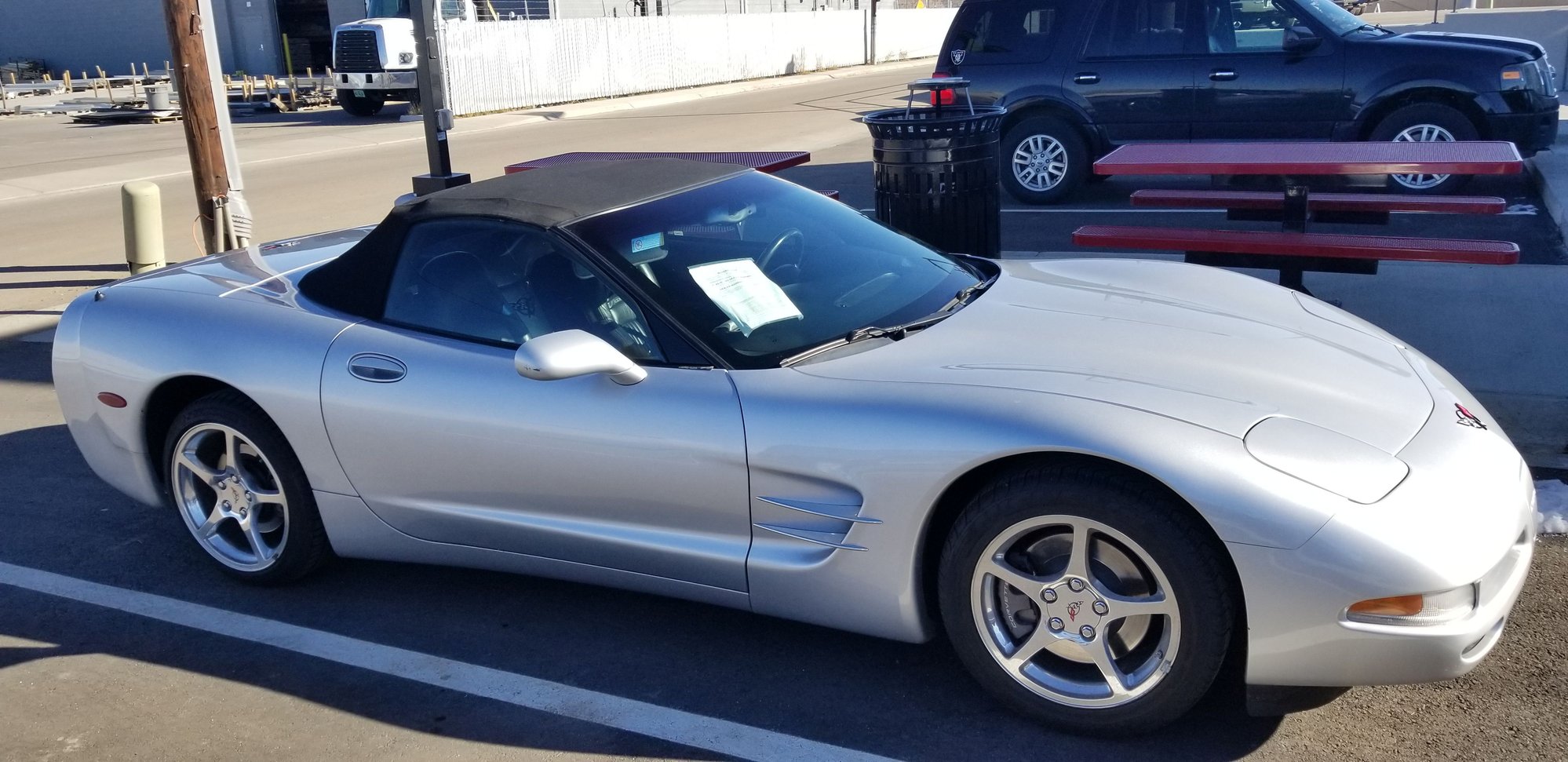

This is my first Corvette a C5 Convertible I love his car only one problemIt it leaks around the tops of the windows. Dose any one knows anything about this. I'm not mechanically inclined
