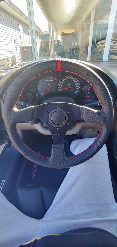

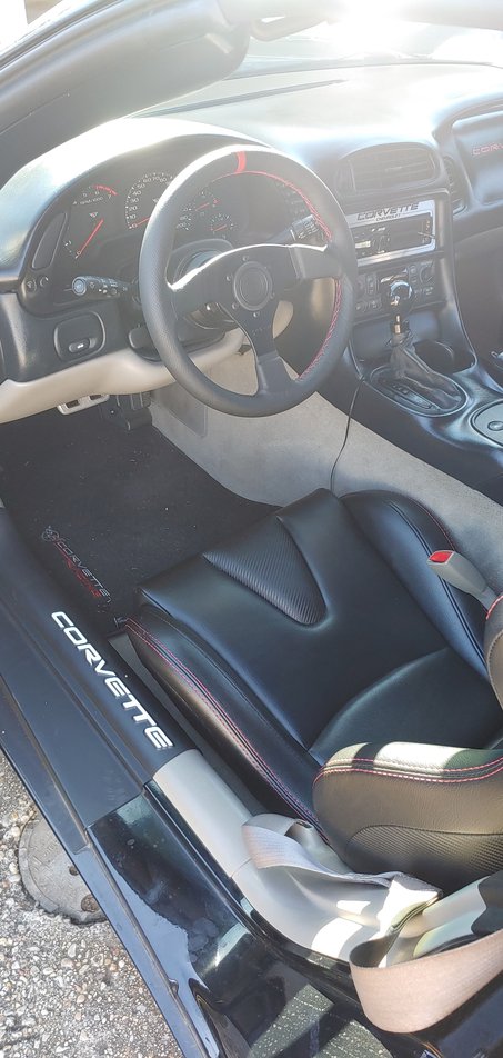

I installed a Sparco R383 Champion wheel a couple months ago. I used the NRG SRK 170-H hub adapter and the NRG SRK 200BK 2.0 quick release. I did not use a spacer and I am happy where the wheel sits. I find its close to where the stock wheel was. I don't have to take my hand off the wheel to use the turn signal stalk or wiper stalk. Now I also have Corbeau Evolution X seats, so the positioning is a little different compared to stock seats.

That looks awesome garline.

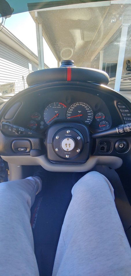

I ordered the same hub adapter and quick disconnect and installed it last weekend.

Looks awesome! The install was fairly easy, took me no more than 2 hours taking my time. I was so happy my wheel came off easy! Lol
