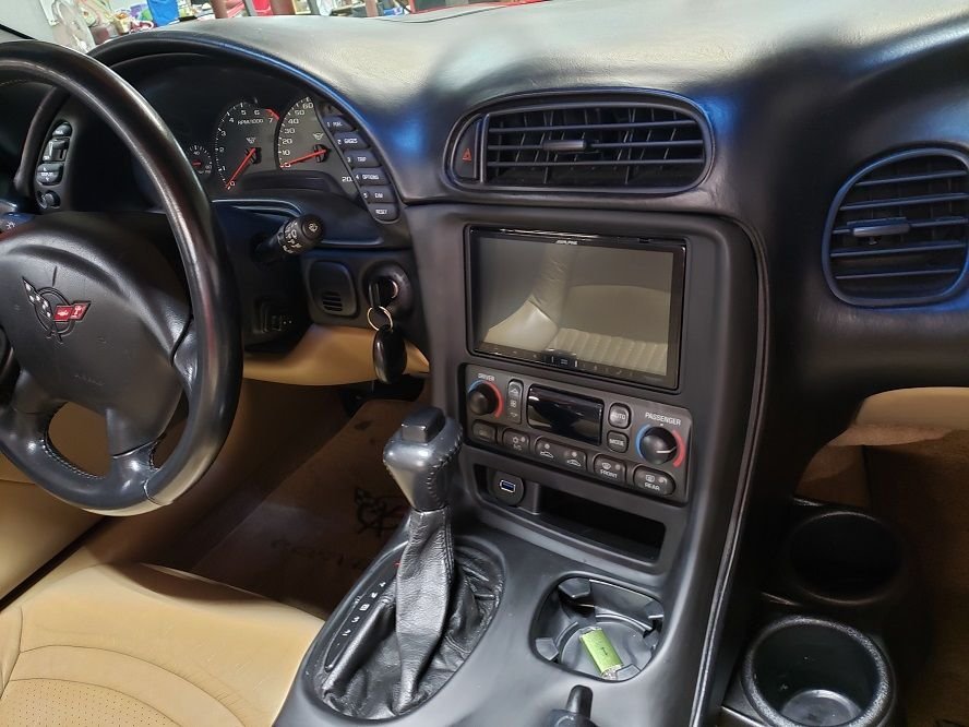

Default Another successful Alpine iLX-W650 install
The Bose amp in the passenger side woofer failed a few months ago so I decided to chuck all of the Bose stuff (not a fan) and install an Alpine iLX-W650 head unit with the KTA-450 amp. I replaced all 4 Bose speakers with JBL. Because I was not using any of the factory stuff I just did a direct wire job using new speaker wire etc. The only tie in on the factory wiring harness was for the power antenna. I put a flush mount USB port where the cigarette lighter goes. I am please with the sound overall, I am an audiophile and have a very decent home stereo system but don't really need high end for my vette. I just want to be able to hear it at highway speed with the top down. I could have spent more on speakers and made it even better but just didn't want to and I am not a fan of subwoofers except in home theater. I will probably sell the Bose stuff and some point.

St. Jude Donor '18 thru '26
Nice and clean!

Looks great! Nice install.

I like it too. Looks good.

That is one very clean looking install. Congrats on a job well done.

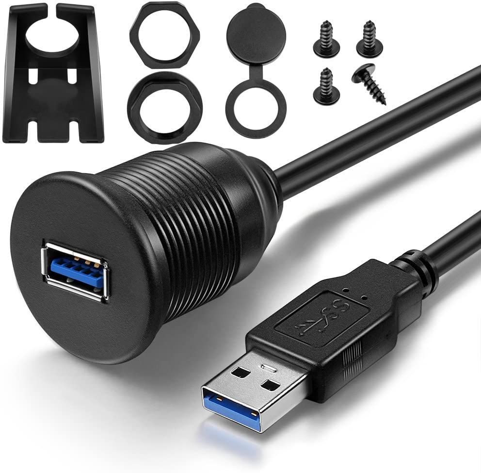

Hey looks very nice! Did you need to do anything to tighten up the USB mount in the cigarette lighter spot?
It came with a locking nut, I just had to drill the opening out to 1 1/16, this is the USB I used. I only used the USB and nut, the other stuff is for external mounting if needed:
https://www.amazon.com/gp/product/B01NAMU8KY/ref=ppx_yo_dt_b_asin_title_o00_s00?ie=UTF8&psc=1 https://www.amazon.com/gp/product/B01NAMU8KY/ref=ppx_yo_dt_b_asin_title_o00_s00?ie=UTF8&psc=1
