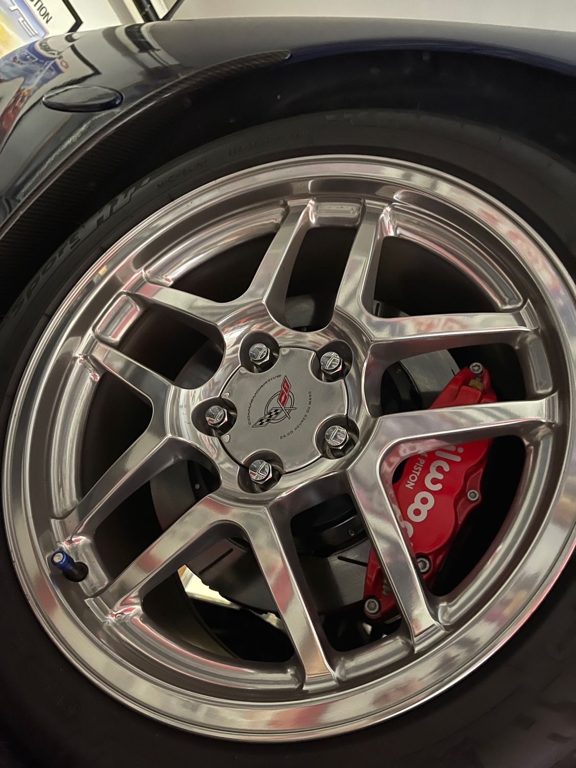

Sorry folks I didn't realize you asked for more details, which I will grab later tonight. I did snap this quick picture of the car, you can see the tire/wheel size as a 17" and the caliper calling out the 6 piston set up. This is the OEM 17" Z06 wheel.
And yes I realize my tires have a 2013 date code, the new michelins are waiting to be installed.

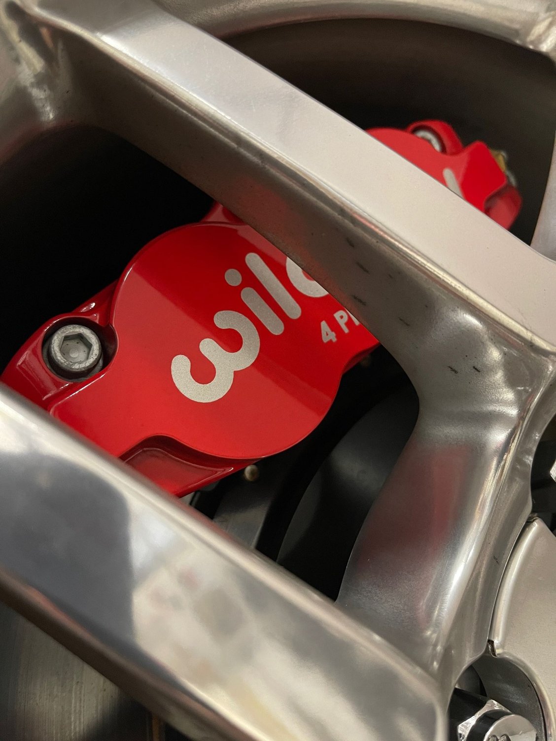

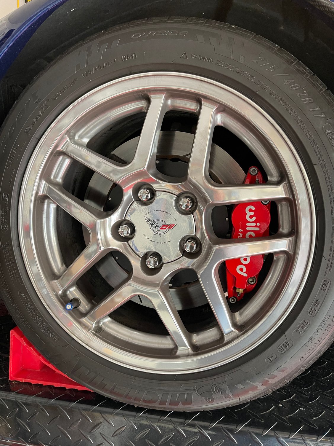

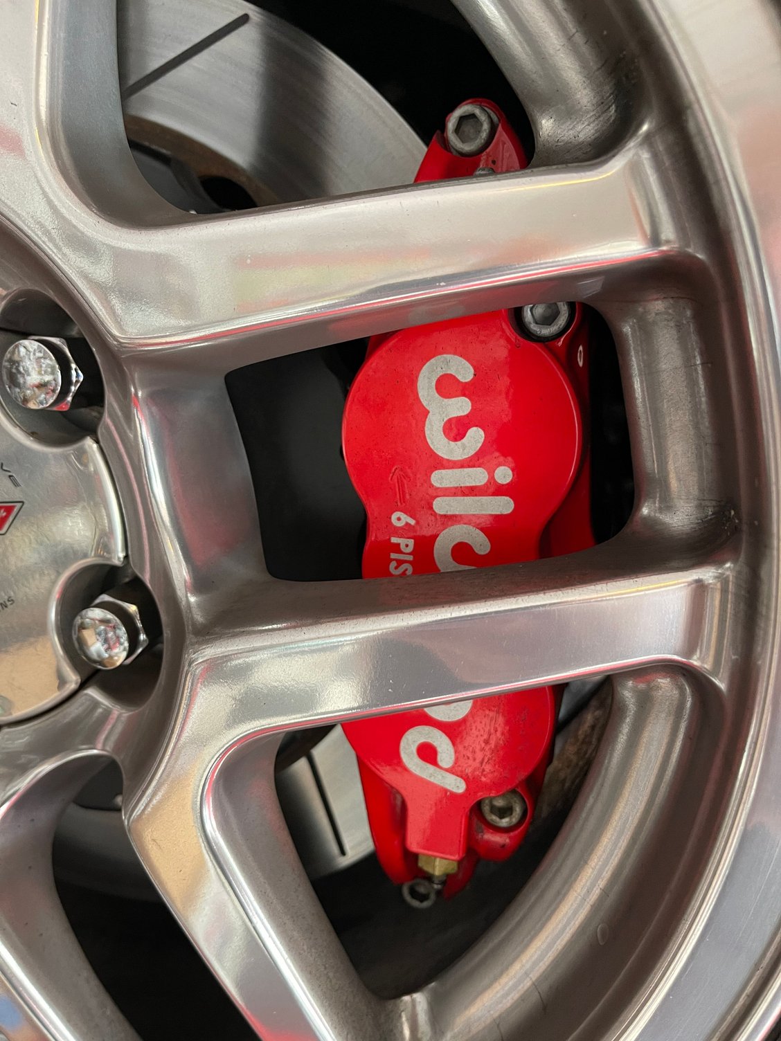

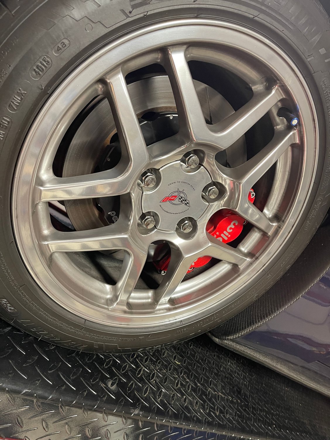

But onto the information. At the time I called and spoke with a tech at Wilwood rather than just buying a standard set up online from them or any other retailer. My goal was to run a 6 piston set up in the front and a 4 piston set up in the rear, without having to change out my OEM sized 17" front & 18" rear wheels. So I guess technically you can consider this a "Big Brake" set up since it is bigger than the factory set up.
The fronts are the Superlite 6 Piston Big Brake Radial Mount Super Lite Caliper. They use a GT 48 Curved Vane (slotted). These fit and clear the OEM 17" wheel, no issues with rubbing at all. Brake Pad Plate is 7416, and that is the same size brake pad plate that the rear caliper uses, so no need to worry about ordering front or rear sized pads, they are both the same.
The rears are Forged Narrow Superlite 4r Big Brake Kit, with the GT 48 Curved Vane (slotted) rotor.
Also upgraded the brake lines to stainless steel lines and I have all the part numbers if you are really interested in the set up. I am really happy with the set up and the calipers make for very easy pad replacements, as I swap out pads from a street compound to the more aggressive track compound when I am headed to the track.
FRONTS - SIX PISTON
REARS FOUR PISTON
