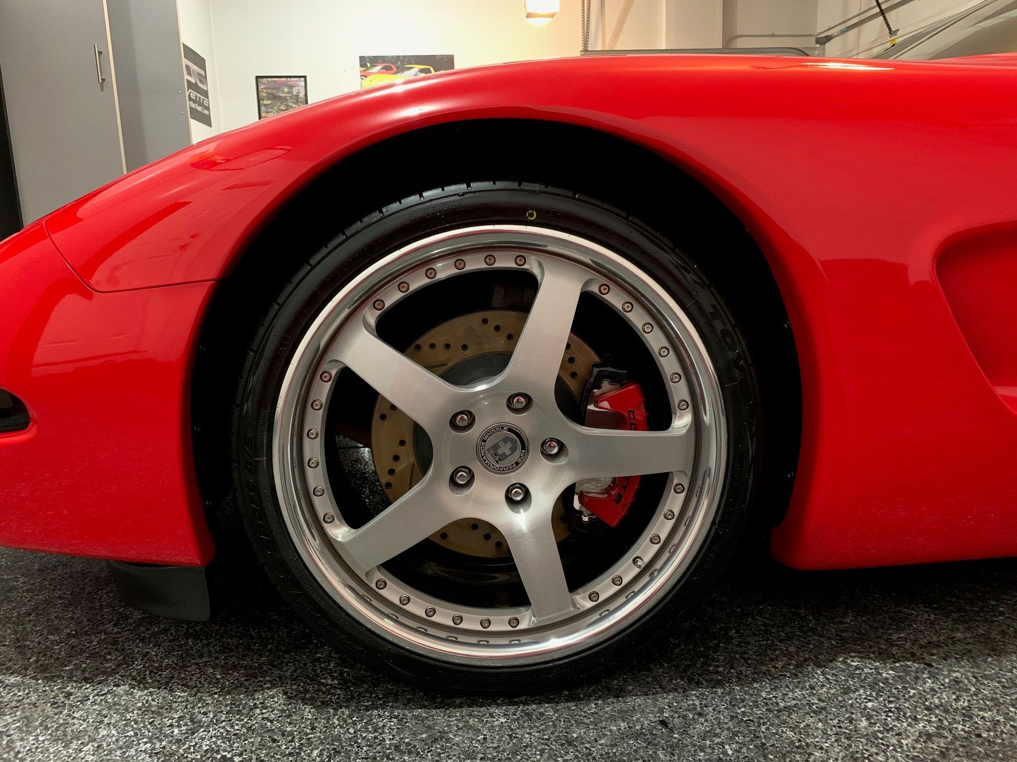

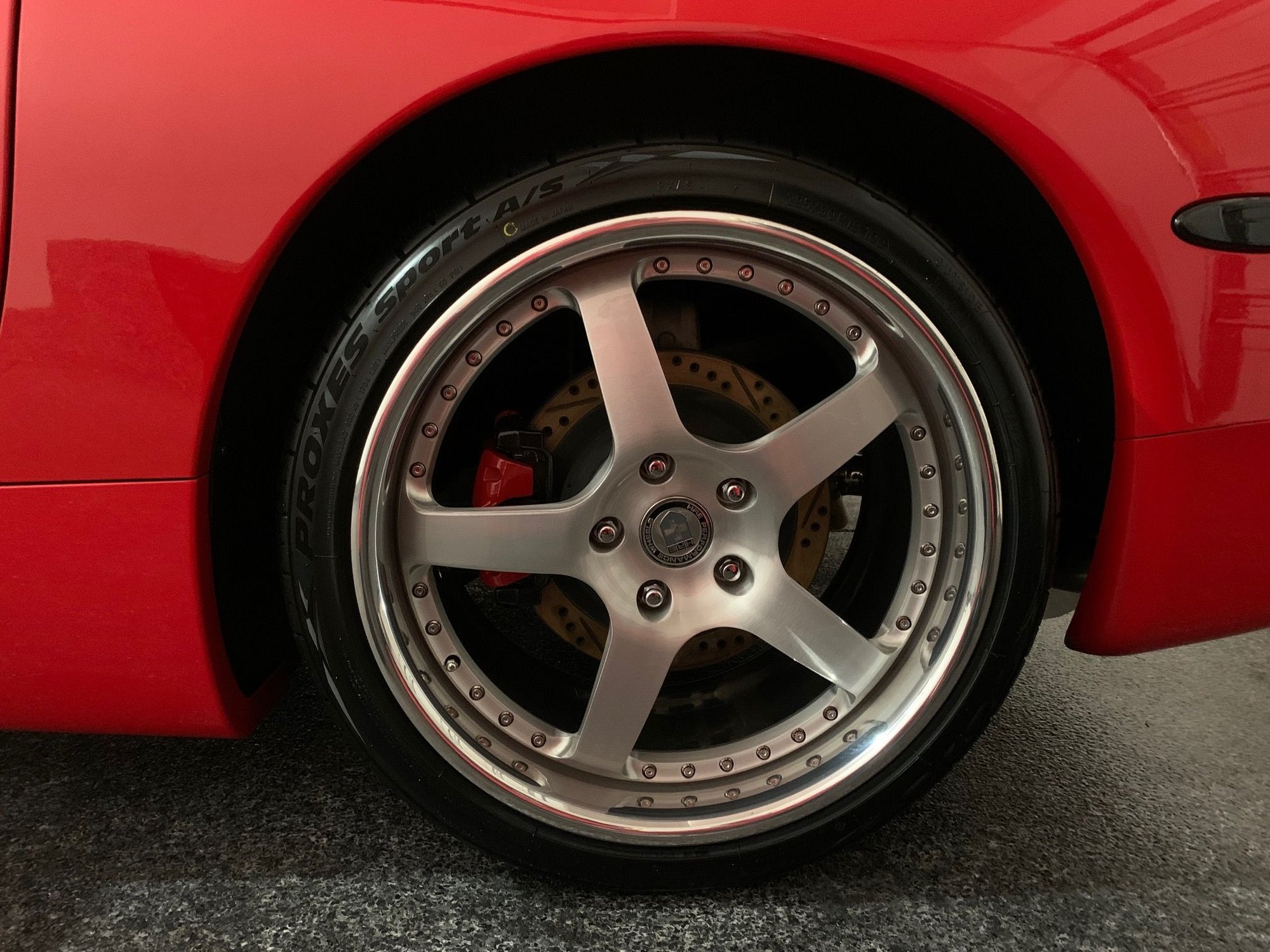

I have been running them on my 19s since December. I drive my car year round and have been waiting for a performance all season in the weird sizes I use. I have had no issues at all.
EDIT:
Here are a couple of photos from right after I washed the car the day I got them:

Hello, can you tell me which rims these are. What measurements and whether your c5 was lowered
They are HRE 595R. Being that HRE doesn't make them anymore, you'd have to find them used.
19 x 9.5 ET 59 w/ 1.5" outer lip
19 x 11 ET 48 w/ 3" outer lip
yes, my car is lowered on the stock bolts.
