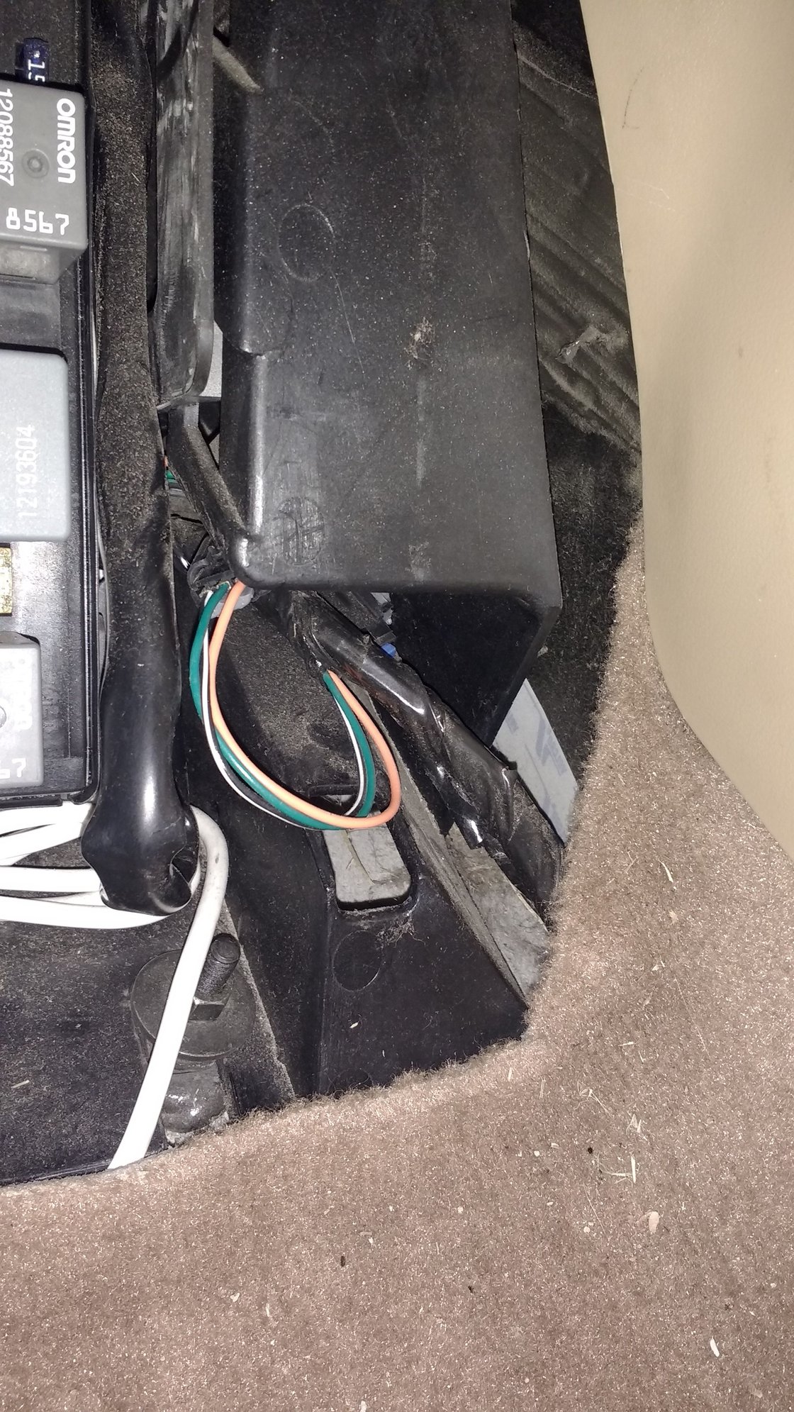

in the passenger footwell... Tracking down an issue with (a) my passenger window not working and (b) the computer throwing "no comm" codes, "reduced power," etc etc.. I think it has something to do with the window control module (https://www.corvetteforum.com/forums...-problems.html) but figured I'd see what this plug is first.
IIRC, it's the cable for the remote CD changer?

Actually, there are three orphaned plugs down there, a by the passenger fuse box... any of these have anything to do with my passenger window not working?

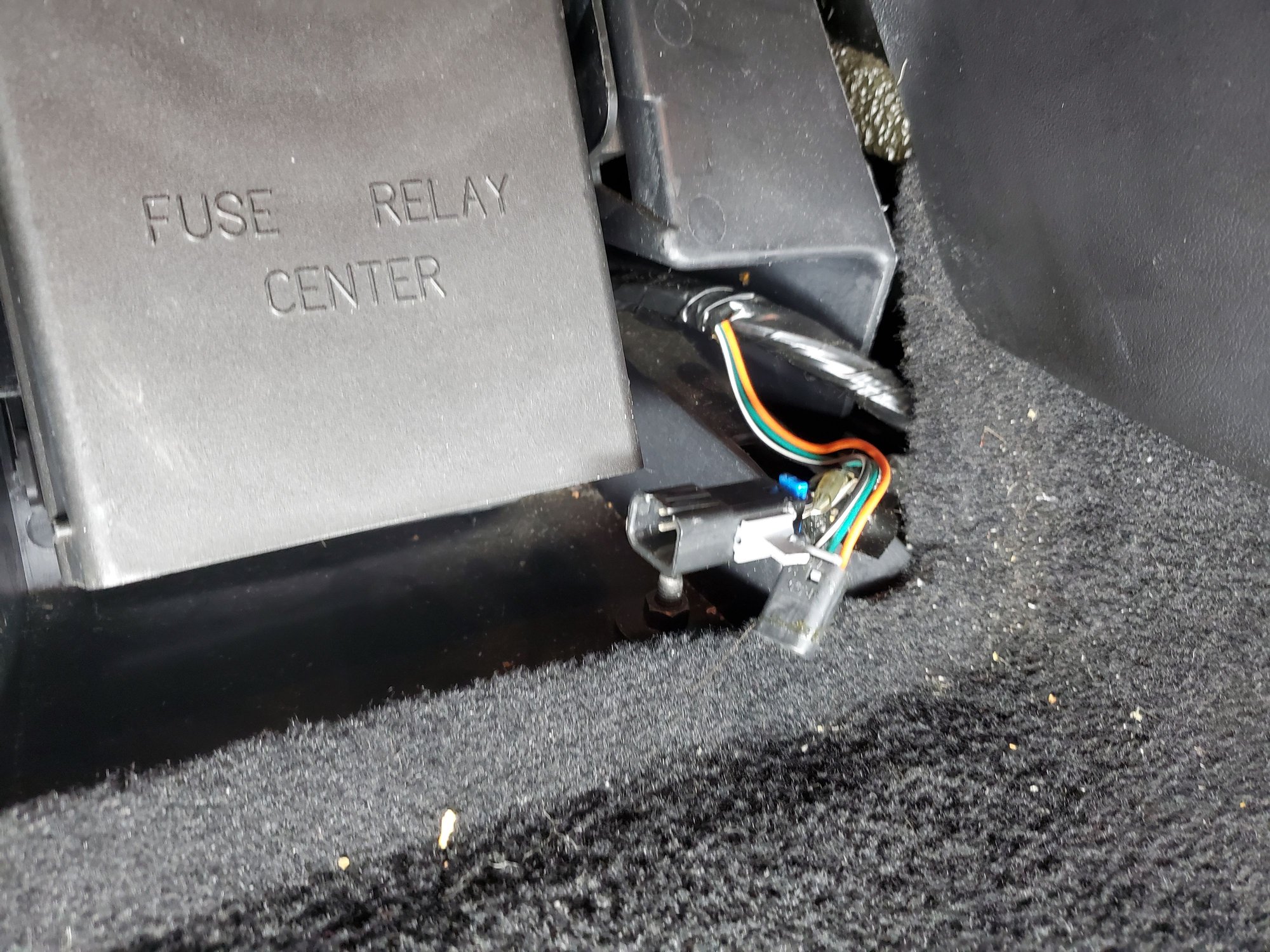

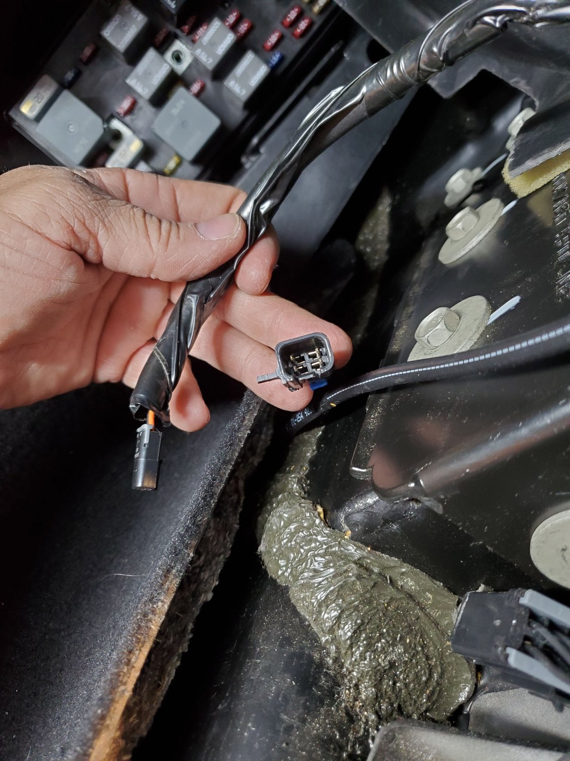

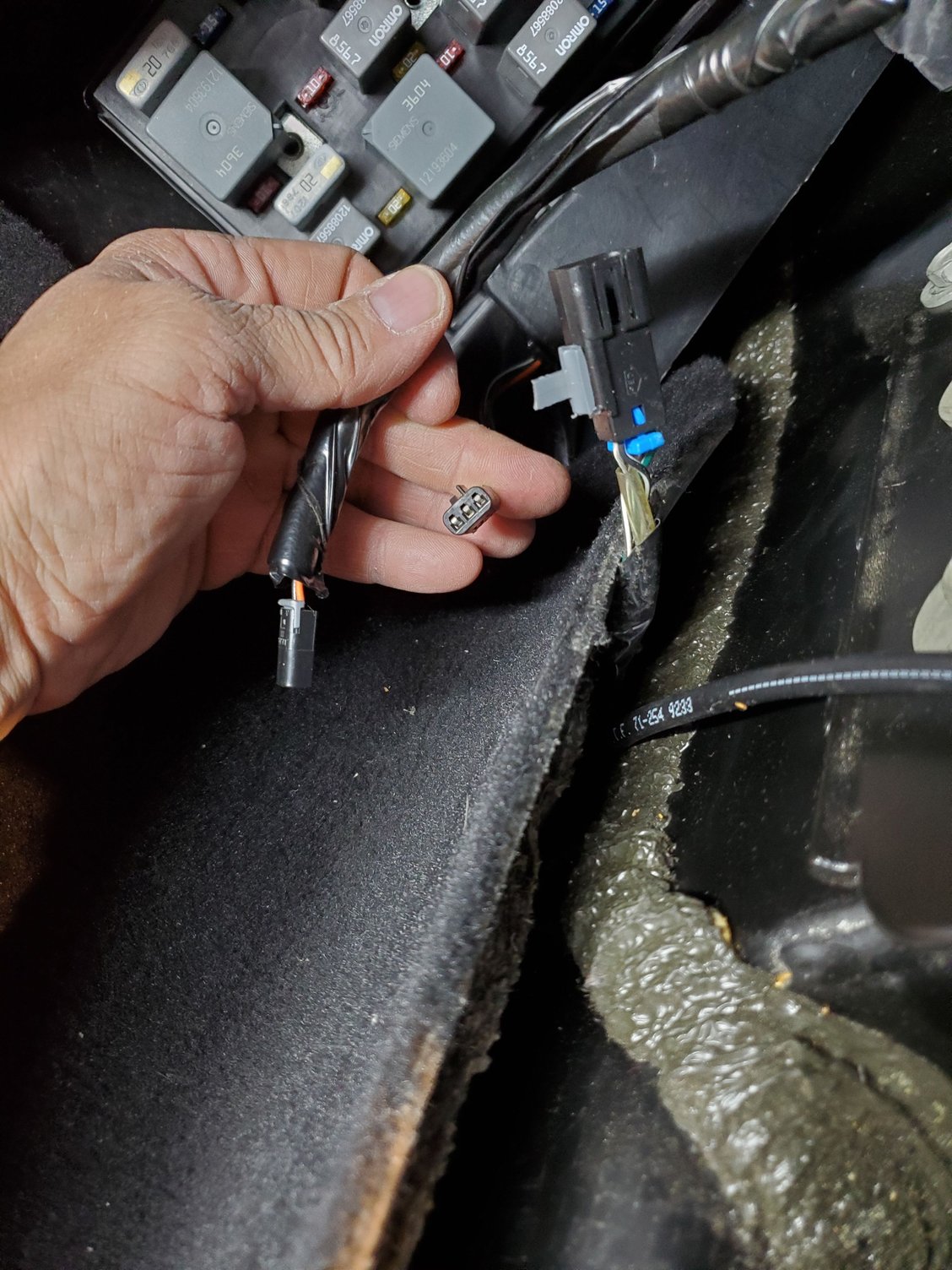

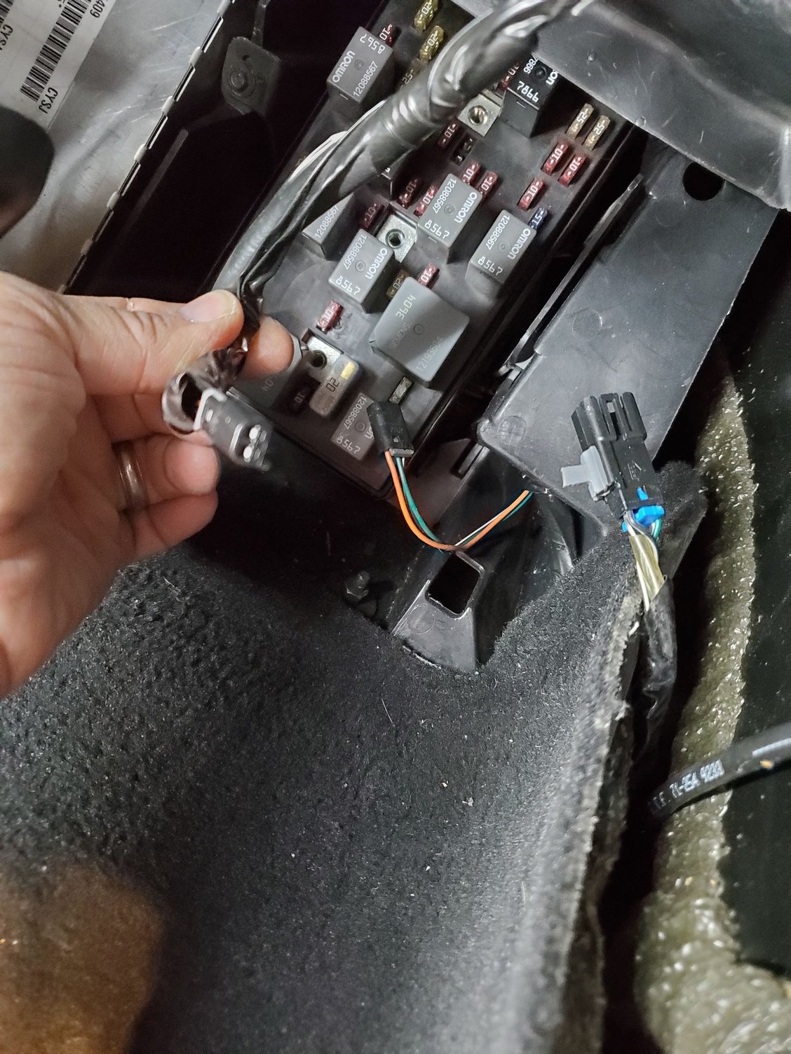

I went and pulled mine out for ya, 2 of the connections go to the cd player that would be in the back. The third I could not see. I cut and adapted the cable that normally went to the back so both connectors are up in front for the i pod adaptor. I attached a few photos.
Man, I was fighting to put the fuse panel cover back on, then realizing that the cover goes on with the lettering up side down. Hope I didn't mess anything up, I was really forcing it. I don't think the other would have to do with the window.

Thanks- -Thats what I thought! still haven't figured out what that third plug is for ...

I think they all might be for the harness, was trying to find i pic of the harness but couldn't find one. I installed it 15 years ago, iPod days, lol, and don't remember the details.
