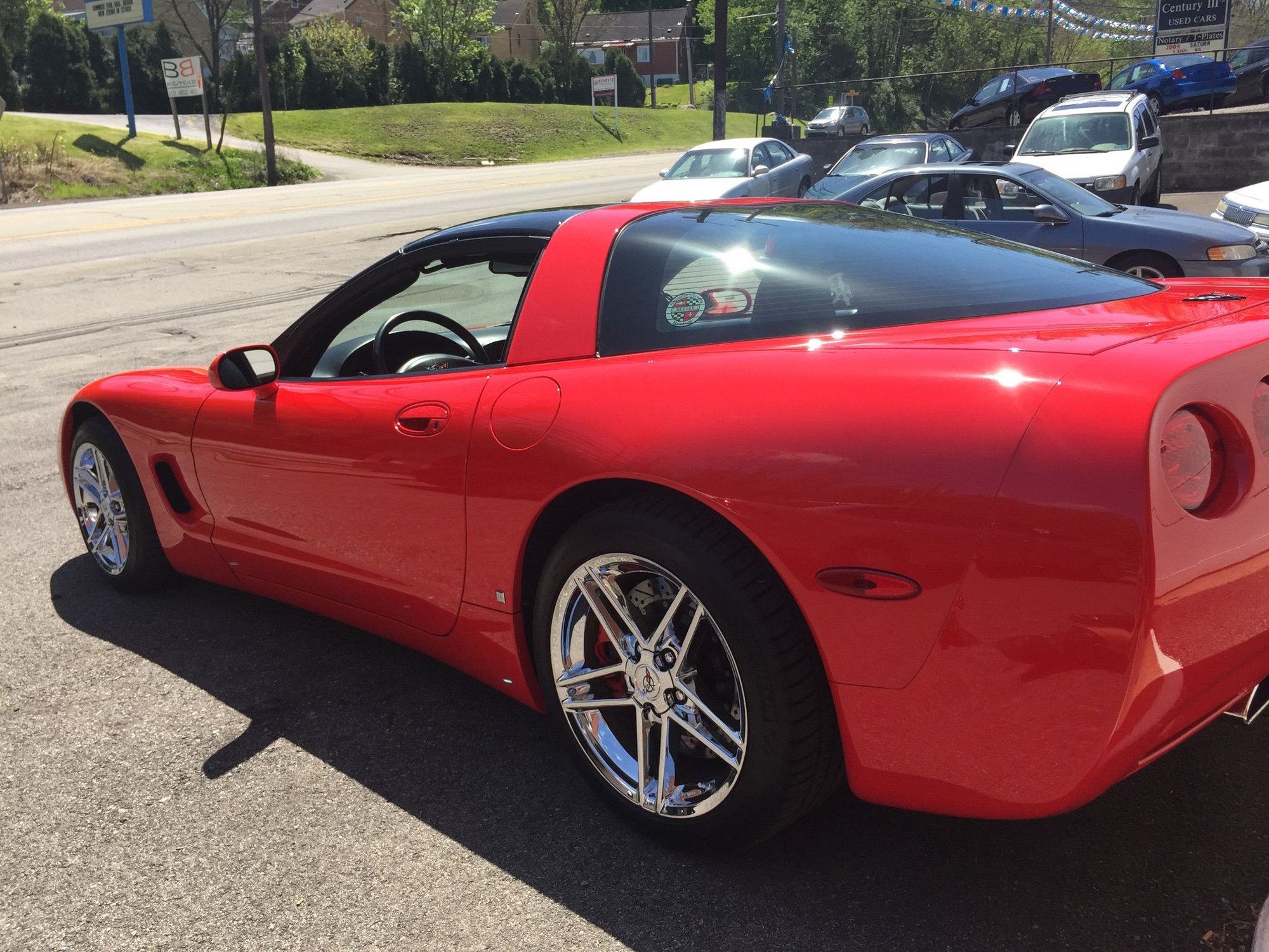

I’m running the stock coupe tire size on that size wheel. Have been for many years without a problem. Front & rear wheels are C5 Z06 sizes

You can clearly tell your tires are stretched - check TireRack for recommended fitments.

That’s BS. That tire is not stretched. That tire is seated perfectly on that wheel. That tires wheel protection is a good quarter of an inch out from the wheel. I’ve been running that combination for over 12 years. If it was stretched, what problems do you know of, does it create. Tell me please.

Looks stretched to me, anyways I don't know what size you're running, and I don't know the wheel widths that are recommended by it's manufacture...you have to look that up at TireRack, for your specific tire - it depends on the section width, combined with the aspect ratio, combined with the wheel diameter, it varies.
But here is an article that explains why you should not stretch or pinch a tire:
http://atturotires.blogspot.com/2016...eel-width.html

Well than I’m here to tell you don’t believe everything you read. Real world experience tells me after running two sets of Michelin ZP tires. Over a period of 12 years have created no such problems. It’s like the paper you get in your prescription that tell you all the things that might happen and never do. Thanks for the concern. The manufacturers are covering there asses.
