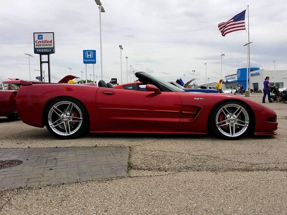

Thanks! I think the Magnetic Red looks nicer with some chrome or silver wheels. It makes the color pop. Considering this is mostly a weekend warrior and car show cruiser I think the 19/20 chrome fits the bill for me
Here is a pic of my Vette before the engine mods and side door spear removal Those are the rims I'm going to use.

The chrome wheels look great on your C5!
Thanks! I'm glad you did not call me out on my "Z06 505hp" badges although a while back, I got called out bad about it Funny thing now the car is way more than 505hp so the badges are really a laugh in a good way
