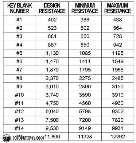

1. Search the forum for the VATS resistance chart.
2. Use an OHM meter to check the resistance on your key.
3. Buy correct key blank from forum vendor / ebay
4. Take key to local Homeland / hardware store to be cut to match

Agree with all but because the cutters in the Home Depot type establishments leave burrs because they are not kept sharp and with the sensitivity that the C5 ignition switch has , I would recommend taking the key to a Key Locksmith for cutting.

Locksmith measured the resistance to select the correct key blank
