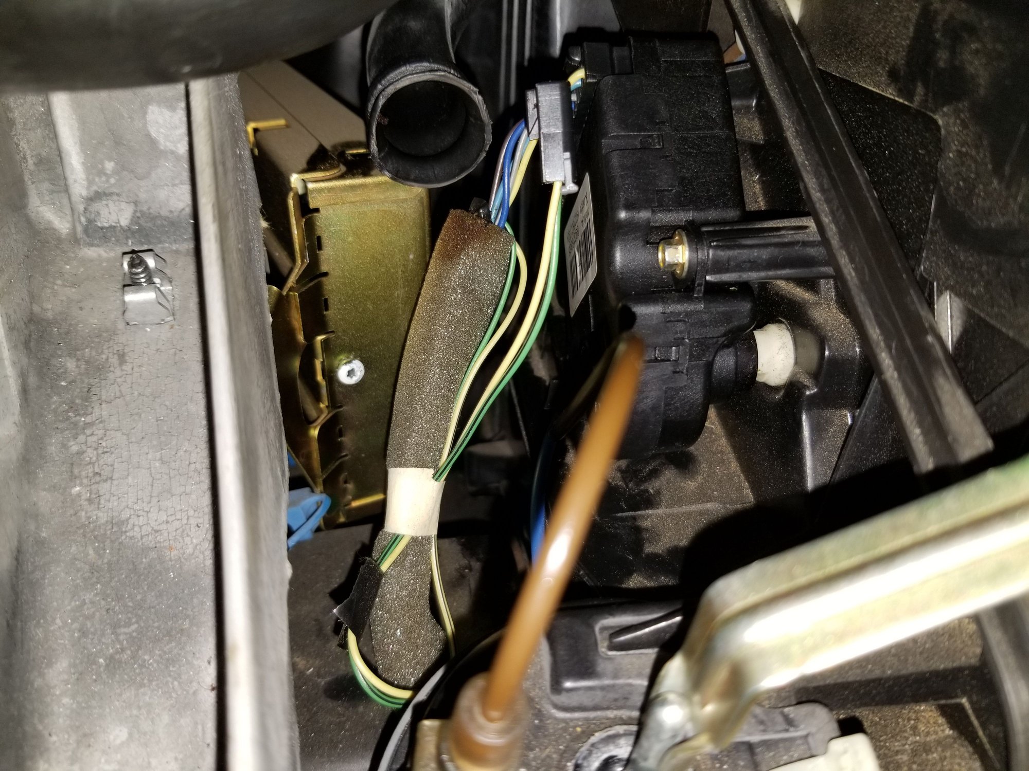

Just replaced my left side blend door actuator and don't remember dealing with the connector with the green and yellow wires. They each have a black stripe and are taped to the actuator wires. Thanks.

Those typically are for the Twilight Sentinel module. It turns on the headlights automatically when ambient light levels are low enough.
Not all cars got this option, but the wire harness was there for it. If it has this there would be a sensor on the drivers side of the defroster grate on the top of the dash.

I went back out and pulled the actuator connector and the way it is wrapped it looks like you say, the unused wiring for the Twilight Sentinel as there is none on the car. Thanks for the response.
