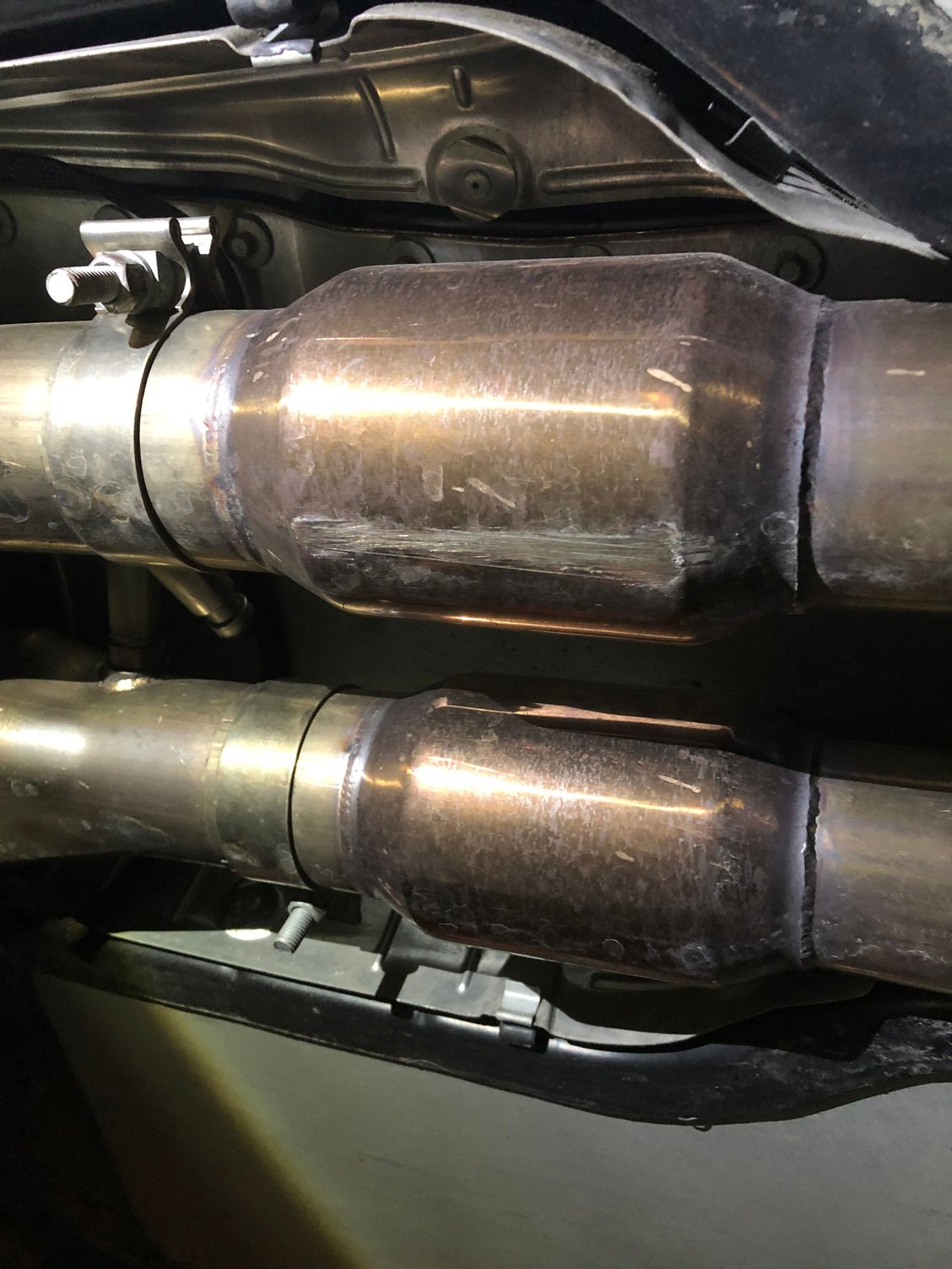

most likely those are high flow cats and should pass a visual inspection so as long as you don't have a cel and your readiness monitors are set you should be good... it depends on your state but in tx you are allowed 2 "not ready" on pre 01 cars and 01+ only one "not ready" and still pass

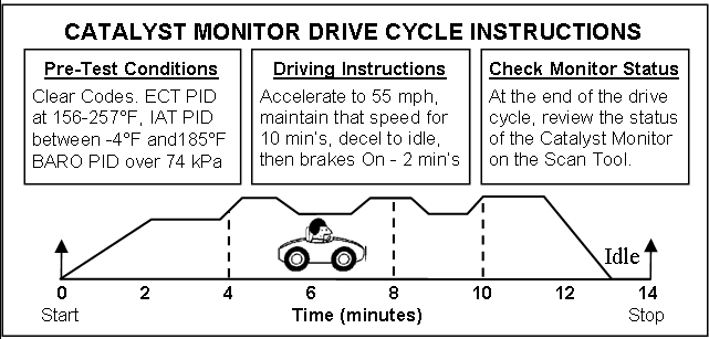

Here is the drive cycle needed to pass readiness for your cat.

Yeah I have attempted these drive cycles on numerous occasions and still see the not ready codes which is why I’m unsure if the high flow cats are being problematic.

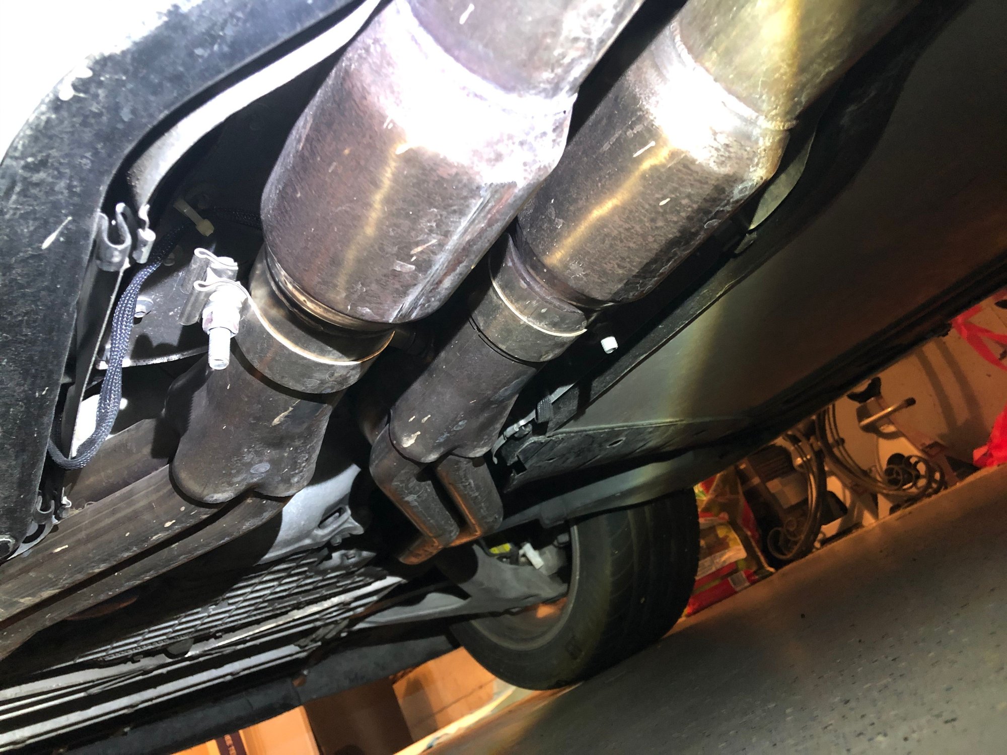

You can see the clips for the rear O2 sensor wires in your first pic and there are no wires going through them. If your check engine light is staying off without rear O2 sensors, I think it's safe to say someone tuned them out and that's why it never passes readiness. They probably did the same thing with the AIR pump.
So they did not do a good job on the tune. You can bring it to someone like east cost supercharging in plumstead. They can tell you what needs to be done. Your lucky they didn't fail you for visual inspection, you would have been really screwed.
