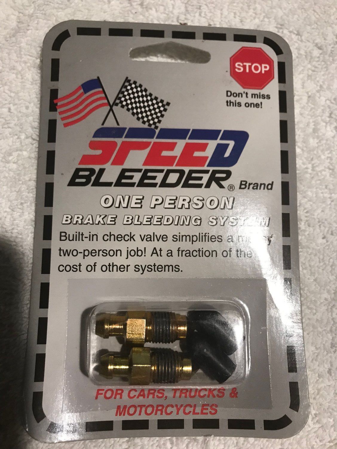

Speed bleeders and DOT 4 fluid.

Do you know the part # of the bleeders?

Russell #639630, I got mine from Summit
