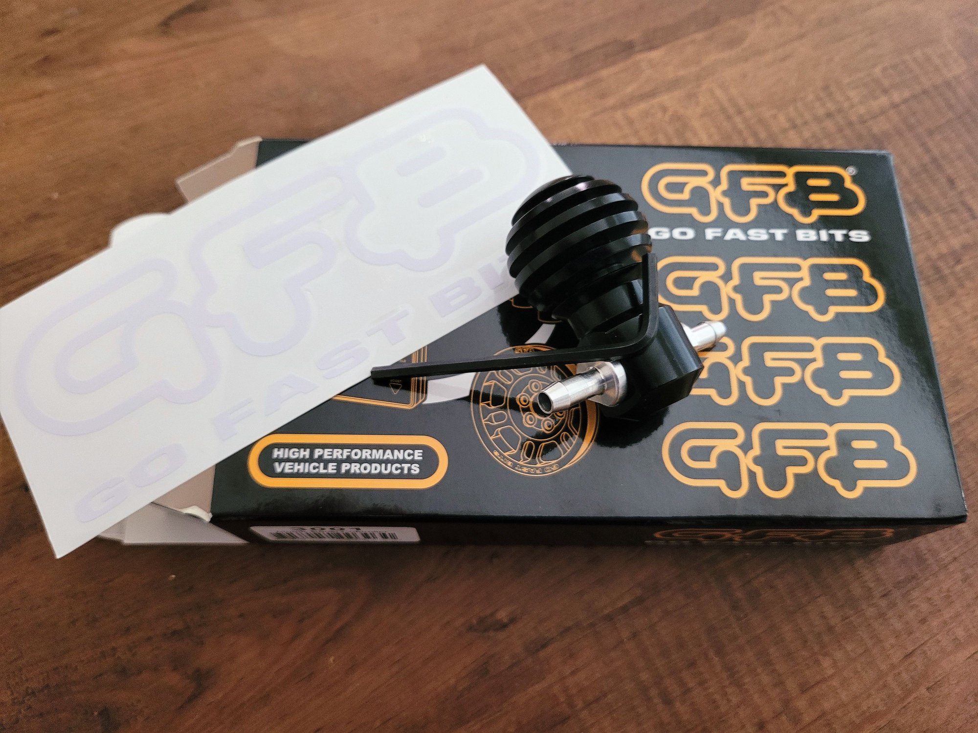

Got out in the garage and raised the rear of the car up an inch and it's now 28" from the ground to the center of the rear fender. It is much better now with no charge pipe scrapping/rubbing on the rear tires. GFB boost controller arrived today as well so looks like I have another mini project this week. I opted to go with this particular company due to price point, construction of the product, great reviews, and no boost spike from a variety of testers. But what I like the most is the design of how you have to turn up the boost. The allen key has to be inserted and then you turn the boost up or down. Not that it probably will ever happen, but this will at least help to minimize anyone from just turning the ****.

Never put it on the dyno so no idea what it's making. Boost doesn't hold steady and is intermittent at times. It will go from 6 psi down to 3 then up to 5, then down again throughout the powerband. In the rearmount corvette facebook group a few guys stated they had the same issue and it was resolved with bigger turbos. Regardless, the car is still a blast to drive.
