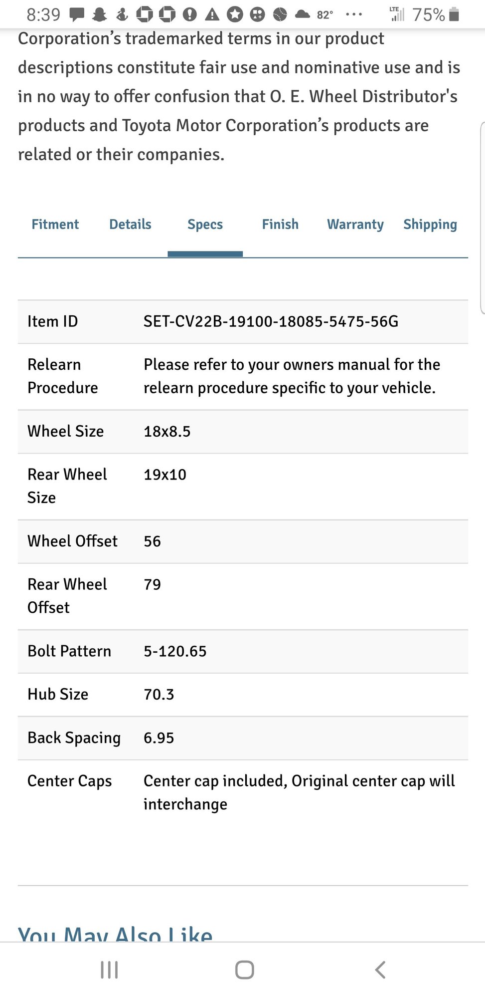

^ fronts look okay but I think the rear +79 will be too sunken in and may need a spacer...

Let me see if I can screenshot the specs and send them.

Those 18x8.5's with +56 offset would work fine but those 19x10's with +79 would need a 3/4" or 1" (my preference) spacer for best fit.
